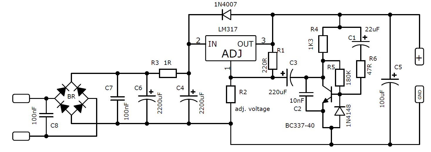

LDO's are a very different breed of cats regarding stability requirements, and there is no guarantee they are compatible with the X-noisers. At the very least, adaptations of the compensation would be required.

It would have to be tested, in sim first if a model is available, and then on a breadboard. It would be foolish to commit to a PCB without these precautions
"At the very least, adaptations of the compensation would be required."
Pay attention to Elvee's statement.
The filter capacitor in an LDO is in the feedback loop, and its value and ESR affect stability.
Many of the Analog Devices (and Linear Tech) Low Dropout Regulators have test fixtures in LTSpice. You can test for stability by this method:

Hello,
I was thinking of doing this version. What do you think?
