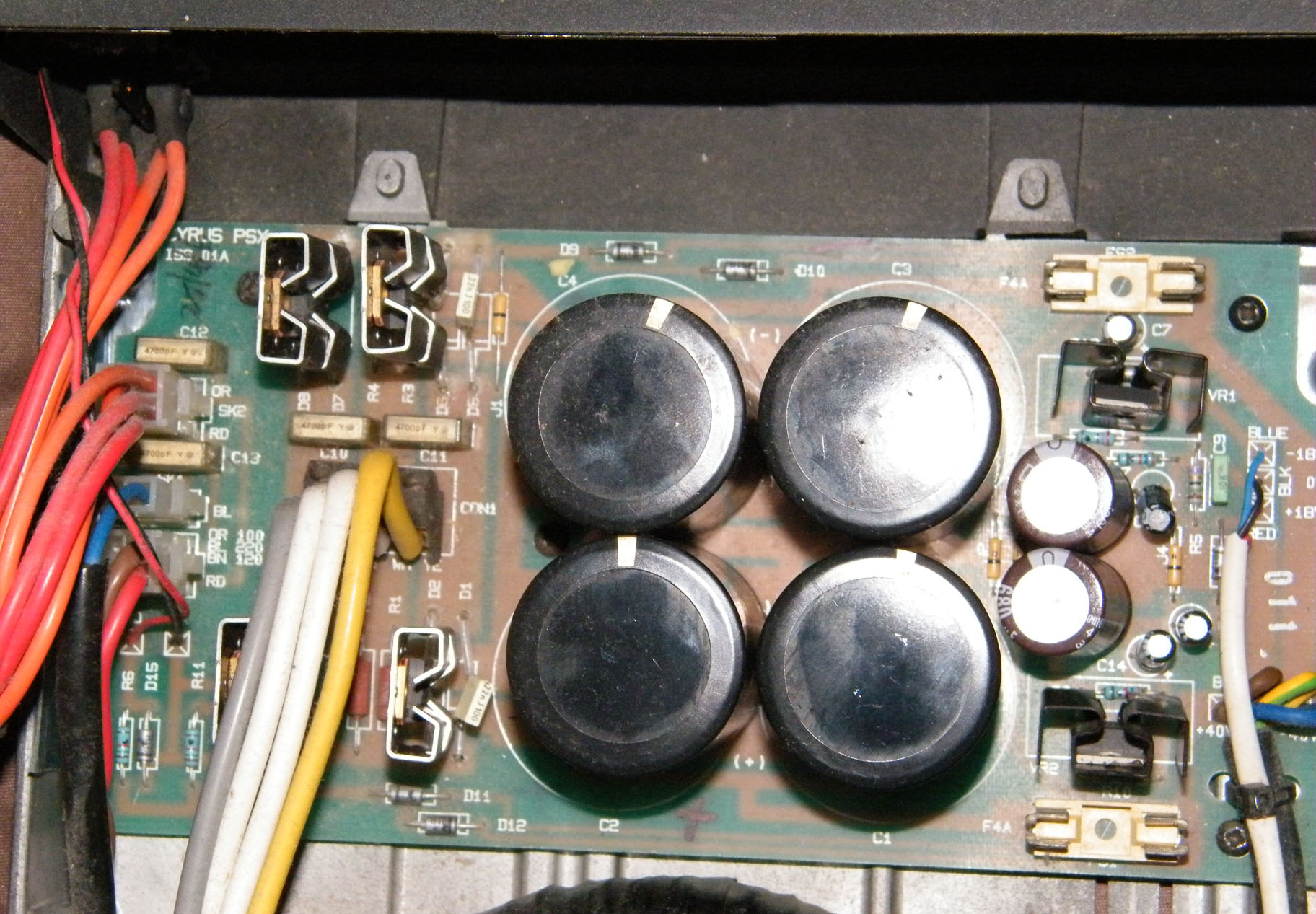

HI there,
after having restored my beloved Cyrus II succesfully, I want to go for servicing my PSX unit which I acquired some month ago. It is the toggle switch version with the Holden&Fisher toroid and Slit-Foil caps. The PCB is missing the diode D16 . Anybody got an idea which value to solder in here? Is this diode needed here or not? I have the Cyrus 1/2 service manual, is there a PSX service manual existing as well?
Thanks in advance for any input here!

Hi Sonusthree,
Below D16 is an resisitor R11. As already stated the diode is missing here... Any clue?
I have no clue! I have checked again and my PSX has no D16.
What is it's function? That will help you determine what is missing. Is it part of the same LED circuit as D15?

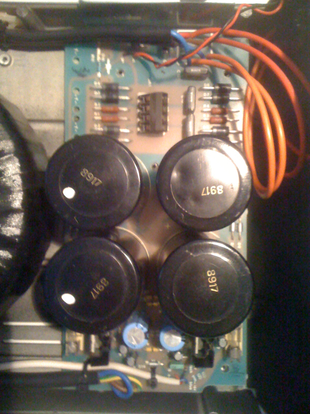

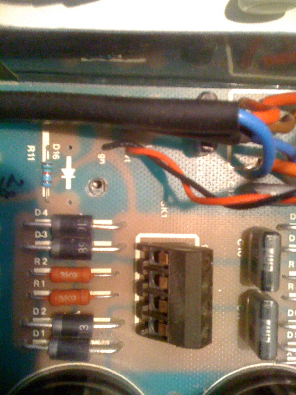

Hi Sonsthree, thanks a lot for the hint!
OK, here some pics:

Hope that helps!
Best regards
Rad

Have you looked under the board to see if anything was ever soldered there?
I'm guessing it was never installed and that my board is a later revision. Look under the board at the solder pads and you should be able to tell.
Did you look for solder or evidence of de-soldering?

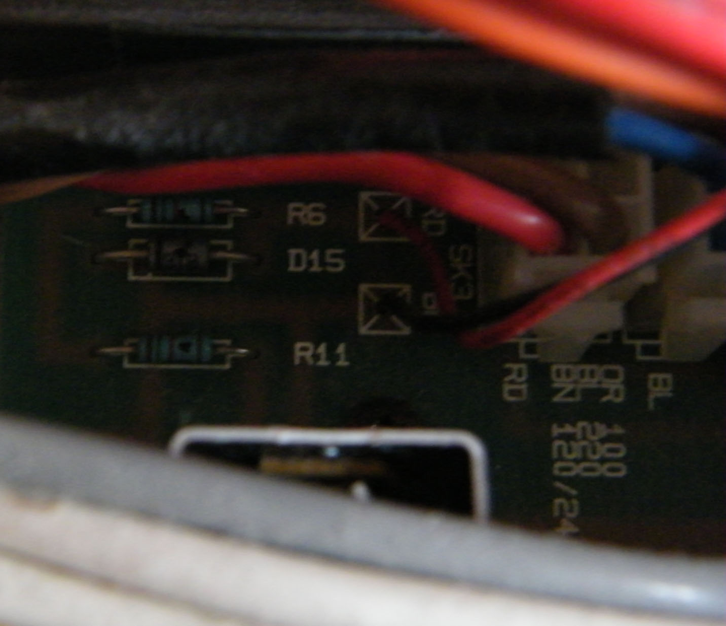

Hello, sorry for my English, I'm from Russia.
Understand that the topic is old, can you have a photo where the wire does not close the D15, R6. I got the PSX which everything is burned or if it is possible ratings D15, R6, R11
