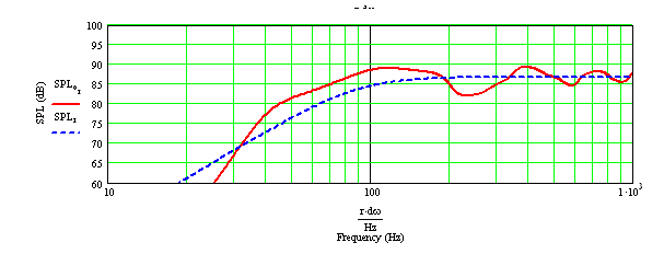

Henkjan, what software are you using for your simulations?
I would have exected that Dan Archer should have the Alpair6s in by now...
As I write this, I just paused from some measurements on the Alpair6 in the Needle... I have notch that at least measures fairly well, so after some more finetuning I'll hook up the other speaker and listen....
for simulations I use MJK's mathcad sheets.
notch filters I don't simulate, I just measure with a box full of caps&coils available...

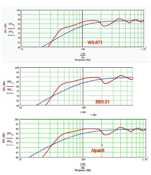

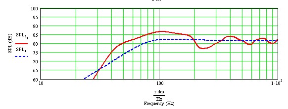

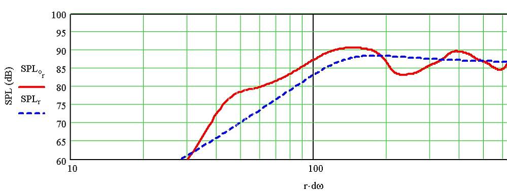

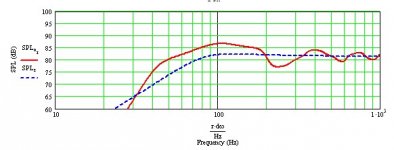

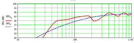

thank you very much for this, henkjan, it is extremely useful.
i have combined all 4 graphs into one:
from top to bottom, they are:
1) alpair6
2) bb3.01
3) w3-871
4) w3-1285 / hivi b3s
it appears that a driver change is definitely in order, especially when only the b3s and alpair6 are shown:

thank you for the extra graphs!
there are now too many to show on one graph, but it is still clear that the alpair6 is the best choice. frs8 and b3s really seem like horrible choices!
unfortunately i cannot find an australian source for bb3.01 or 119/8... so it seems the alpair6 is the clear winner here as soon as dan gets some in stock.
