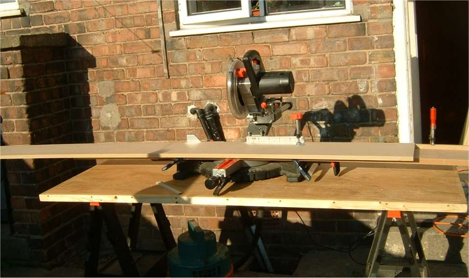

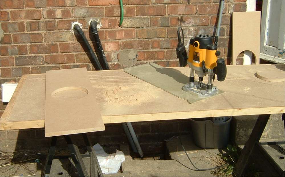

How to build a Curvey Chang in a few easy steps!

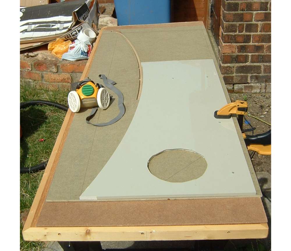

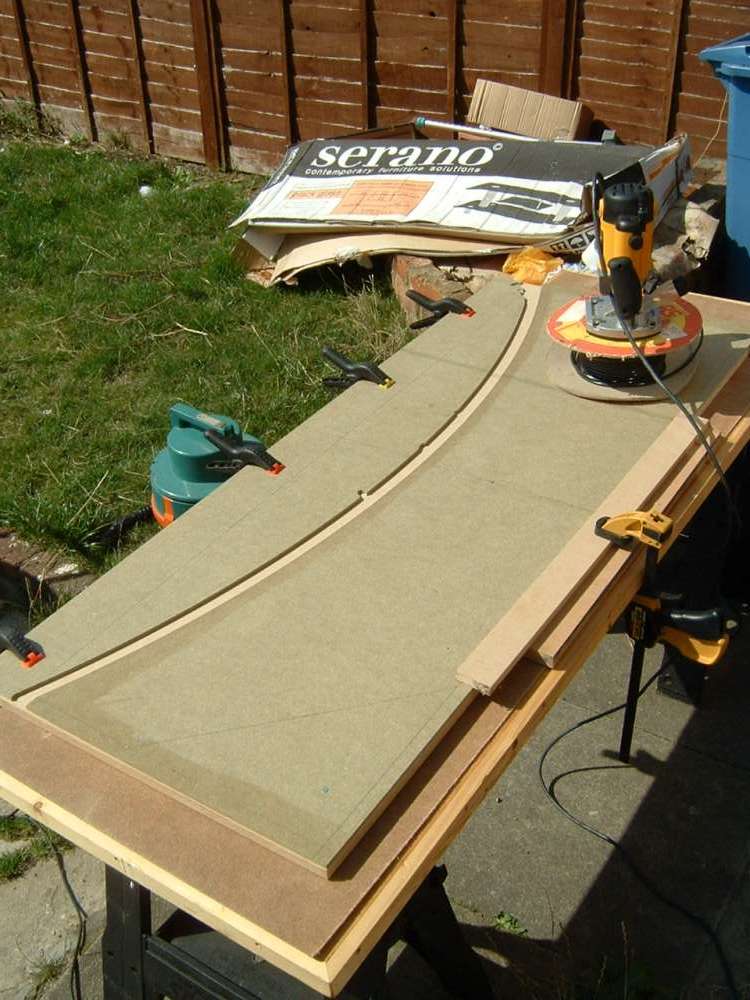

1. Make a template, as the CNC machine I play with can only do 500x700 made the base template as large as poss then made a working template out of water resistant MDF. Template sized for a guide bush and router bit that gives an extra 5mm.
Cutting holes in baffle. The router compass is made out of the off cut for the template.
For the rear mounted tweeter I used a 40mm hole saw, used a large round over router bit to get external flare, and a coveing bit to get clearance on inside, then used wood repair as stated above to get tight fit.

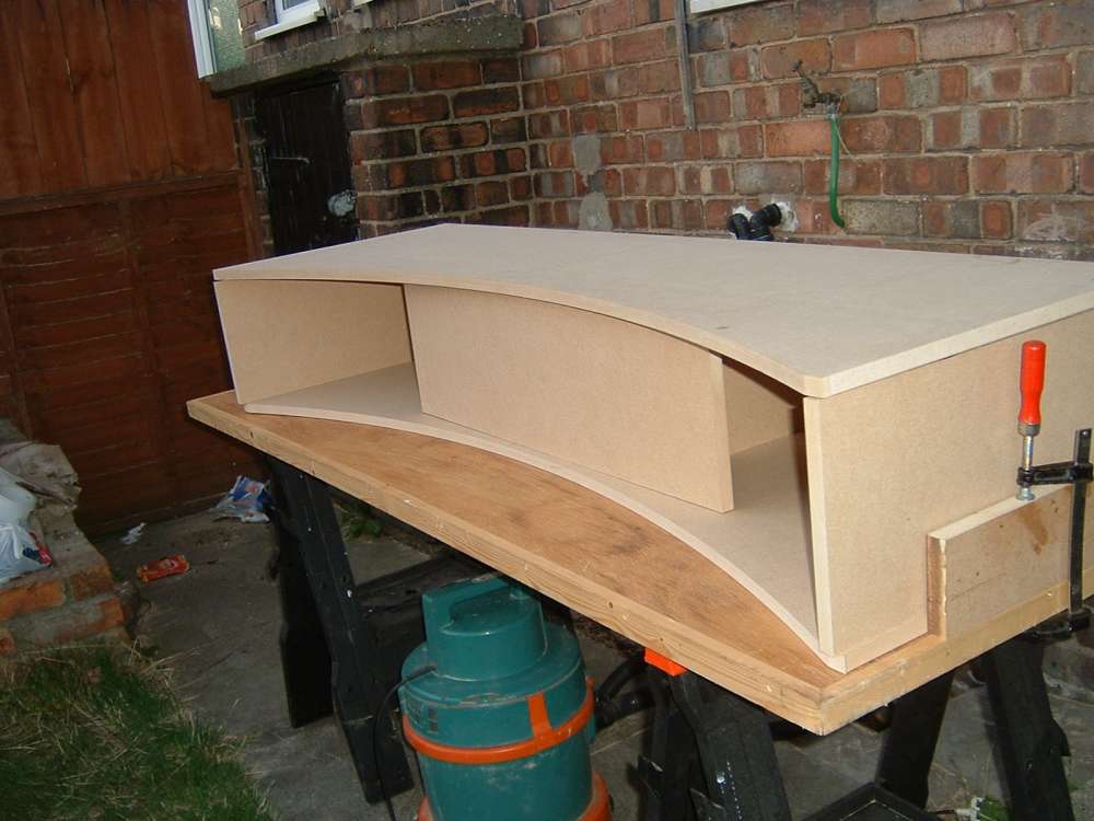

The only awkward part of the build is the curved front, and with the template it was a doddle. So far its been easier the my 1st buid (FE166's).
Lunch hour over, will document more later.

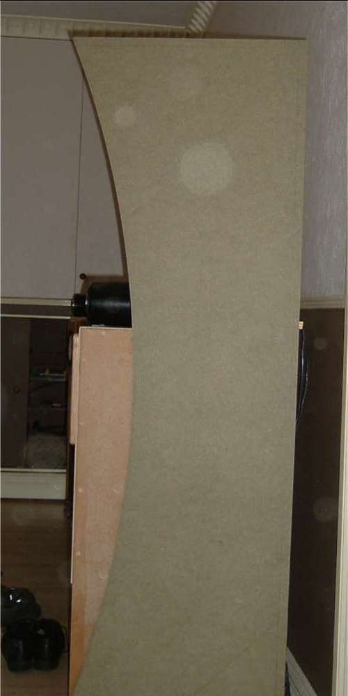

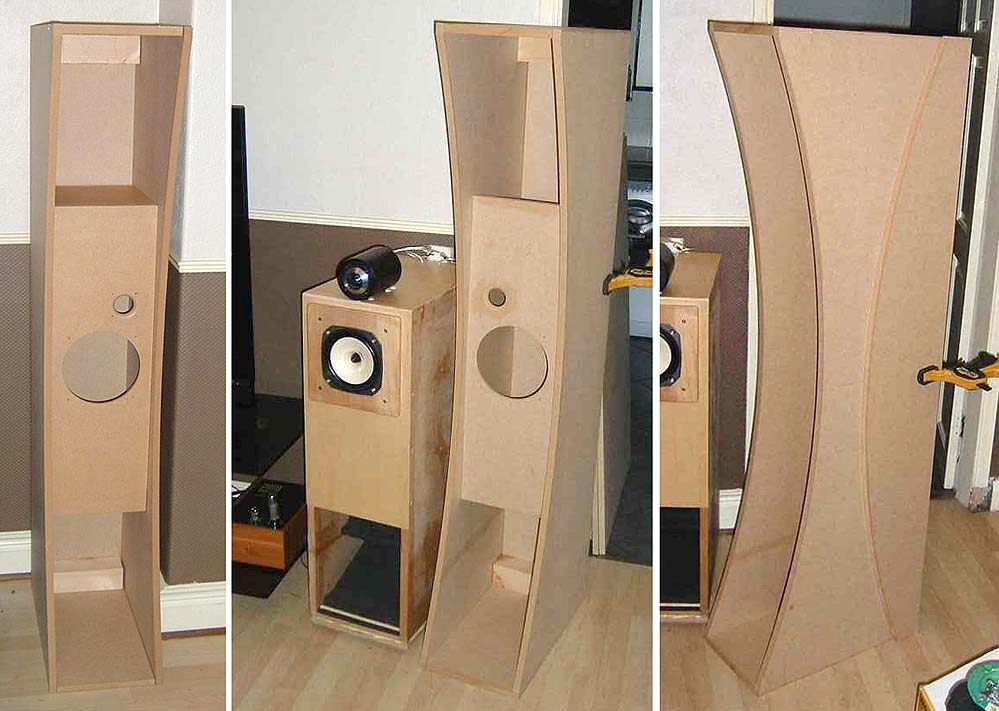

On the CC front, got both of them dry assembled and stood in the living room. They look quite imposing. Hopefully going to start final assembly this weekend, and start finishing them.

I'm going to finish them all in black, as I forgot to calculate the thickness of veneer and glue when doing my template and would like some subtle design or nameplate.
Though if tolereances allow, I would like to veneer the front, this would take just over 1mm (approx 0.004") from the curve front to the driver. Dont know haw critical this dimension is, again any advice would be greatly appreciated.
marce said:just over 1mm (approx 0.004") from the curve front to the driver. Dont know haw critical this dimension is
Certainly not anywhere near that.
