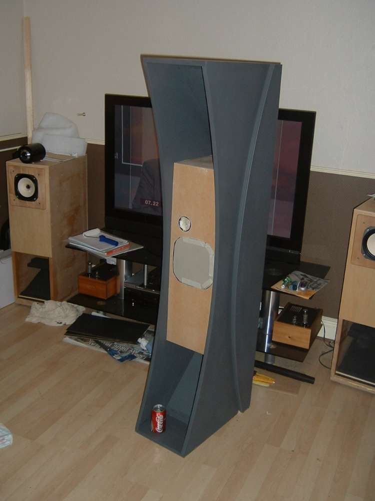

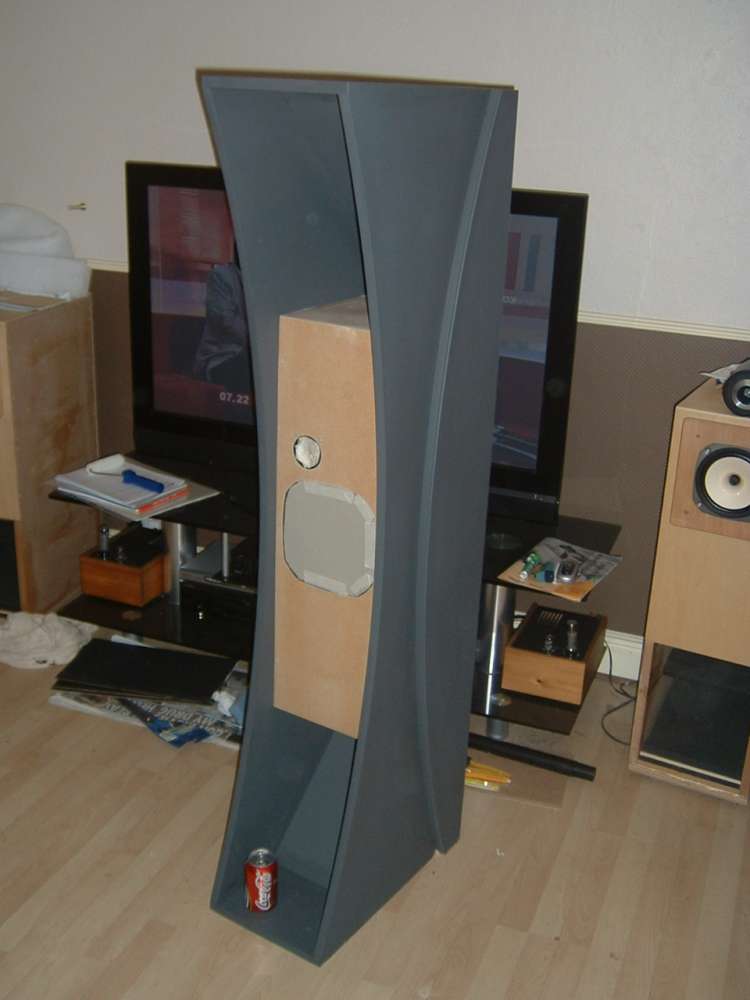

A quick treat before a few more details on the build, a beautiful weekend here in Scarborough so I had time to work, got one fully sanded and the first layer of undercoat, and the other glued and partly sanded. There is a lot of area to paint, but now I can realy see the finished item, hopefuly similar to one of my first renderings, it not labour anymore.

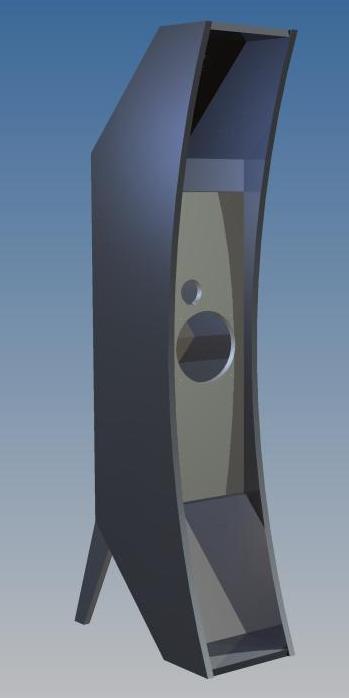

OxMike, having the rendering tools etc is a great help, before I had to print out the drawings and colour them in using felt tips, or watercolours, its nice to have an image of what you want to achieve, helps keeps me focused.
Forgot, there's a can of coke for reference.

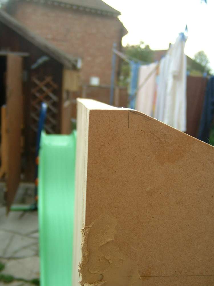

Some quick boring bits, but important for a beastie this size.
When I did the top and bottom of the curves I deliberatly left some bumps, ie not a clean transision to the top. I did this to avoid these corners getting damaged during the build as these are the only points of contact when working on the rear of the cabinet. Once everything was put together I tidied up the corners
to get a pleasing end to the curve.

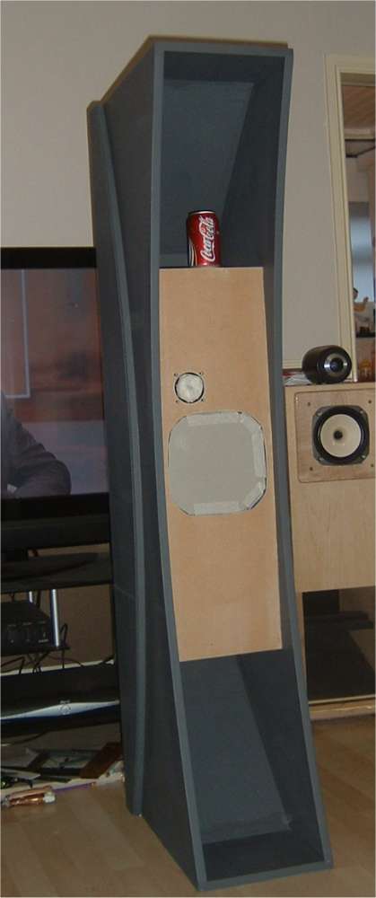

The speakers are std Fostex BHL with FE166's, the TV stand is 1.5m wide and the TV is a 50". In the grey undercoat they look rather gothic.
