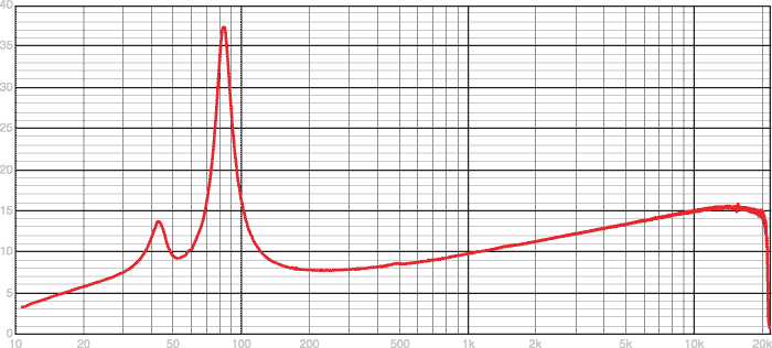

Before i publish the offical miniOnken, i want to let the driver break-in and see if it needs any tweaking, For instance the impedance curve shows a tiny little wiggle at just under 500 Hz... could be a cabinet resonance or something to do with the ports, the perfectionist would like to kill that -- althou i must say that i was caught off guard when a measurement run today detected a DVD & a CD sitting on top.
It has started out at 13 litres net (driver consumes 0.28 litres), tuned to 52 Hz. Impedance curves i have rau show the same tuning (2 days apart and they haven't moved), so we have an F3 in the neighborhood os the tuning. The curves (as i interperet them -- i'm no BR expert mind you -- support my intention of getting it to be semi-aperiodic so F3 might be a bit higher but with a better F10 and lower group delay. Whatever i did it sounds good, and you usually don't hear me saying that about a BR. I sorta designed this one as a lark because i really liked the looks of the Solo 103, and it came an bit me in the bum.
Perhaps someone with more experience reading BR charts can comment on the tuning.

WRT to the mini-Onken's impedance plot, the lower 'bump' should be almost non-existant and the upper one should be somewhat more 'blunted' for it to be ~aperiodic. This will require critically damping the vents, yielding an FR response similar to the Alpha TL except with a bit more midbass. That, or redesigning the cab with a much lower 'n' factor to raise F3, like maybe 2.5-3.0, but then the cab becomes tiny and the vent length goes up dramatically, so might as well just do a simple reverse tapered pipe stuffed to suit and be done with it.
