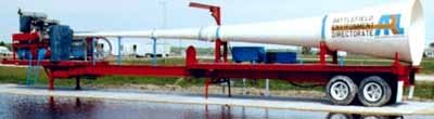

Now Fredos, the loudspeaker company you talk about in:
http://www.diyaudio.com/forums/showthread.php?postid=1017355#post1017355
it is also not modest in their proclaims .
At least they use your method for assert the fantastic power/efficiency.
106dB-1W-1m for a bass-reflex dual loudspeaker box is a Guinness World Record! :bigeyes:
Ouch..! 143.8 dB max Spl...:tons: is it continuous or just 1uS burst?
The nearest thing i know is the one on the photo!
My humble technical advice with such loudspeaker efficiencies is that you must install yours lowest powerful amplifiers!
The 12K HVI is clearly not necessary as it will work at low power levels….
:idea: Wau!!! I have the entire picture now! That way the amplifiers never heat and will leave forever!...
