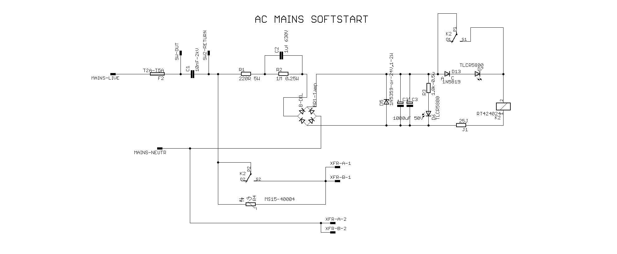

something like this for softstart (circuit was designed by UK member based on diya softstart).

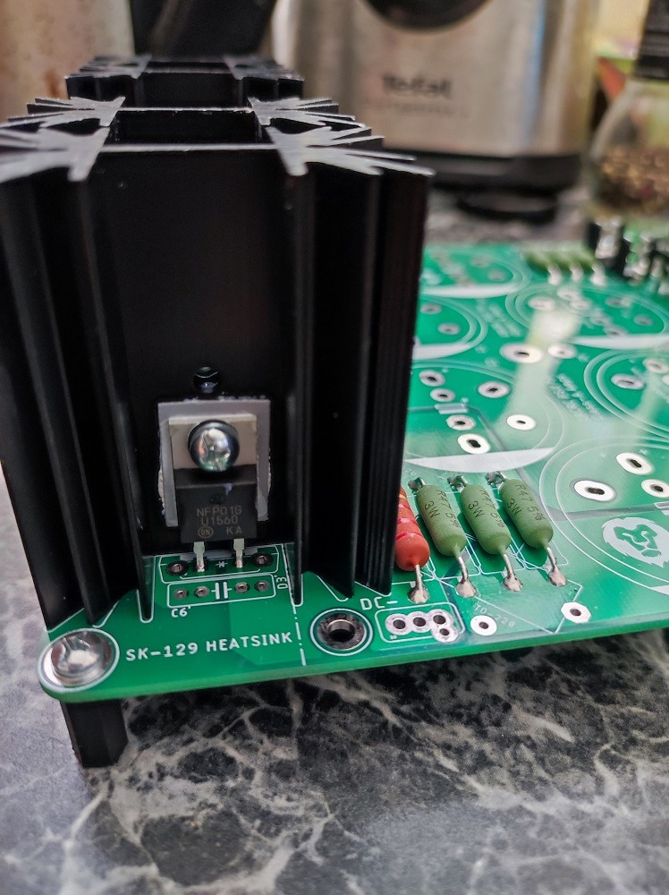

Are the diode bypass caps necessary when using MUR860? I am thinking no
Does anyone have a part number for the heatsinks that would work with the TO-220 MUR860 rectifier diodes?
I also kind of wonder if I need heatsinks for this supply as it is only drawing 100mA (phono PSU).
This will be too big a crc psu for 100mA. you can design something smaller with regulators. i have a to-220 rectifiers + crc+lm317/337 psu pcb if you need it, quite small.

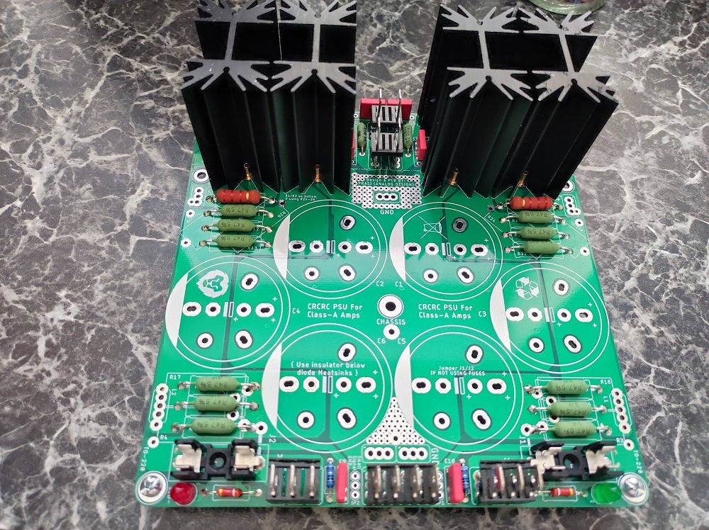

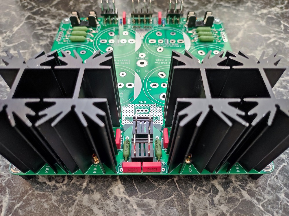

Hi all,
I have the CRCRC almost done, but I can't decide what size filter capacitors to buy.
6x 10 000 uF
6x 15000 uF
6x 18000 uF
6x 22000 uF
I will power one board with 2pcs JAT501 (100W/ 4ohm). I will use 400W toroidal transformer, common for both channels
Thx.
