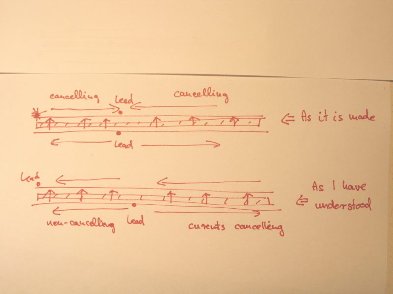

Joseph K said:
So, the leads are NOT displaced by all the length necessary to reach that diameter - instead they are displaced only by the ~ space between the leads! [exactly the length of the half circumference of a roll with the lead space diameter]
[This all because the first lead is not connected to one end of the foil - but are connected with only that sligth shift - so the solenoidal currents are almost totally symmetrical for the ~full foil length, and so they cancel]
In the sketch I have signalled with only one line the full cap sandwitch structure - foil - dielectric - foil. I think this way it can be seen better.
Notice that in this way each of the leads are touching from a different side. One more thing is necessary: the opposite side foils should be displaced [shifted along the dielectric] by this small length described above.
So the resulting stray inductance is equal to this half - circumference, that is, ~ the lead distance. This is why the catalogs mention that ESL is ~ equal to the distance covered by the leads!
Ciao, George

Wait a minute, John!
Do not misunderstand me - I still think that Your explanation was perfectly logical, and - at least up to now - I was convinced of having understood it well [~]. What I wanted to say, is that I was disturbed by the fact that I was not able to measure the effect of it. [At least not in a due amount]. Though, the capacitor inspected by me seemed to be made exactly as You described. At least this was my claim.
Now, my post above just wanted to clarify, that the capacitor inspected by me - in a SuperFicial Way!! - was NOT made according to Your description, but includes an another little trick, which effectively reduces that effect described by You - to a much smaller level.
I think that Your description was appealing, and valid.
I don't think that You should be aware of all the actual little tricks applied by the manufacturers. So I did not mean to blame it on You!
I was actually correcting myself, I should have noticed that difference right at that time.
And for me, physics, Your description & reality are much closer now!
Here it is a short ugly sketch again to clarify it further: [or confuse, I don't know now..]
Your sketch is very good and correct.. Thank you for making it.
When you have made the srf as low as you can, then we will have an inductance to put on the graph I made. That will allow us to determine in a model, how much of the volume of the capacitor is carrying the current. Clearly it is not the wire diameter, and clearly it is not the capacitor outer diameter. While the effective current diameter will be somewhat geometry construction related, the information will allow us to make closer guesses for what the resultant inductance would be for different capacitors.
