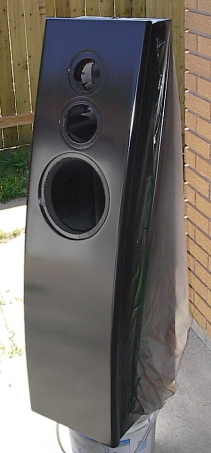

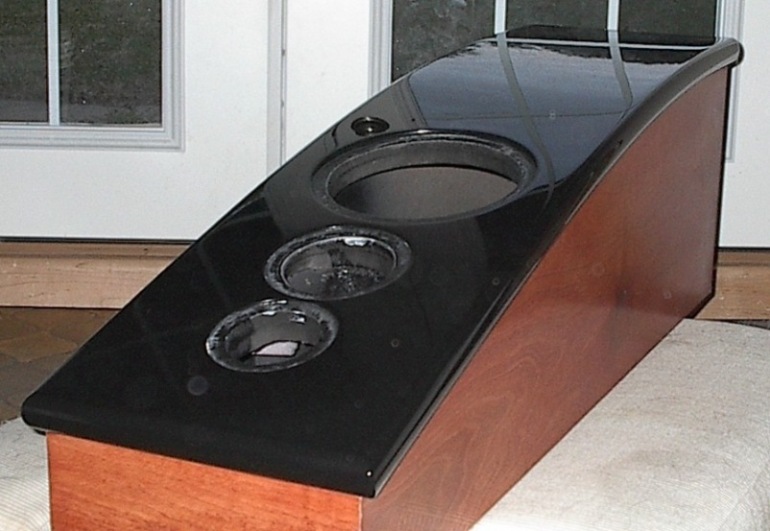

These waterbased finishes dry so fast. The next day I start to colour-sand the baffles. (for those of you that don't know what "colour-sanding" is, it's wet sanding the surface of the paint with very fine sandpaper to make it super smooth, ready to be polished).
It's very hard, even after just a day. Sanding to get rid of the "orange peel" takes quite a while. I'm beginning to believe that it would probably be best to sand this finish as soon as it's dry, like within a couple hours.
I do a quick pass with the buffer, just to see how easy it will be to polish. What I see makes me a little concerned. The clear coat has gone slightly cloudy in sections (not sure why, but I have a few ideas). Also, the parts where the clear was clear, you could see the texture of the previously sprayed black underneath(orange peel, specks of dust).
I can see that the only remedy is to repaint yet again, this time using just the black waterbased urethane paint, and not the clear on top.
Sand the baffles with 320 paper, clean them up and mask out the body. Thin the black with as much as 40% water to get it the proper viscosity for spraying. This gives me 1 litre of paint for both baffles.
This amount of paint gives me 7 coats on each baffle. It takes less than a hour to spray both. It's a nice day, so I leave them out for a hour to dry.
Putting my previous experience to work, I decide to colour-sand only 2 hours after spraying on the last coat. Although waterbased, water will not dissolve this paint after it has dried. It's original purpose is for painting concrete floors in high traffic areas and damp locations. It's tough stuff.
Anyhow, it's a bit easier to sand and I get that done on both baffles. I was going to wait a day before polishing, but once again decided to push my luck.
Nothing to worry about, polished beautifully. Amazing, this is an entire process that would take as much as a month to do with solvent based paint, is done in a few hours with waterbased paint. And from what I can tell, the waterbased is a lot harder.
Closing in on dark outside when I finished, so couldn't get a decent picture (with my camera, the only good pics are ones taken outdoors).
Here's one I had just finished polishing, laying on a cushion on the floor. As usual, white spot are from my camera, not on the speaker.

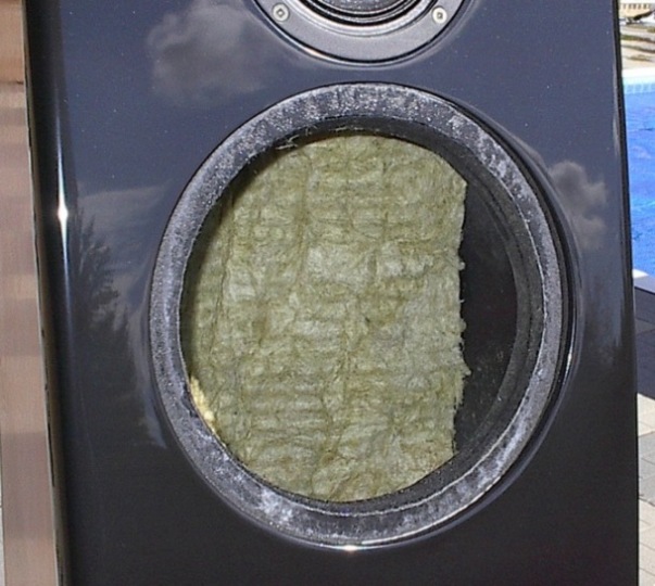

Originally, I planned to use a moderate amount of stuffing in the woofer chamber, as the frequency response here is limited to 310Hz and lower. For 2-way speakers, I have had a dislike for total stuffing for a sealed box, in that it sounds to me as though the lower midrange and high bass are muffled, dead. For those, I liked a carpet lined box rather than a stuffed one, but driver response for 2-ways in most cases would be in the 2000Hz to 2500Hz range. Here, the woofer is not working as high.
For these, I have a different idea. I have on hand some 4 inch thick "rockwool". I used it for sound deadening in the ceiling of my basement (dang kids make a racket ), so I had some leftover. I thought I'd cut pieces the same width as the inside of the box, and place them in the middle between front and back, thereby cutting the space in two. Worth a try I think.
Here it is put in, leaving about 4 inches space in the front. 3inches at the bottom in the back, next to none at the top.

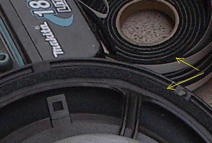

Installing the drivers is a bit of a nerve racking experience, demanding care with screws, screwdrivers and the speakers themselves, not to scratch the hard-gotten finish. Luckily, the Gods are on my side this time and all goes smooth.
I take the time to countersink all of the screw holes in the mounting flanges of the drivers. I like the screws to sit flush with the surface. It also looks more professional IMO.
Bit of a tip for gasketing for the drivers. The ones that come with the driver (if any) are useless. I use open celled weatherstripping, the self adhesive kind. Bought at the hardware store (cheap), I get one that's about 3/8 inch wide by 1/8 inch thick. I then cut it down the middle to get pieces that are 3/16 " wide. This I stick to the back of the driver flange to make a beautiful seal.
Here's a pic showing what I mean. Arrows point to the roll of weatherstrip and the back of the woofer that I've put it on:
MJL21193 said:I use open celled weatherstripping, the self adhesive kind. Bought at the hardware store (cheap), I get one that's about 3/8 inch wide by 1/8 inch thick. I then cut it down the middle to get pieces that are 3/16 " wide. This I stick to the back of the driver flange to make a beautiful seal.

I do take a small fraction of pleasure pointing out peoples errors because it makes me feel a little better about the hugh number that I make. So...
You want closed cell types ideally. Open cell = breatheable, closed cell = air tight.
Probably not an issue once in compression but if your gonna do it right and all that.
ShinOBIWAN said:You want closed cell types ideally. Open cell = breatheable, closed cell = air tight.
The black stuff he is using is closed cel (ay least the stuff you get at Home Despot). I've been using it for decades. Do note that some of the gaskets you get (ie the old Kef ones, and the ones that come with the Fostex drivers for example) are just fine.
dave
I was going by this:
Why, thank you Ant Now, you are being too modest - you don't make any mistakes
You are probably right Dave, though I got this at Canadian Tire. Open, closed, it makes a hellofa seal.
Any thoughts on my stuffing idea for the woofer chamber?

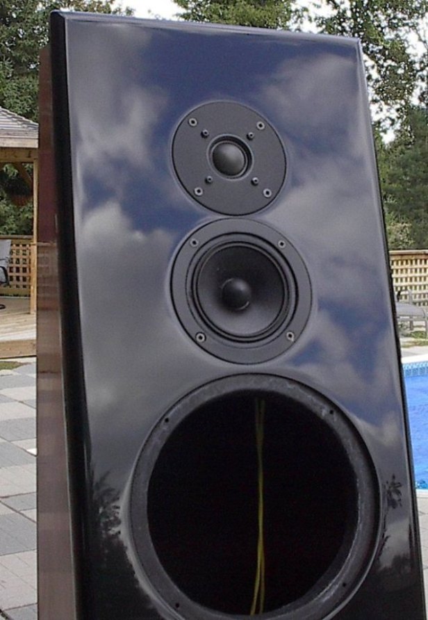

Throw in another pic for good measure. Tweeter and mid installed (with black open/closed weatherstrip for gaskets:
MJL21193 said:Any thoughts on my stuffing idea for the woofer chamber?
rockwool -- what they used in dynacos. It works.
dave
Thanks Dave, though I specifically meant the arrangement (4" thick piece down the middle).
Lots of different lessons learned on this build, from the placement of the divider, to the smashed up corner. I need to learn to take nothing for granted, spend a little more time planning to ensure things go well.
An example: to run the wires for the tweeter and midrange, I needed to drill holes through the divider. I would have liked to have the wires at the back of the chamber. One problem: I can't fit my drill into the woofer opening. I needed to drill upwards, on an angle, near the front of the speaker to make the holes. Could have been so much easier to do before the front was put on.

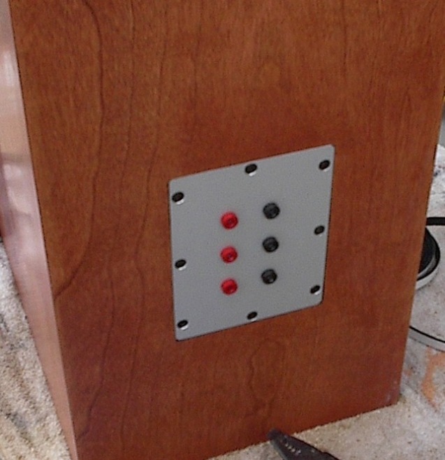

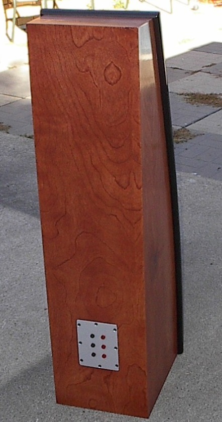

One of the things I did plan was the connection plate. I got my hands an some 3/16" aluminum that I cut into 4"x5.5" pieces to mount the banana jacks on. This mounting plate was really the only decent way to do it and it worked out very well.
Routed a recess in the back panel for the plate to sit flush.
All wired up, weatherstrip gasket in place (see how easy it is to form it into such complex shapes). The cap is an 11uF for tweeter protection. I could have put it here or the amp. Best to go here, that way if the cables get switched, my tweeter doesn't blow up.
MJL21193 said:though I specifically meant the arrangement (4" thick piece down the middle). ]
Well the middle is certainly the most effective place for it. And being in the woof part of the box, its reflectrive nature at HF shouldn't be an issue.

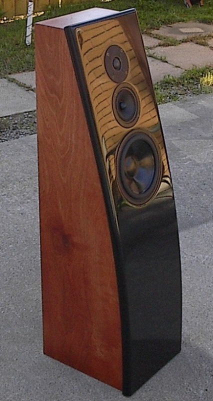

I now have these speakers fully assembled. The only thing lacking are appropriate spikes.
Overall, these represent some of the best work I've ever done. I am quite proud of the final result.

What was that you said? Another picture? Sure, no problem. This is the installed connection plate. Need to get some dry transfer letters to label the bananas.
Very Very nice speakers.
I agree with your earlier view, when listening to music I dont see the speakers, the other 80% of the time there a piece of not unsubstancial furniture.

The plate for the binding posts looks very professional.
