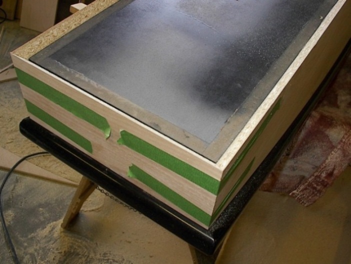

So, I start to clad the body of the speaker with 1/2" maple veneer particleboard. This will be the outside layer of the CLD system. It's also for appearance, ultimately it will be stained and finished with waterbased polyurethane.
It's a little tricky: first I have to leave space between layers for the silicone caulking that will be the lossy layer/adhesive.
Second, the side panels have to be carefully scribed to the curved baffle.
Third, is that I want there to be no end grain of the particleboard showing, therefore all joints are mitred.
These three factors make for some very precise cutting. I put a freshly sharpened blade in the tablesaw and have at it.
It takes exactly 1 full sheet to clad these speakers. Careful cutting and re-cutting, I get the first side fitted. Lots of silicone, and moderate clamp pressure to hold it in place.
I need to wait for the silicone to set before fitting the next piece. That's what this projects all about - waiting.

Cloth Ears said:how did you attach the front (second) sheet to MDF to the baffle?
I've tried using rubberized asphalt (the stuff you get in a can to coat the tray of your pick-up truck) and it did melt styrofoam. But not initially - so do a 24-hour test before you make any decisions.
Thanks Jon,
The second layer of MDF on the baffle is just glued using yellow carpenter's glue and every clamp that I own. Spreading the glue liberally to get 100% coverage. I left them clamped for several days, to be sure they were completely set.

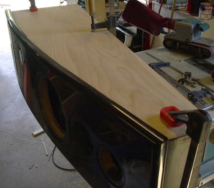

More progress on the build. On the first speaker, everything is going together good. The silicone only needs about an hour until it set enough to remove the clamps.
The other side is cut and fitted. The top is next. Both are glued in place and fit very well.

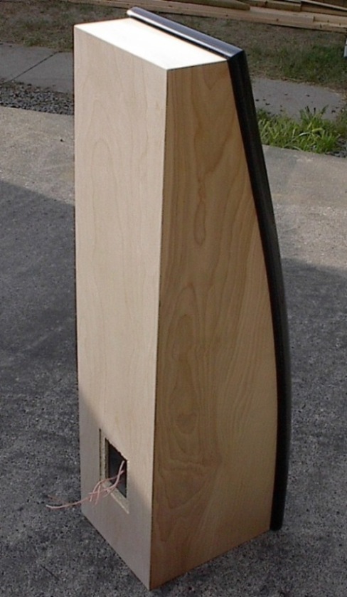

More progress. Just more, boring panels added. This time the back panel, which I recessed for an aluminum plate - the mounting for the banana jacks.
I've decided to go with banana jacks as opposed to binding post for three reasons: 1. lower profile. 2. I only use banana plugs, not raw (or tinned) wire. 3. They are cheaper, I need 12 of these. Performance of these with matching plugs is excellent, no need for anything better. I use a small amount of dielectric grease on the plugs to prevent oxidization.
The picture shows the rear of the speaker, all done (but concealing an ugly secret. A secret I'll reveal in the next post).
Corners came together very tight, with no gap. It looks as though it has been veneered.
Overall I'm very satisfied with the results so far.
