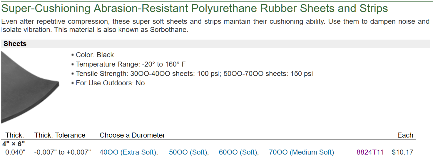

I'm wondering how this might compare to Dr. Geddes' method of PU/microspheres. Could be easier to apply, 3M spray adhesive on both surfaces and the sheet in between. Would it hold two pieces of ply together? Probably not. Would it perform as good as PU/microsphere? Probably not.
Be curious to get some thoughts.
Edit: Looking at the tensile strength, it looks quite low.
There are lots of options, you just have to try them. There are many different 3M sprays some very strong, others not so much. I would expect the spray route to be very expensive however as the spray is not cheap and does not go very far. I have used a lot of it in the past, but not for CLD.
