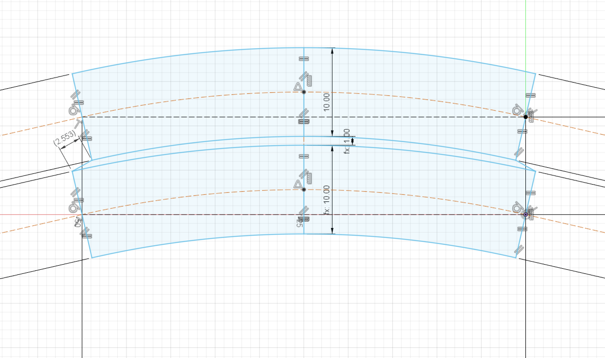

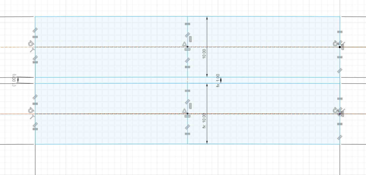

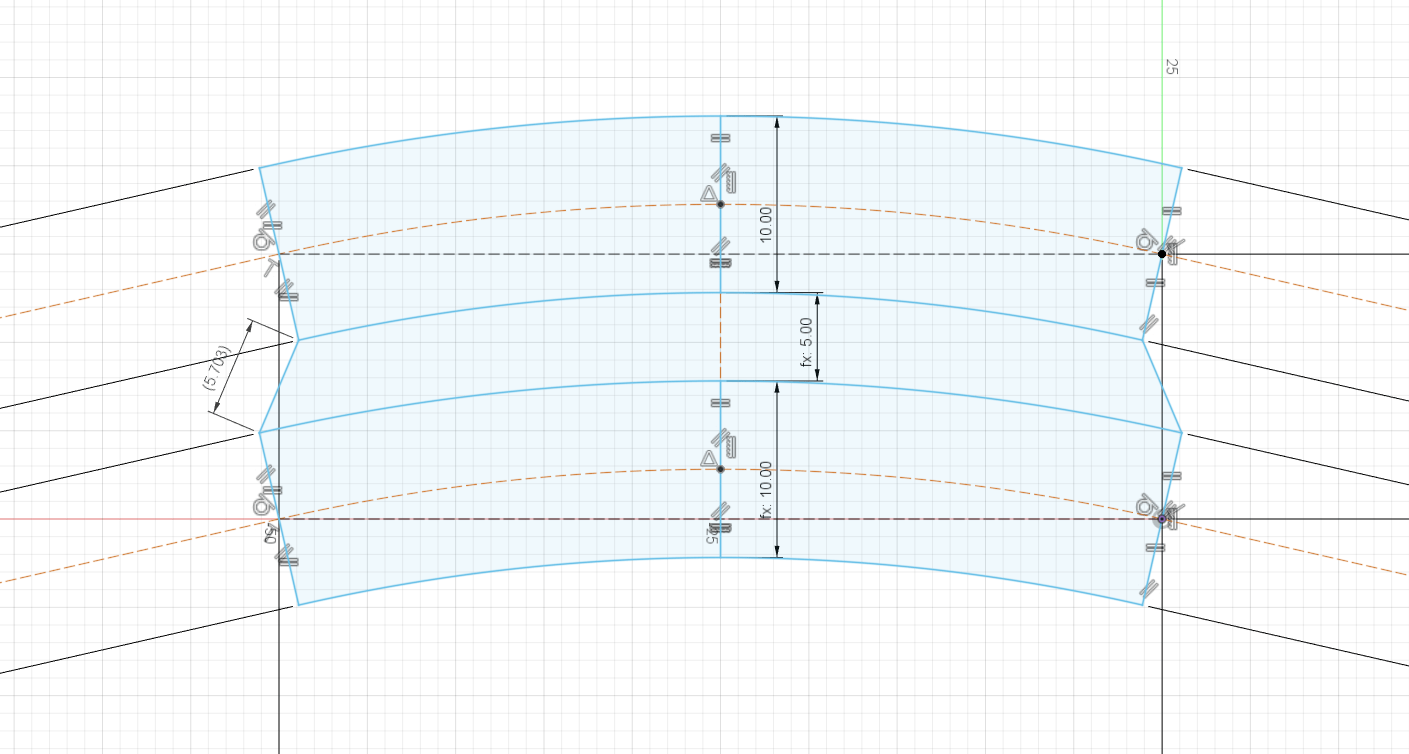

I did a quick mockup of a CLD in F360. All values are arbitrary.
Then with deformation:
I don't know how shear is measured so bear with me. On the 5mm example, the disformation of the damping layer is about 15% (from 5mm to 5.7mm). On the 1mm example we get a ridiculous 125%.
This is a vastly exaggerated example and I don't think a real panel movement will be more than +/-100µm without damping. Meaning, do you even get out of the elastic region with a real 5mm thick layer?
