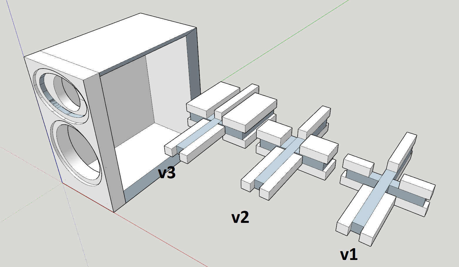

I wonder though, how much bracing would be preferred?
I made 3 versions, where version 1 is the most simple, small one; v2 the horizontal one is wider; and v3 where the horizontal brace almost goes almost all the way to the back panel and the back brace-finger stretches further forward too.
I guess my question is, how much surface area is wanted? As big as possible brace + as wide as posible fingers?
Or would a brace like v3 won't dampen as much, but only stiffen the panels?
Also, I removed the vertical ones because of the reasons mr. GedLee told.

There is no objective data, alas, only my subjective. But with decades of experience in noise control, I know what works, what doesn't, etc. I went by long trails of trying different things and what I ended up with is what I have described. Nothing objective, and as I have said before, I tried to get actual radiated data and could not do so.
As to your point about stiffness, a fixed rod is way too stiff, there is no motion and yes this will raise the panel resonates in frequency, but it will not damp them. Only by adding some damping in the members themselves. Some stiffness is lost, some damping gained - I'll take the damping.

Modes are always excited, the question is always, to what degree. As the modes in the enclosure are shifted upwards with stiffness they are excited less, that's true, but they tend to radiate more - that's bad. IMO damping is the key, not stiffness.

Earl is outlining one strategy for "CLD," which is to dampen the panels with damped braces. Keep in mind that Earl is using his internal braced damping technique on speaker panels which have a high level of internal damping due to the properties of the cabinet materials that he uses. Applying this method to wooden speaker panels would likely be helped by this method, but you likely will end up at a different place than Earl.
Another way would be to use the fixed braces (not dampened) which increases the frequency of the vibrations. Then CLD panels (box within a box with dampening material inbetween) can be used to dissipate the high frequencies since CLD works better at higher frequencies.
