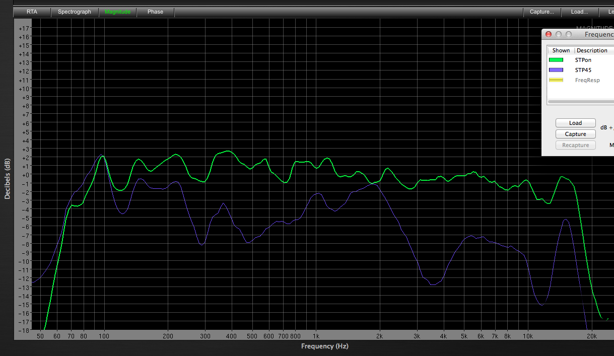

Weltersys said a big horn with a big CD could cover 90 degrees up to 16 khz, I was just showing it's not as simple as that. Within the 90 degrees there is still directivity differences at different angles and frequencies and a definite beam on axis at the very high frequencies (at least with this type of waveguide - I'd like to see polars of a horn/CD combination that can do 90 degrees at 20 khz if anyone has an example, please).
My SynTripP horn using a 3" diaphragm on a 1.4" exit does 90 degrees -7dB at 20kHz, though driver response drops off above 15kHz.
As you can see, the dispersion is wider than 90 degrees at 1900 Hz, narrower at 3500 Hz and 12kHz, but wider than 90 degrees at 15kHz, -4.5dB down at 45 degrees off axis.
It will be interesting to compare polars again when I switch to the B&CDE90TN, some of the upper deviations may be phase plug, rather than horn related.
Horns with narrow "pinched throat" diffraction slots can exhibit near perfect polar response, but generally don't sound as good as conical horns with a secondary horn flare, there are always various compromises to accept with whatever design is chosen.
