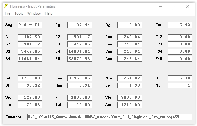

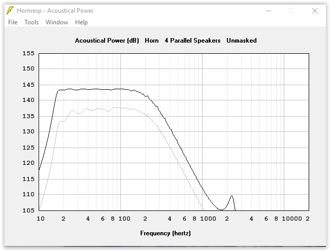

Hi entropy455,
I've been trying to find the time to look a bit more into the subject of building the horn from individual cells, and there seems to be no good reason for not doing it that way. In the example from Post #448 I'm using 10m horn length, and 60,000cm^2 mouth area; if we divide the length into 4 equal segments, and assign "8ft-material thickness" to each side of a square mouth we end up w/ a horn composed of four conical horn segments that can be simulated in Hornresp. The dimensions at the segment break points come from a Hyp system design, thus the individual segments are conical, but the overall horn has a Hyp flare composed of straight sections.
Build from plywood, this might be a starting point for your experimental horn. You will then be able to evaluate how close you are coming to the Hornresp simulation, and how many cells you need to build to arrive at your desired SPL, and if you want to add another 8ft section to increase length and mouth size. You can use the 'Multiple Speaker' tool to see the approximate total SPL for any number of multiples. Please, note that the summation will not give you +6dB throughout the passband of the horn, you'll get about +6dB @ the lowest frequencies (e.g.: 20Hz), and closer to +3dB @ the upper frequencies. (e.g.: 150Hz).
Obviously, you can build the final concrete horn any way you like: round, square, rectangular, as a single internally open horn or from individual stackable cells, 4 cells left and 4 cells right, whatever...it's your baby.
P.S.: I hope to find the time to add a sketch later today.
