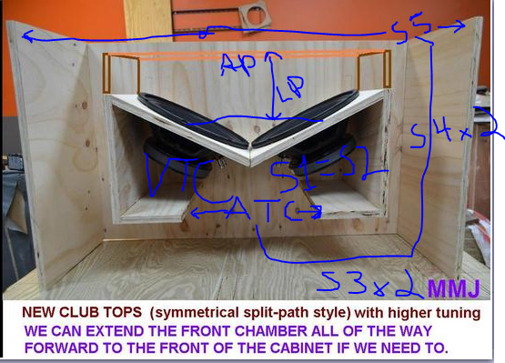

When modeling these, could you please explain why you choose to not treat the volumes in front and behind the drivers as volumes? I'm having a hard time wrapping my head around the Vrc and Lrc being 0.1, instead of modeling this as you would a Cubo design, with the volume behind the drivers (Vrc) and making S1=S2. Then using the Vtc and Atc to capture the volume in front of the drivers, instead of using the Ap and Lpt I kept in the pic.?
P.S. sorry for the cheesy scriblings, I hope you can make out what I'm trying to ask from the picture.

You can model a compression chamber behind the drivers if you like by using Vtc and Atc , i have modeled it this way before and it does work just fine .. In this case you would reduce the S12 length down to .1cm ... You can then reduce the CSA of S1 & S2 to a very low value which becomes the throat of the horn and flares out with expansion in the rest of the horn segments to complete our main path of the horn ...... This method works but i did not observe any advantages in the simulation over the way i typically model these cabinets .... I can show you what it would look like in a sketch if you like , we may try building them this way some time (with a compression chamber followed by S1 with small CSA as the horn's throat) to see if it sounds any different in the real world ..
Since this design uses compound loading (unlike the Cubo) we have our dedicated resonant mass of air in front of the drivers which we could call the front chamber & resonator but in Hornresp it is referred to as "Rear Vented" , nevertheless this is composed of Vrc & Lrc along with Ap and Lpt ............................................... I chose to mainly use Ap and Lpt to form that chamber/resonator going with minimal values for Vrc and Lrc but you can reverse that scheme by reducing Lpt to a very low value and then forming that section out of Vrc and Lrc but once again the results are basically the same ..
In Hornresp's "TH" mode we can model designs like the The Cubo , Tapped Horns, TPQWR (ROAR) , Classic Transflex (sometimes called "Tapped Pipe") , and also the PARAFLEX (SP8th variant) ..... With the Paraflex being the only compound loaded design out of that bunch..
The non-path-merged (or minimally-path-merged) Super Planar and Super Planar 8th cabinets use "OD" mode in Hornresp , which is the same mode used for QWPs ("TL") and OD-QWP ("TL") , ML-QWP (ML-TL) , Scoops , Back Loaded Horns (Rear loaded Horns) , Voigt Pipes, TQWPs , ML-TQWPs etc but once again the only compound loaded designs in this group are the Super Planars ...
The Paraflex and the Super Planar 8th are very similar with the exception of the paths merging significantly near the mouth with our Paraflex .......
However, as you may have noticed with some of our Super Planar tops we have the divider panel trimmed back by just a few inches to allow a small amount of merging at the very end of the paths , but it is minor ....... The length and shape of that divider panel (near the ends of the paths) is worth trimming and experimenting with because it should alter and contour the midrange response somewhat ... It may prove useful in fine-tuning the response of the cabinet........................... As Mr Vansickle is building the current set of Super Planar tops for the nightclub he is going to try to find the time to get some measurements while making alterations to the divider panel ................ On these particular boxes we may have to go without any path merging by bringing those dividers all the way to the front of the cabinet in order to get enough dedicated air volume in that front chamber to fill in the pesky midbass dip or hole just above the FbX3 harmonic ....

Thank you very much, MMJ, for taking the time to write that out. I would love to see some diagrams, if you have time, so I can make sure that I'm really understanding what you are trying to convey. Also, excited to see how this symmetrical design works out, as I would like to desig something similar, but with the PA255-8's instead.
No problem Fidstang , i will put together a sketch or diagram for posting here soon .. ....
