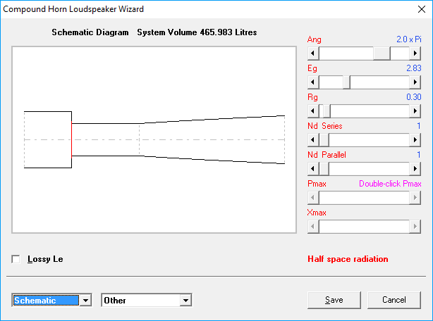

How are you simulating that paraflex design again? It looks like it should be simulated as a compound horn, but the schematics you've posted suggest that you're using another method. If it was being sim'd as a compound horn, the schematic would look something like the attached image.
If I have some time today, I'll see if I can put together a workbook to sim the fold and work out the path length via the Advanced Centerline Method.

The Paraflex cabinet and the Super Planar 8th are both compound horns with the difference being that the Paraflex has it's paths merge at the very end , and a mouth is shared by both the high-tuned and low-tuned paths..
So the Paraflex is modeled in TH mode using the "Rear Vented" chamber option (Vrc/Lrc & Apt/Lpt are in play) to form the high-tuned chamber , the end of which taps into the main path very near the mouth ...
The Super Planar 8th on the other hand can be modeled in either "CH" mode or in "OD" mode utilizing the Rear Vented chamber option again as we did with the Paraflex except that it doesn't ever tap into the low-tuned path at all , it just stays separate and has it's own dedicated mouth .. .
The "OD" method has the advantage of allowing some driver-offset as we would have in the single-path layouts , or we can go with no offset as we would have with the split-path symmetrical layout ...... "CH" is limited to no driver-offset at all .. ... So "OD" mode is a little more versatile in that regard when modeling a Super Planar ....

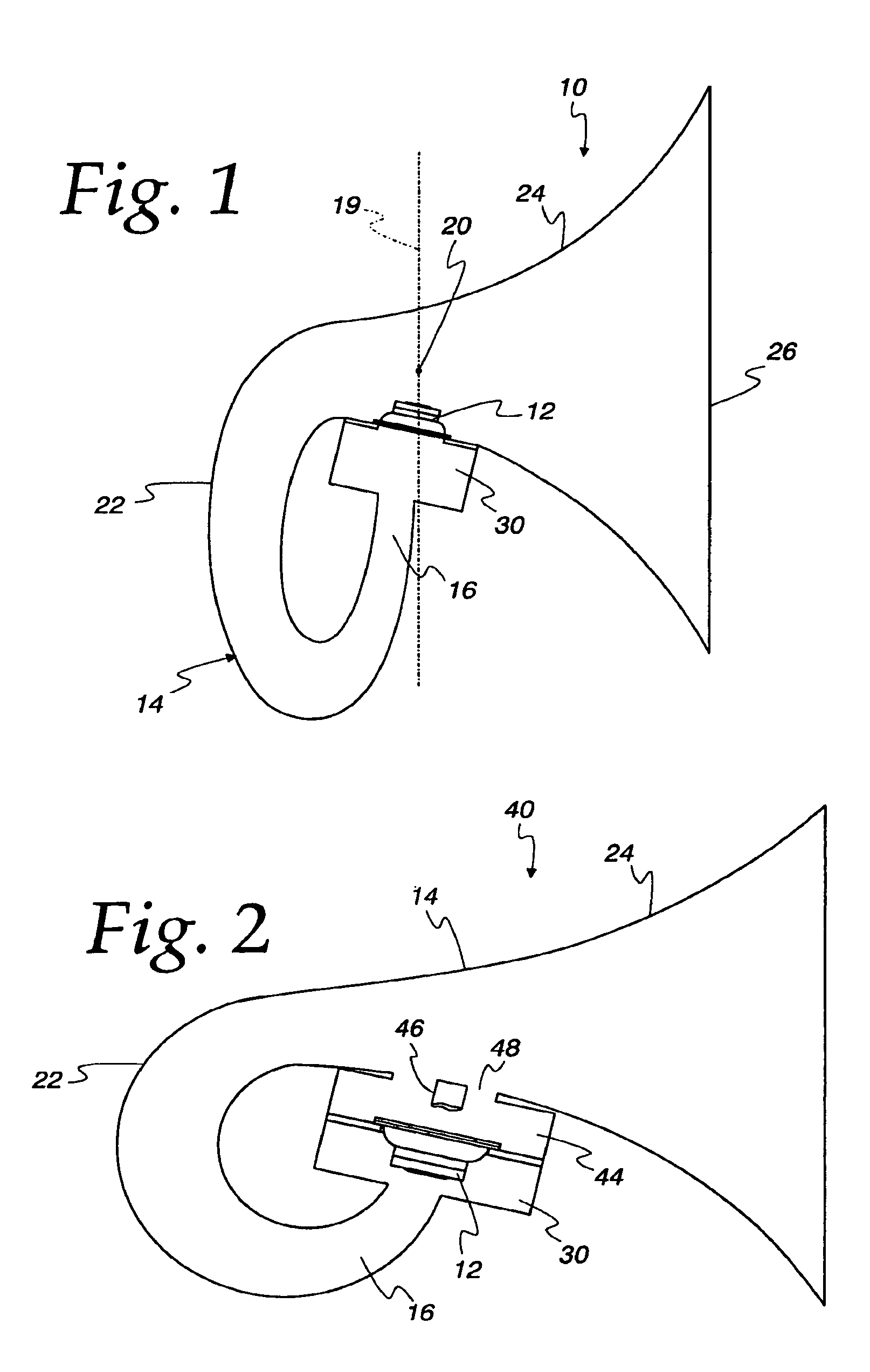

Tom Danley's tapped horn patent has a compression chamber.
BP1Fan ,
The old drawing does show compression chambers (on both sides of the driver even!) but I don't believe Danley ever built them that way (not that i am aware) and in order for that throat chamber to develop it's own resonance within the passband of a subwoofer it would have to be sizeable... Just look at the size of the chamber we are using for the Paraflex (in relation to the rest of the box) , that is what it took to develop a resonance at the top of the subwoofer's passband , and also helps to define the upper cutoff .. .

This is two of the DDX 12s in a 210-ish liter 35hz tuned Paraflex using the "Lossy Le" mode in Hornresp ..... Driven to around the Xmax rating , maybe slightly over by 1mm or two , still in the very safe range ... ...
It is the estimated "in-vehicle" response which isn't quite 18db over Halfspace , and we are finding that this method is conservative ..
If anyone is curious about the output in HALFSPACE I can tell you that two of these drivers in the 35hz tuned 210-ish liter cabinet produces about 130db at full power , and has solid response right down to 35hz , upper limits would probably be at least around 90hz before response starts to dwindle above that .............................. To put things into perspective it is nearly impossible to find a 18" PA driver for $320 that can match this output and extension in a 200 liter quarterwave loaded cabinet ....... PA 18s that are capable of this are usually much more expensive than $320 ...
Two of the DDX 12s can displace about as much air as an 18" driver with 15mm of linear one-way cone travel and has a combined power handling of 2000w RMS ..
