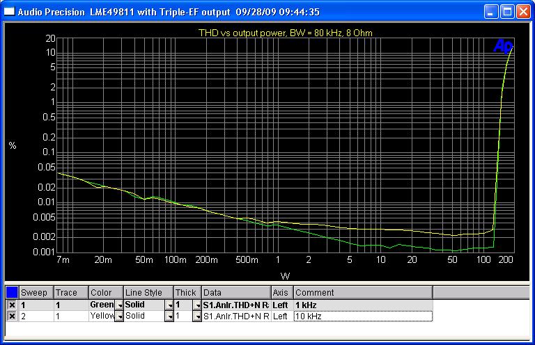

Can you explain why the 10W setup has more distortion at HF?
For 10 W output power, background noise dominates the THD+N for larger measurement bandwidths (noise limited). Here are 1 kHz and 10 kHz THD+N vs output power for various measurement bandwidths.
Here is THD+N vs output power for BW=80kHz for 1 kHz and 10 kHz tones. We can see that noise power is larger than THD power until output power is about 50 W.

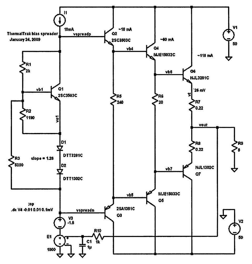

Guys,
I need some with bais on a LME49811 driving a Leach type triple with Thermal Traks as the output transistor(s). I'm using the schematic by Bob Cordell from the Thermal Trak thread(attached) for the current amp section and the National schematic for the front end. The source lead goes to the "vspreadp" and the sink to the "vspreadn". With the input shorted, and a +-33vDC from my power supply, I get approx. 0.49v at the point Bob labeled vb6, but no volts at R7 - the point Bob labeled "vt". Is my voltage to low to get the required current and voltage to turn on the NJL3281/NJL1302's? The amp play, and even sounds nice, I get a clean sine wave, without cross over bumps.
Any thoughts would be appreciated.

if you set up ~1.2V across the output bases you will get ~20mV across each Re and 1200mV across R6 giving the 60mA driver bias current.
That in turn requires ~2.4V across the driver bases and biases the pre-drivers to 10mA.
This requires the Vbe multiplier to generate ~3.6V

Your outputs are turned on if you have no crossover distortion. Did you measure the voltage across R7 or from ground to "Vt"? If the latter, may be you include some offset into your measurement.
I tried it both ways. I measured the voltage from the base of the output transistors to ground and the voltage across the Re's and from NPN base to PNP base all were at 0v DC and base to base was .007vAC.

Where do I measure the Vbe voltage from the base of the Vbe transitor to ground?
Sorry I meant from the emitter of the Vbe transistor to ground.
Did you measure base-to-base of Q2 and Q3 voltage?
No, I measured from emitter to emitter, is that what I'm doing wrong?
So, I just measured base-to-base between Q2 and Q3 = 0.509v dc.
I also measured the emitter voltage of Vbe transistor to ground 1.91v dc.
thoughts?
