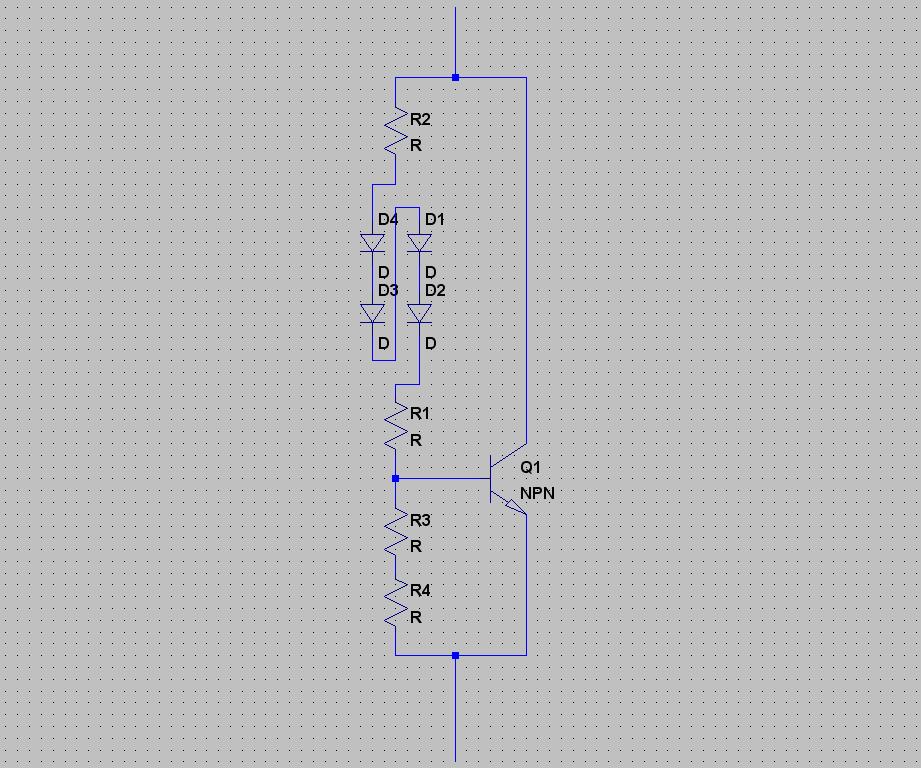

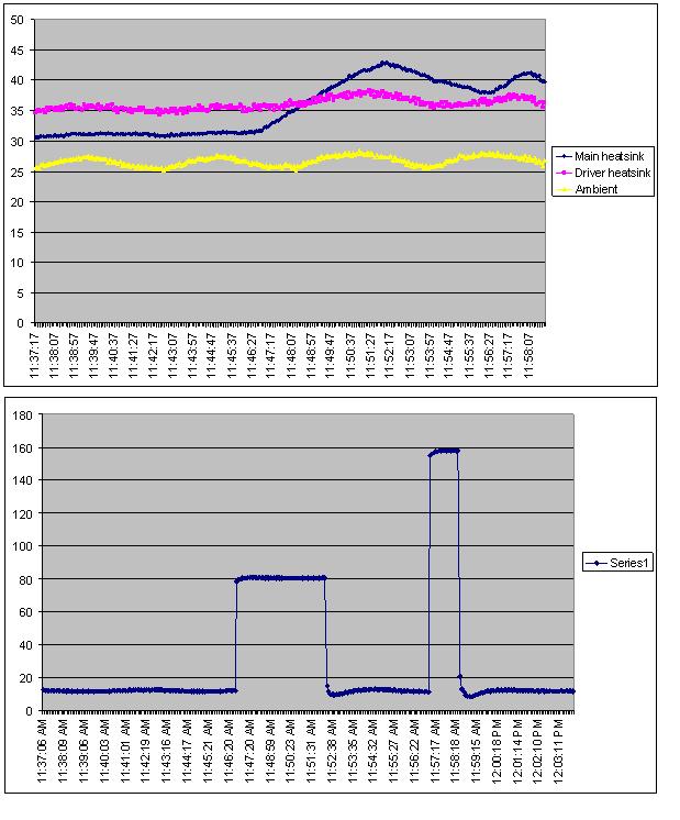

Here are some test data for bias/thermal tracking.
Amplifier configuration
Measurement setup

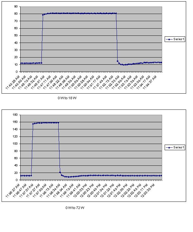

Case 1 - All four diodes mount one output devices' surface
When output changed from zero to 18 W, the emitter voltage drop increased accordingly. It can be seen the bias was too low after output changed back to zero. The bias moved slowly back to target static value. The bias/thermal tracking was over-compensated since the control loop temperature coefficient was 4 x (-2 mV/ deg C).
LME49811 with output triple
Pre-driver and driver are MLE15030/31
Output devices are MJ21194/93
Bias cotrol: Vbe multiplier as Leach amp; four BD139 connected as diode
Measurement setup
A DMM monitoring one emitter (0.22 Ohm) voltage drop
A temperature logger monitoring main heatsink, driver heatsink and ambient temperature
Case 2 - Two diodes mount on devices' surface
Without only two BD139 mount on the devices' surface, the bias/thermal tracking speed has been increased. It took a much shorter time to reach target static bias after outputing 18W/72W.
