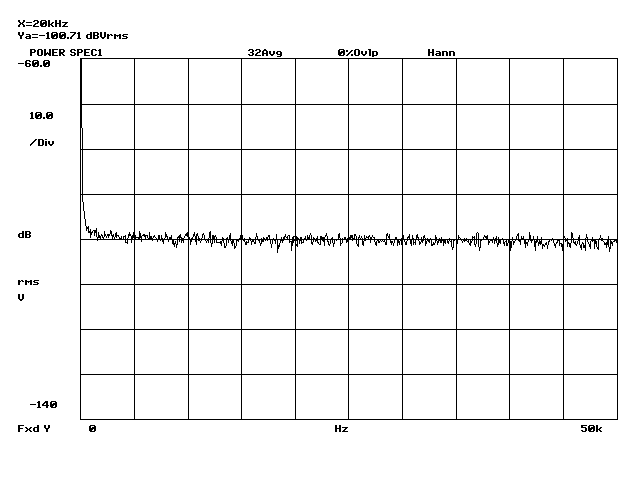

No this is noise floor of the DUT - compact 49810 with thermltrak, though the scale is not dBV.
Odd... What's the dynamic range of the AP?
Your measurements show the noise floor at -115ish dB referred to 80 W (25 VRMS). 25 V is +28 dBV. That means the noise floor of the DUT is -87 dBV. I'm measuring -103ish on mine and that's enough noise for me to hear it when I'm close to the speaker.
I don't mean to argue semantics here. I'm just looking for some hard core data to prove me wrong and tell me that I should redesign my board to get rid of ground loops...

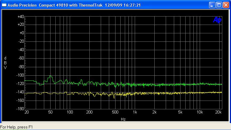

Plz note that the 80W there is peak value for a dual-tone 19 + 20 KHz test.
I connect pin 3 to the decoupling ground of the chip, not the input and NFB cap ground.
Noise floor of my AP1 (bottom) and the amp in dBV (AP1 gen off).
I agree with you that 49811 is more sensitive to layout quality.
In my layouts, star grounding is employed. I connect pin 3 to the decoupling ground of the chip, not the input and NFB ground.

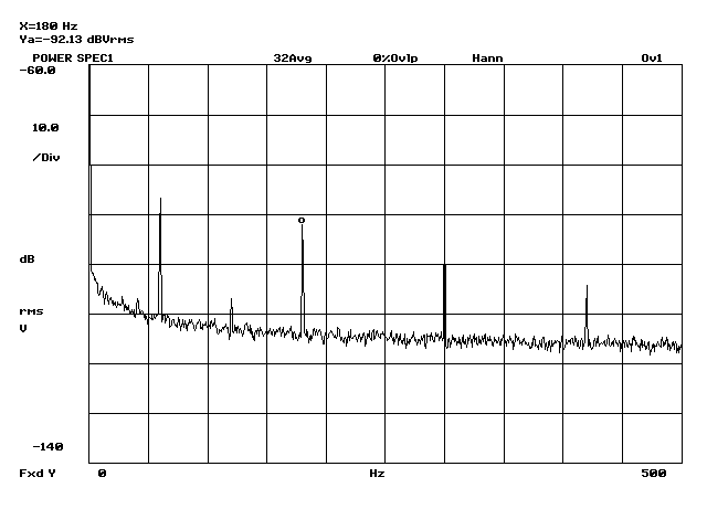

this advice may reduce the buzz showing on your 500Hz plot. I see all mains harmonics from 2nd to 8th about the same level as 60Hz hum. This points to a grounding error..............Decouple the LME with power supply with small resistor and electrolytic to high current ground ( these currents may not flow in the sensitive input ground), this is the main PS capacitors point
Bypass with small ceramic very close to the LME, this has to go to input ground.
Put a resistor of a 10 or 100 ohms between ouput and input ground.
Avoid loops of output current generating magnetic field in the input loops.
600uVac at the output is bad. +21dB ref 50uVac and -92dB ref 25Vac
I expect <50uVac from all my amplifiers. I have not tested the noise of a 49810, but I have no reason to expect it to be any worse than normal amps.

My issue has ground loop written all over it. See test results below. Improper grounding has been my main suspicion from the start. But I can't for the life of me find that ground loop if there is one... The issue gets further complicated by the fact that I am reusing the chassis of a Parasound A23 that a friend of mine gave me after his girlfriend accidently spilled water in it, thus, killing the amp. I am reusing the input board of the A23 as well as the power supply and heat sink parts. The chassis ground is on the input board. The two amp channels have completely separate power supplies that are grounded to the chassis via the input board. I run the ground of the LME49810 along with the ground for the bypass caps on my driver board to the star ground between the two supply caps. The signal ground is grounded via the shield in the input cable to the input board. I hope this makes sense...
I should probably read that some more...
I bought mine 12-13 years ago from a reputable dealer. I doubt they're fakes. But I have no way of knowing for sure.
Now for the test results and schematics. On the wide-band noise plot, the magenta trace is the amplifier noise floor in dBV with the amp input terminated in 50 ohm, the blue trace is the noise floor of the analyzer (terminated with 50 ohm). The second noise plot shows 0-500 Hz - notice the ripple. This is with the power for the output stage filtered with a pair of 2SC3281/2SA1302 rigged as capacitance multipliers with 1k, 1000 uF on the base. The cap multipliers had negligible impact on the amount of ripple feed-through.
I have these issues on both channels. I have, of course, tried running one channel only and breaking as many grounds in the un-used channel as I could get away with. Still... No dice.
~Tom
Nice!! Exactly what I was looking for. Thank you very much.
What's the gain of your amp, by the way? The usual THX 29 dB?
That's what I'm doing as well.

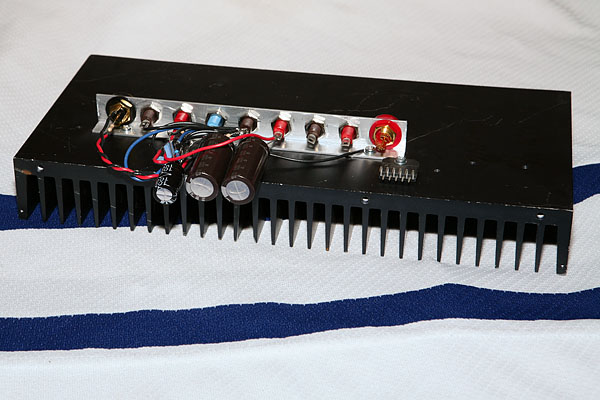

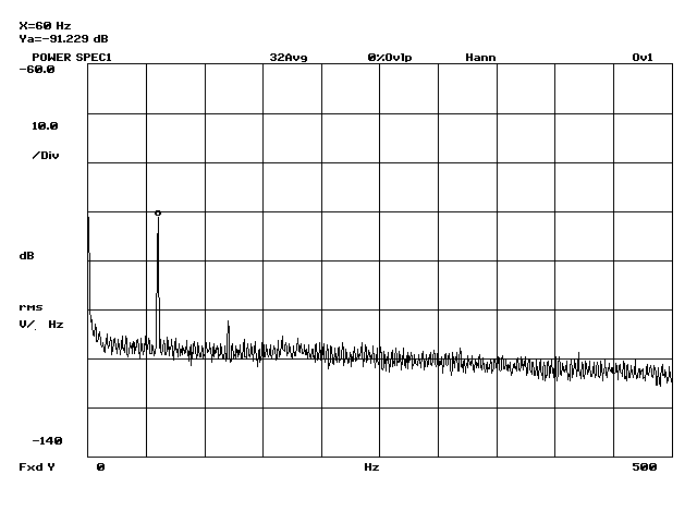

The plot thickens... I disconnected one channel of the amp and terminated the input to ground via a 10 kOhm resistor. I connected the channel to an HP 6228B lab power supply and made the star ground at the power supply.
The LF noise cleaned up quite a bit, and the even order harmonics of the AC line frequency disappeared. But the odd harmonics (60, 180, 300 ... Hz) are still there. And I still hear a hiss in the speaker with my ear close. The hiss goes away when the amp is muted.
My PCB layout of the amp is definitely not ideal. I could have done a better job with better star grounding, etc. but the layout is not horrible. However, the base connections to the output stage are strung from the right side of the board. So one base connection is approx 20 mm long, the other more like 120 mm... I figured the EF output stage of the LME49810 was low enough impedance to not be bothered by it, but maybe not.

So as promised, here are the noise plots (in dBV/rt(Hz)) for an LM3886 amp with a gain of 20 V/V (26 dB). When building the amp, I made sure to have proper star grounding.
I am fairly certain that the remaining 60 Hz hum is electrostatic coupling into the input and/or feedback. I suppose I could shield the circuit with some aluminum foil to find out for sure, but I haven't bothered.
Initially, I had issues with multiple harmonics of 60 Hz showing up on the output. I got rid of those by grounding the heat sink the LM3886 is mounted to. I'm using the TF version (isolated package).
There's still a very, very faint hiss in the speaker. But the hum is gone. The hiss is only audible when I put my ear 1-2 cm from the tweeter dome so I can live with it.
Bottom line: Star ground does matter.
~Tom
