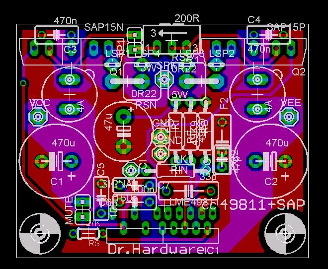

I also have a design for LME49811+STD (or SAP) darlingtons for one year. Its a bit "crowded" but only in 1/8 eurocard (40 x 50 mm). If someone request then I can send the eagle files..

I have no measurements yet. But if you need the BOM is;
C1 470u
C2 470u
C3 470n
C4 470n
C5 100n
C6 100n
C7 150n
CC 33p (silver)
CC1 47p (silver)
CI 47u
F1 4A
F2 4A
IC1 LME49811
Q1 SAP15N (or STD03N)
Q2 SAP15P (or STD03P)
R1 200R mutiturn trimmer
RB 49K9
RF 49K9
RI 2K
RIN 2K
RS 27K
RSN 0R22 5W
RSP 0R22 5W
