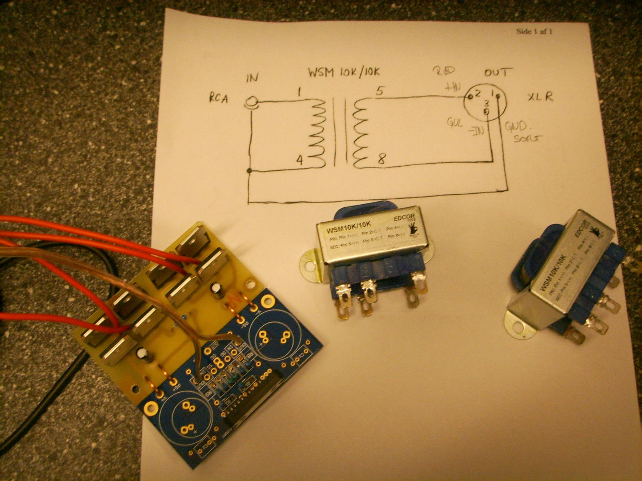

I do not exactly know what you mean with dual bridged rectifiers, I don't think so, but I included a pic to be sure. What I forgot to say inprevious post is that when I connect a source to the input and a test speaker, there is complete silence, not even some hum or whatever when I touch the plug....
dual secondaries and 8 diodes indicate dual bridge rectifiers.
That accounts for some of the extra voltage drop going from AC to DC.
A single bridge rectifier loses ~1.4V across the dual polarity supply.
The dual bridge rectifier loses ~2.8V across the dual polarity supply

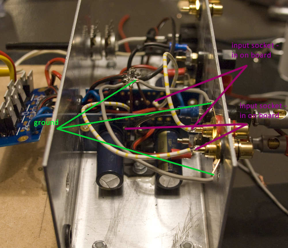

Ok I have checked and double checked, and all above described values stay the same, I just do not hear anything when I connect a line input source. No sound, no hum, no noise. Just a kind of "thump" sound when I connect the speaker.
checked speaker, source, cable....
Any ideas?
Any ideas?
I think you have a break in continuity between your input socket and the amplifier input.
That would mean no connection between the points in pink/purple on attached picture, right? Those points are according to my multimeter well connected... as are the ones in green btw...
insert an RCA ended interconnect to one input.
Attached one probe to the hot pin at the far end.
Attach the other probe to the soldered joint of the next component down the hot trace from the coax input.
This will check for continuity through the RCA plug socket, through the RCA soldered joint, through the coax, through the input soldered joint and into the copper trace that is you hot input.
Move the probe from the PCB to the chassis and/or the central ground (other probe still attached to hot interconnect pin). Check continuity from hot input to audio ground. If this is shorted then no signal to amplify and no change in the DC offset conditions with alternative connections.

Today all the hard work (at least for a newbe like me) fell into place. Damn this amplifier sounds good! All the clichés are true: musical, lively, open, tight...
Iam so happy I started this project, and ever so glad you guys pulled me through.
Big thanks to Peter especially, but also all the others who had to put up with my questions...
