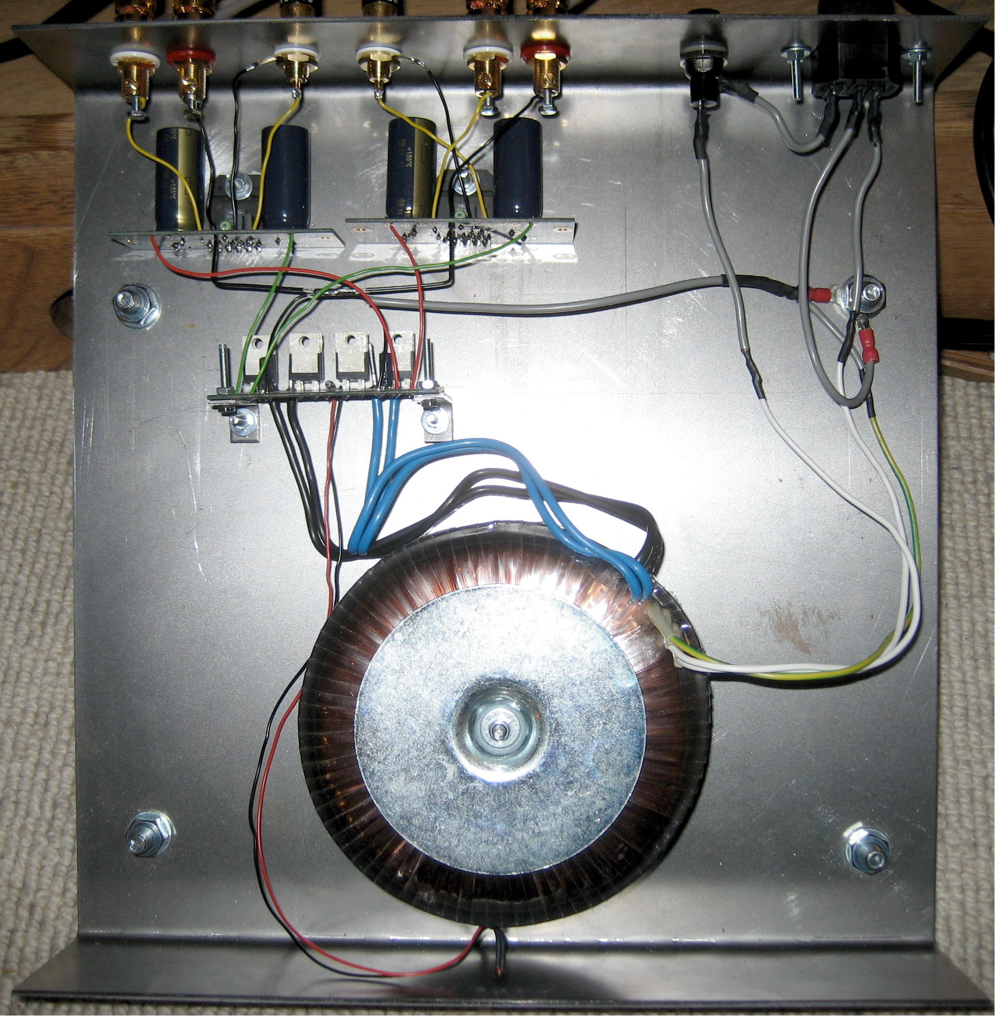

Here is a picture of my amp. It's pretty much like Peters, only in an all-metal "enclosure". Only thing on the front is the LED.
