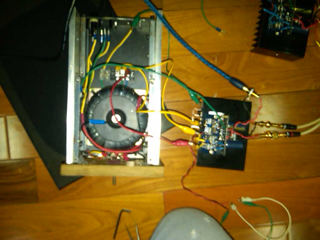

1)the buzzing sound will always be there if you use mains
2)no way to completely eliminate the buzzing unless you use the two options as suggest by you

no.once amplifier is connected to load it is not noticeable, The only way to make it totally silent: 1. to use car batteries 2. to use regulated power supply.
Correct wiring and routing of wiring can give a silent power amp output.
Does the buzzing stop if you lift the earth ?
how do you 'lift the earth'?
no.
I have a very small chassis (hey...it was free, so no complain) and wires run besides the transformer. Please see picture

are they from alumunium ?
if the buzz has gone when the earth or the chassis ground is disconnected you could try a large 10 ohm resistor from the chassis ground to the case that will also stop the buzz but still ground the boards.
i have a good star ground but the PC i use as source is just too noisy this worked for me although i will change it for a CL-60 NTC later. do not interupt the main safety earth from the socket though that should still be connected to the chassis with nothing between it.
Hi...thanks. The boards sits basically on the anodized heatsink and so far, i have not notice the heatsink conducts electricity through the chassis.
