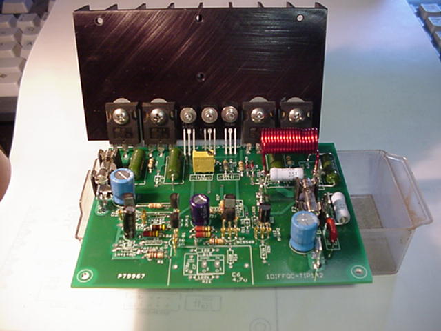

C6,R20,R27,R30,R31,R33 are mounted on the bottom of the PCB.
R33 is a ground lift resistor that could be around 7.5 Ohms, I would first use 0 ohms and if hum was encountered would then go fancy with the ground lift.
Heres how I do it.
1. Test all your components for defects including PCB
2. Stuff PCB starting with small components working your way to large components i.e. output transistors
3. Examine assembled unit for any solder issues or bent pins shorting others
4. Attach assembled unit to PCB isolating the transistors from heat sink.(Test this)
5. Ensure bias trim pot is set for maximum resistance
6. Attach bulbs on positive and negative rails
7. Do a jig then power up, if bulbs light up, wash rinse repeat, you may have done this in poor light
8. If all goes well, set bias, attach scopes and torture amplifier, if it holds up
9. Plug in your speakers (some use speaker protection)
10. Plug in the "I like to move it move from Madagascar" CD
11. MOVE IT !!!!!!!!!!
12. WE LIKE TO............
Heres a members implementation
