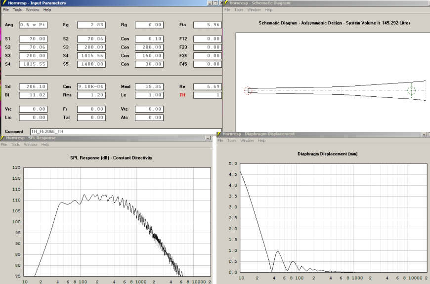

Hi GM, thats an interesting twist on my idea, i appreciate the new input. Regarding my room, its about 6,6 * 5,5 meters, with the lowest resonance at about 26hz. If i setup my woofers to cancel the lower room modes, there is no room gain above about 20hz. If i choose corner placement, i get a boost at some low frequencies but also alot of notches, allways depending on where the listener is - my room is really a bad case. This is why i think maximally flat in combination with proper placement to cancel some room modes will work better.

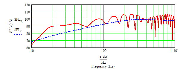

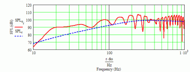

I made a spectrum analyzer survey about my music and i found out, that while 30hz bass is quite common, 20hz is rare and mostly due to vinyl rumbling, strange samples etc. I only found two records, that use a <30hz tone as a bassline. From this point of view, it doenst do harm to use a 30hz horn. Most of my music drops like a rock below 30hz, some even at 40hz. It seems like many mastering engineers like to have a highpass there.
Hi tb46, also much thanks to you, for the idea. I didnt know i could get such a flat <100hz response, i tried and found no parameter set for it. If i only could cross my mains so low. Well i could do this, but that would rob me of 15db headroom
