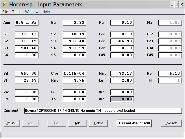

The drivers name is Beyma 12P1000ND, that was an error on my side. I use this ratio, as i will never drive it to its limits and it gives the best response. Also, the membrane is very heavy and solid, so i figure it could work.
tb46 said:I noticed, that you are using a compression ratio of 550/105, according to Cowan that is on the high side. Also, I could not find a Beyma 12ND1000 to verify the parameters, do you have a link?

MaVo,
after reading the above, by tb46, I looked at the force on the cone (in AkAbak) in an approximation to your TH (the higher frequency one). Even though the compression ratio is on the high side, the peaks in the force graph were not much more than for my PD1550 TH with compression ratio 3 (for same excursion, or roughly same output - mine is smaller volume and so not quite as efficient, even with the larger driver).
I've driven the PD1550 at up to nearly 10V rms (for the excursion test), with short bursts of perhaps 20V (with scary rattles around the room at some frequencies) and would not worry at doing the same with your P1000 - I think it is at least equally robust.
Perhaps avoid driving it "full-blast" until the surround has "loosened up" a bit, so resist the temptation to do large signal tests right away... (I get the feeling that the pro-driver surrounds typically move only just enough to allow peak displacement, though I've only played with a few).
It seems that you have little option if you want a flat response with the P1000. (I vaguely remember the LX60 looking better in early modelling, when I tried almost every European pro driver, but did not keep all the models to check that.)
Ken

Hi kstrain, thanks for the hint. I compared my horn to what i belief to be a close approximation of the TH115 and the force peaks are about the same. Since i have the drivers, i want to get the most out of them. I never bought them with a TH in mind, so i think i am lucky that there is a parameter set which could work.

MaVo said:
My questions are:
- Is there something wrong with this setup?
- How can i improve it?
Greets!
IMO to XO a TH much above 80 Hz the driver needs to be end loaded at both ends to minimize the amplitude of its out-of-phase HF.
WRT its rising response, as me and others have periodically noted, this is desirable for most low tuned alignments since it blends better with all but the largest typical room gain curves than a maximally flat one.
Anyway, here's an example you can tune a bit with series resistance:
GM
