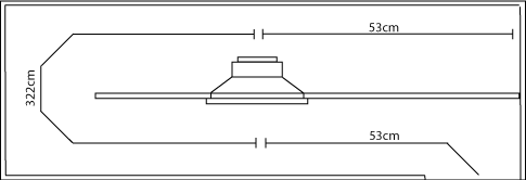

I have ordered for one 3015LF driver. I would like to experiment with this in a Tuba 36 and hopefully a TH if someone is kind enough to show me the box layout. Then I will surely order for 5 or 7 more to complete the subs.
So anyone wants to help with sketching out the box layout for the 3015LF driver?

"So anyone wants to help with sketching out the box layout for the 3015LF driver?"
What kind of form factor would be better; square-ish, or long and narrow? The mouth opening will be about 22.5" x 22.5" (inside).

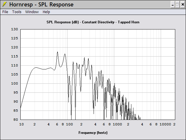

Interesting, GM. Looks like it's not ideal, but than again I'm only really looking for 50Hz and down. Is the graph at 1W? Room is quite small at 4x4m, and I can make two up and stick them right in the corners, so it might be worth a play. I'll have a look to see what else I have stashed away.

pinkmouse said:Is the graph at 1W?
No, it's at the ~Xmax limit of 5 W.
GM said:No, it's at the ~Xmax limit of 5 W.
I was pondering this over a glass of red wine. 105dB at 20Hz on the equivalent of a small chip amp is still very impressive, and would probably be fine in my small terraced house. Especially as I think that Xmax figure may even be rated as one way.

Don't know, it says 7 mm p-p, so to me that's only 3.5 mm Xmax. Regardless, from 30 Hz - up you can EQ it to ~12 W rising to ~36 W/80 Hz with just the 3.5 mm, so with any room gain you're looking at ~110+ dB peaks, not quite up to DD/DTS cinema reference, but not exactly a muted bass line either.
Not that I'm aware of, I mean any driver has an optimum gain BW for tapped pipe or horn loading, but I've seen no routine to calc the right driver specs for a given gain BW other than Dr. Leach's math, which AFAIK is what TD uses.
Yeah, in theory room gain will begin around 43 Hz and even with only a 6 dB Vs the theoretical 12 dB/octave rise with decreasing frequency, it could pound pretty good since above ~30 Hz it can handle more power. Or you could start with more gain BW beginning deep in the teens, though size jumps to ~507 L (5 W simmed):

djk said:"So anyone wants to help with sketching out the box layout for the 3015LF driver?"
Square-ish is preferred.

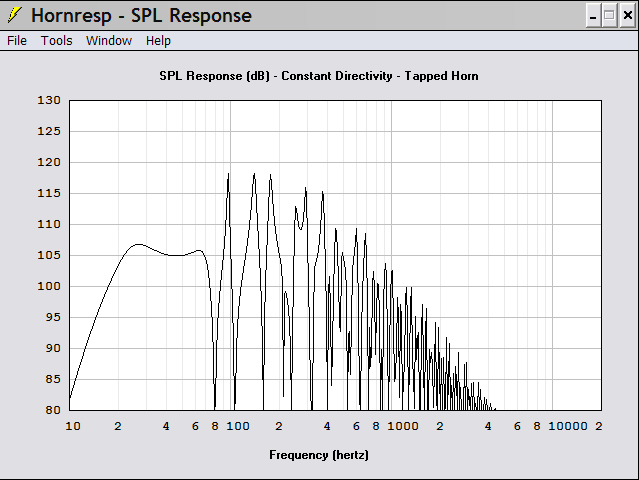

9512-04
Greets!
9512-04 12-98 Hz ~438 L tapped horn with 1 kW max Pe shown since it doesn't exceed Xmax until below ~16 Hz assuming the corner is rigid/massive enough to handle >1 AW (bad assumption for most homes I imagine):
