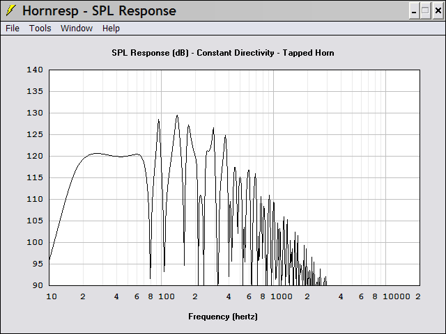

Hmm I dunno about the BL thing. I mean the BL of my 19OV2 is 22, and it works fine.
The VAS is pretty high 228L, and the response is very smooth, IMO.
Here is the graph
EDIT: I only use it from 20-70Hz, the 80Hz peak is not a big deal.

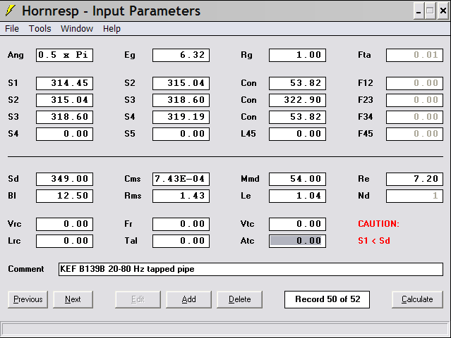

A few posts ago someone wondered about a tapped horn using the Tangband Eight.
This is my design for a tapped horn using the MCM 55-2421, which I still believe is one of the best horn drivers available. The fact that it's $25 is a bonus.
The goals of this design were different than what a lot of you guys are going for. This one is optimized to be as small as possible. It's also INCREDIBLY simple to build. It's a six foot tall sonotube, with a plywood divider running down the middle. There isn't even a taper! Because it's efficiency is so low (about 90db) you don't get a lot of ripple.
I think this tapped horn would be great for car stereo too, but you'd have to come up with a novel folding scheme.
So here's how to build it:
1. Get a 6ft tall sonotube that's 8" across
2. Get a piece of plywood, cut it to 8" x 65.5"
3. Cut out two 7.5" holes for the woofers
4. Put the two MCM woofers in the holes, as close as possible together
5. Put the plywood divider right inside the sonotube
6. Cap one end of the sonotube completely. Leave a 5.5" gap between the end cap and your piece of plywood
7. Put a cap on the other end that covers up one HALF of the sonotube
8. That's it!

The top graph is the previous post; bottom graph is this post.
The reason that I went with 9.5" sonotube instead of 10" sonotube is that I'd encourage you to nest two tubes together. Buy a 9.5" tube, and put it INSIDE the 10" tube. Then use something rigid in the gap. The end result is nearly indestructible, but lightweight.

pinkmouse said:Anyone fancy knocking up a sim for the Kef B139s?
Greets!
What did you have in mind? With only 3.5 mm Xmax and relatively low Fs/high mass corner, a wide BW alignment will be quite large and typical 20-80 Hz will be under-damped, though this straight pipe doesn't look too bad, is small at ~136.4 L, but doesn't play very loud either with only a ~5 W Xmax limit down low if the room doesn't boost it:
GM
