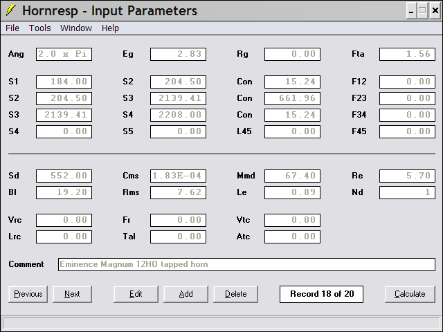

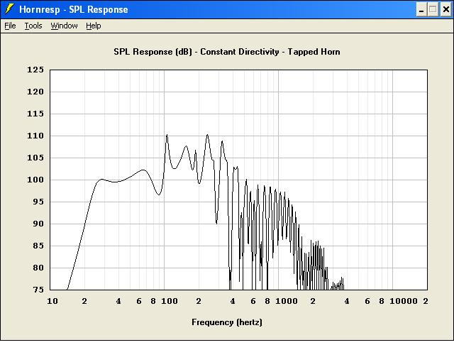

I was browsing Audio Asylum and found a link to this very interesting thread. After reading it for a few days I'd say I am ready to inhale some sawdust. I have the driver below for a few months now doing nothing, I thought I'd put it to use.
Do you think this would work in William's 30Hz horn?
Eminence Magnum 12HO (8ohm, 600W)
Fs 43Hz
Qts 0.29
BL 19.4
Xmax 4.8mm
Xmech 22.35mm
Accordian surround
Thanks,
Jeff

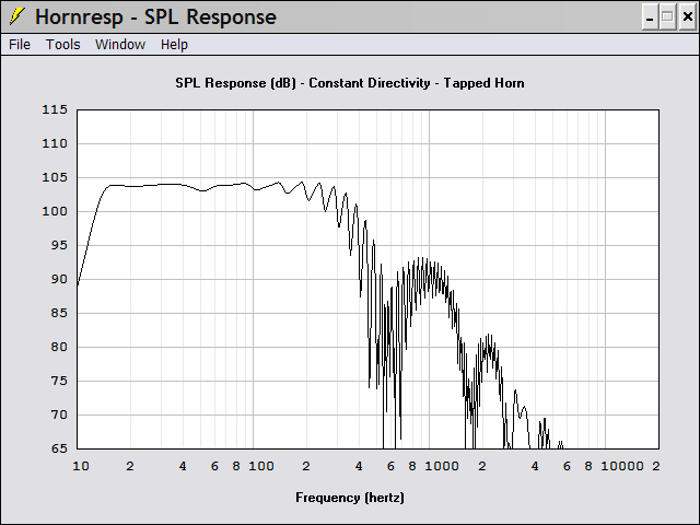

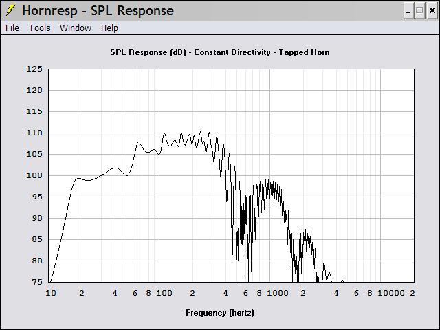

RobWells said:Could I ask what sort of driver specs I should look for if I wanted to do a tapped horn that is flat from 10Hz - 30Hz ?
Greets!
FWIW, I calc a ~17.32 Hz Fs/~0.408 Qes as 'ballpark' figures for a simple end loaded conical pipe horn like the two I recently posted, but assuming a LABhorn driver's Vas, then at ~107 ft^3 I doubt you'll be hauling it out of the workshop in one piece. Even then it's too small to be flatter than ~ +/- 3 dB. Since the DTS 20 is about the same down to < 20 Hz in a drastically smaller bulk though, so apparently it's no simple conical pipe horn as I understand them, making my calcs moot for an optimum alignment.
GM
JSS said:
Thank you GM. I believe 0xPi is a horn that goes forever,infinite, better than corner loaded? That response looks perfect, can I please get a screen shot of your input params?
Greets!
You're welcome!
Thanks, I'd been up for ~24 hrs when I posted that, so between having a 'senior moment' combined with sleep deprivation, I couldn't 'wrap' my mind around the obvious that zero pi = infinite.
Yeah, ~'infinitely' better.
It's not perfect since in theory it should be smoother over a wider BW, but plenty 'good enough' IMO for HIFI/HT apps once EQ'd ~flat in-room.
GM

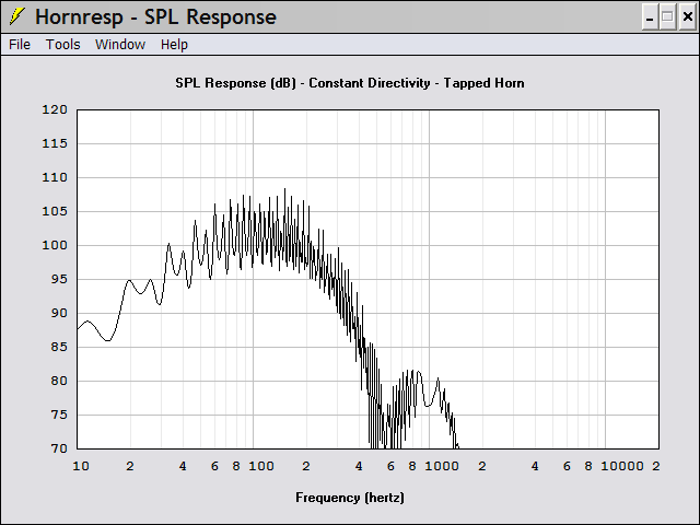

Such a wealth of information in this thread, i downloaded the program mentioned on Cowan's site and began playing with a driver I have laying around...
*Power Handling: 80 watts RMS/120 watts max
*Le: 1.2 mH
*Impedance: 8 ohms per coil
*Re: 3.00 ohms
*Fs: 28 Hz
*SPL: 89.0 dB 2.83V/1m
*Vas: 39.1 Liters
*Qms: 3.40
*Qes: .47
*Qts: .41
*Xmax: 6 mm
Just for fun I put it in the 30 hz horn, but I don't know where to go from there. I'm guessing I need to tune lower because of the FS of the driver, any suggestions for this driver? It will be crossed over fairly low (50hz ish) and used primarily for movies, turned off for music.

It's long but Wow, I did not think it would be possible to get flat to 18Hz. There is a 7db rise from 50hz, I have to cross at 80, do you recommend an 80Hz XO on this horn? Or is it too much to eq?
With a usable XO BW out to ~300 Hz, none of this is a problem with digital EQ and XOs and there's room gain to consider, so just dial it in in-room as required, just make sure you can adjust TD/phase too for best results.
