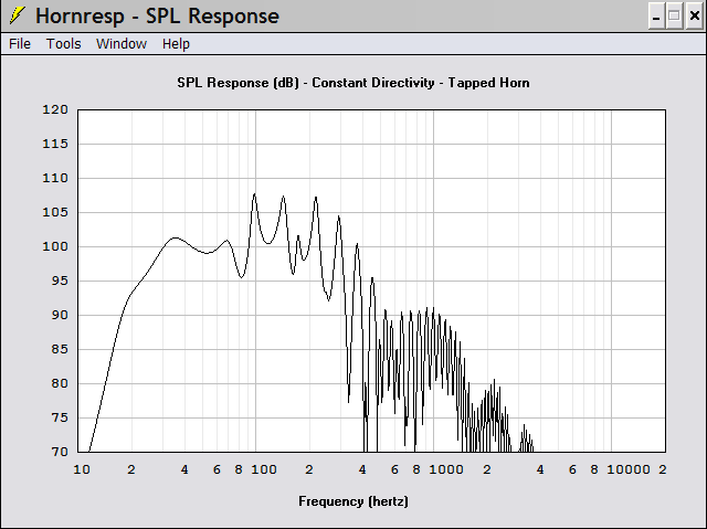

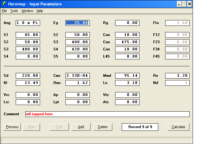

Now that I've had a chance to play with hornresp, I'll answer some of my own questions
Doesn't look good. I suspect BL is too low. Even in a 4+m horn, not much below 40Hz.
I started nooding with the TB driver and got something promising, and then found sabbelbacke's post back on page 27. My model looks very similar to his but scaled way up to a ~25Hz horn. It has a very small x-section and mouth and I *think* I can fold it down into ~150 L or so. ~95dB/W, and hits xmax at ~30Hz with 25V.
So, the next question is how to deal with the large spikes out of the passband? Notch filters? Brickwall FIR filters? (I guess I'm assuming they are real rather than modelling artifacts)

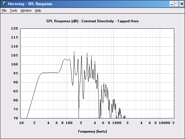

Hmm, maybe not the best choice, but where size isn't an issue (~33 ft^3 gross if I did the math right), this looks OK for a quick first pass and since it's under-damped can be shrunk some:
GM

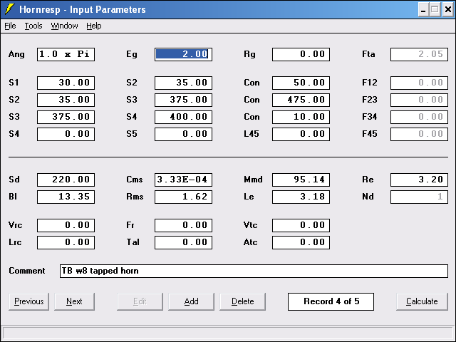

Volvotreter said:Do'nt you think the size of the throat might be a little too small? This is a compression ration of approx. 7:1! I'm not an expert on this matter, however my stomach tells me that not to exceed 3:1 may be 4:1.
Yes, I'm concerned that the specific size I've modeled is too small. However, the Fitzmaurice Tubas that use this driver also have very small throats, so there is evidence the driver can handle it. Certainly, given it's appallling efficiency, it's required to get any decent output from this driver.
I'll have to pull up my Tuba plans and see how tight a throat Bill uses.
judtoff said:This is interesting, I have one of those Tang Bands, and was planning on doing a 35Hz Tapped Horn.
I couldn't really get a 35Hz version to work with the TB, but if you start with sabbelbacke's version from a couple pages back you should be ok.
My ~25 hz versions look to be foldable into a package 6'x18"x9" or so, which IMHO is pretty small for the performance. I haven't really had a chance to sit down and draw things accurately though, so I'm not 100% sure it's going to work.

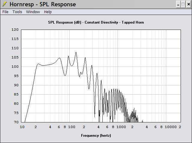

Thanks for the help. I was looking around and found an interesting fold pattern.
With the TB W8 It would be tuned to about 30 Hz or so. Do you think it would stand up to a 5:1 compression ratio?

G'day judtoff
That is an elegant folding scheme. In practice there is actually little need to angle the internal baffles, just step the areas to approximate the desired expansion.
5:1 is too much for any driver I've seen or know of. Even the beefy Lab12 driver would fall apart above 3:1.
Bills horns are well executed compromised front loaded bass horns, but for the volume and mouth size, a well designed Tapped Horn will always work better (flatter, lower, louder). A Tapped horn is uncanny in it's ability to work really well with a very small mouth and total volume.

Checking my plans for the Table Tuba, it looks like it runs right around 3:1. I'll play around with my model and see how I can rebalance things.
judtoff - William is spot on. For a given size, a tapped horn will outperform a Tuba if we're only worried about use as a sub. The 'problem' with Bills Tubas is that they're wider band devices, and the sub frequencies are at the lower-efficiency end of their passband. For example, the Table Tuba holds ~95dB efficiency down to 30 Hz, but needs 9 cu ft. My models show a tapped horn holding 95dB down to 25Hz in about half that size.
BTW - your folding scheme is similar to what I'm looking at, although I have one more fold and some changes since I need the mouth halfway down the cabinet. Your diagram should work fine as long as the dimensions are right.
