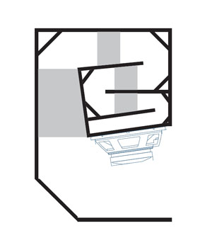

Hello all, I have 2 mighty beefy 12's and 2 1700 watt amps to play with, and I'm trying to figure out a horn enclosure for me to build to set up at burning man next year, I have them in a normal ported box (around the size of a refrigerator ��) and with these sundown audio subs being about 63 pounds a piece, the enclosure has become rather heavy, as well as leaving the subs out and exposed a bit too much for my liking. I'm looking for any help on the design of a horn enclosure for one driver per box, total of 2 boxes. The driver specs are below:

I'm thinking regular folded horn instead of tapped unless there is a way to protect the motor structure from the elements. Woofer Protection and projection/impact are the main goals here.
Any help on this would be greatly appreciated.
Would post pictures of the enclosure they are In now... If I knew how to post pictures on here... ��
Well, I don't know if a folded horn or a tapped horn would be more advantageous with this speaker in an outdoor environment, they would be playing from 30-85hz. But I am pretty sure that if they both have their own enclosure, regardless of them being regular folded horn or tapped horn enclosures, they would be lighter than having both of them in one almost fridge sized enclosure, lol. And if protection wouldn't be an issue, I'm all for doing a TH and just making a grill for the opening.
Due to Hoffman's iron law, building a tapped horn won't deliver more "impact" than your ported box, unless you're prepared to build a larger box.
If you're using these at burning man, the easiest way to get more impact would be to sell the sundown woofers and build a box that's designed to play higher. Basically trade low frequency output for SPL.
"Patrick",
A properly designed tapped horn will provide 6 dB SPL more "impact" than a bass reflex cabinet having the same Fb, and only needs to be built slightly larger.
Six dB gain means 1/4 the power demand, at "Burning Man", where you have to provide your own power generators (and damn near everything else..), tapped or front loaded horns Rule.
