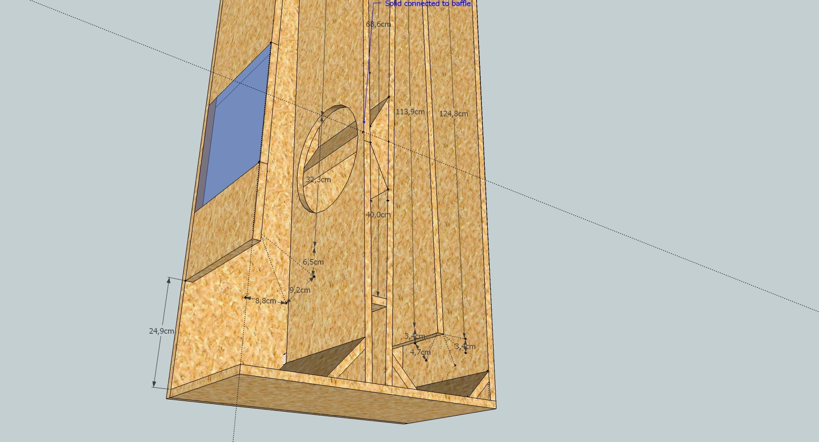

Hi TB
I had forgotten to correct that, thanks for bringing it to my attention, I don,t like the delete thing in sketchup, it delete sometimes to much and delete a little line across a panel do also delete so that it become hollow, troublesome so to speak but maybe I do now not everything about sketchup.
S4 is now correct, and I hope you do mean this if you ask for the cross sectional, I can not yet drawn a speaker in sketchup, it needs some more practice.
If I remember from long ago a frontloaded basshorn has also some like I did a wig solid connected but in that time I did not now what it was, I do see now however that box building is more complicated then build a very good amp:confused:.
regards kees

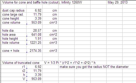

Hi kees52,
Post #4104: "...I get from your 107,2 square cm 1109.9 cc..."
For the cone plus the cutout volume I calculate 2174 cm^3 (again, that is from my guessed dimensions).
Filling the cone with rice is a good way to get the volume, provided, that you lock the cone in place.
I'll adjust my drawing to your measured dimensions, and will let you know what I would suggest.

Hi kees52,
Hi TB46
That is right I get when fill the cone complete to the edge of speaker (what is high but will compress when bold to the baffle) 1,38 liter for the speaker alone, the cutout I get 1,111 liters make a total of 2,491, (this time with proper locket cone).
when measure the cone alone I get 0,9 liters and with 1,111 liters this make 2,011 liters and so your idea,s make sense, the ring around the speaker for cut off air leaks is pretty high for this woofer and will be compressed when bold making less volume.
I go saw the baffle and make a cutout enput the woofer on, this way I get precise that what I want and I think it will be close to you guys,.
thanks for the thoughts.

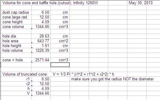

Hi kees52,
At least we are getting closer now. :) Taking your measurements of the driver I end up w/ the following:
Hi TB46
The baffle thickness and speaker seal ring is a lot thinner after tighten the bolds, ( it compresses).
Now I measure 1,8 cm wood plus 0,9 cm of speaker ring height makes total 2,7 cm. you did fill in 1,9 cm wood thickness this we don,t have in holland, here it is 1,8, 2,2, 2,5 etc.
the speaker volume is 2512 cc plus minus 50 cc (measure with rise).
regards

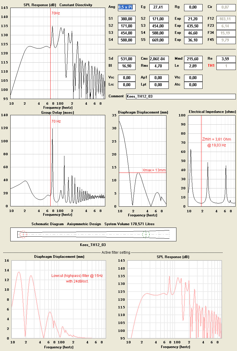

Hi Kees,
I wouldn't use the value of the external inductor to correct the speaker induction. To simulate such external inductor David has included a filter-wizzard (under tools).
In the attachment you can see an updated example of a sim with driver values as given by the manufacturer.
