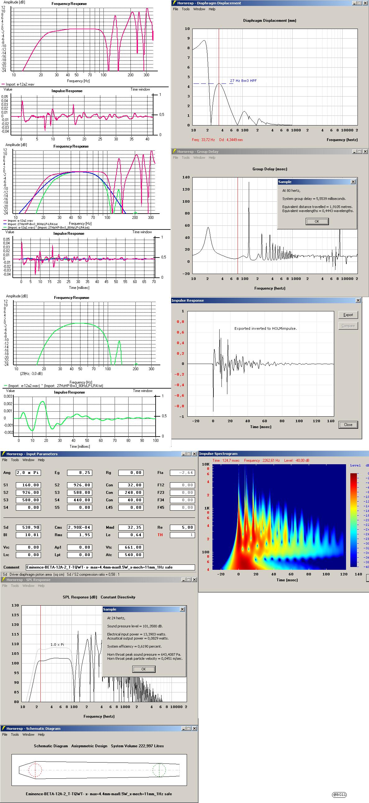

Some sims and ideas.
Then the Cross between Kappa 15A Mid bass horn and Kappa Pro LFII tapped horn looks like this.

Mr Coco kindly modelled the mid bass horn for me
Here's how it looks with a Kappa 15A on it
Horn resp schematic
Params to get that

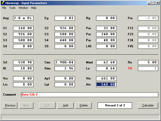

I've been researching tapped horns and folded horns and with a specific driver and a lot of hornresp simulating I just can't understand how a tapped horn is better than a traditional folded horn.
My driver is some cheap random 12" driver. The cone is a bit soft to my liking but the basket is really sturdy. The T/S parameters are
Fo/ res. freq = 24.6209 Hz
Qms = 2.9641
Qes = 0.4506
Qts = 0.3911
Vas = 270.4473 ( litr )
According to the manafacturer.
With these specs I just can't get a significantly smaller enclosure with a TH compared to a folded horn? I'd like to keep it at around 350l internal volume with extension from just under 30 to 80hz or higher.
It will be going in a "long" room, 6m x 3m x2,4m(h) if it makes a difference.
So, this is what I've come up with in a folded horn: [IMG=http://img850.imageshack.us/img850/9821/hornresp.jpg][/IMG]
And with 2pi + 2,83V
Can you make me a smaller and better one? I couldn't..
Also on tapped horns I simulated the impulse response looks horrible.. Is it just me?
