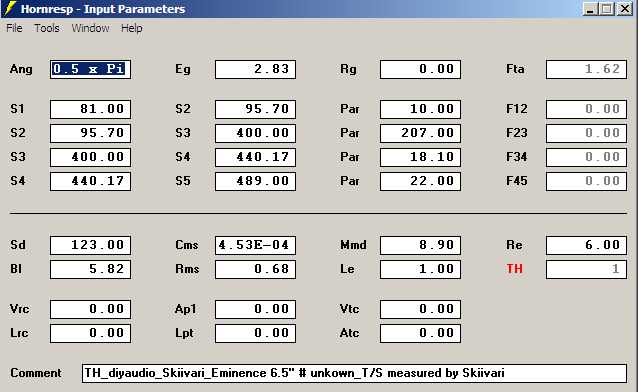

Now I got 2 eminence 6½'s from my friend. The model doesn't read on the back and It isn't any one of the newer eminence 6½'s mentioned on their site. What they most resemble is the closed basket 6½ except they have an open basket.
Specs are: (Self measured :))
Fs= 76hz
Qms= 6.77, Qes=0.82, Qts= 0.73
Sd~~ 123 sq cm
Vas with 123 sd = 9.77l
CMS=4.53E-07(?) I have used E-04 in the sims as I think the spreadsheet has it in mm or something..
It doesn't really want to go much under 37ish hz in a nicely sized enclosure. I'm fine with this. 75l seems to be a sort of optimum one.
One question: is there a problem with going up to 120hz on a sub if it's corner loaded? Don't the sound waves start getting all directional etc?
Hi Skiivari,
Your T/S values (Re=?) look reasonable in Hornresp. I end up with a 70L tapped horn.
As to the corner placement, it depends on your setup. E.g.: if you have two corners symmetrically aligned behind your main speakers, and two subwoofers the time alignment would be more of a concern than the cut-off frequency. I'd play it by ear :).

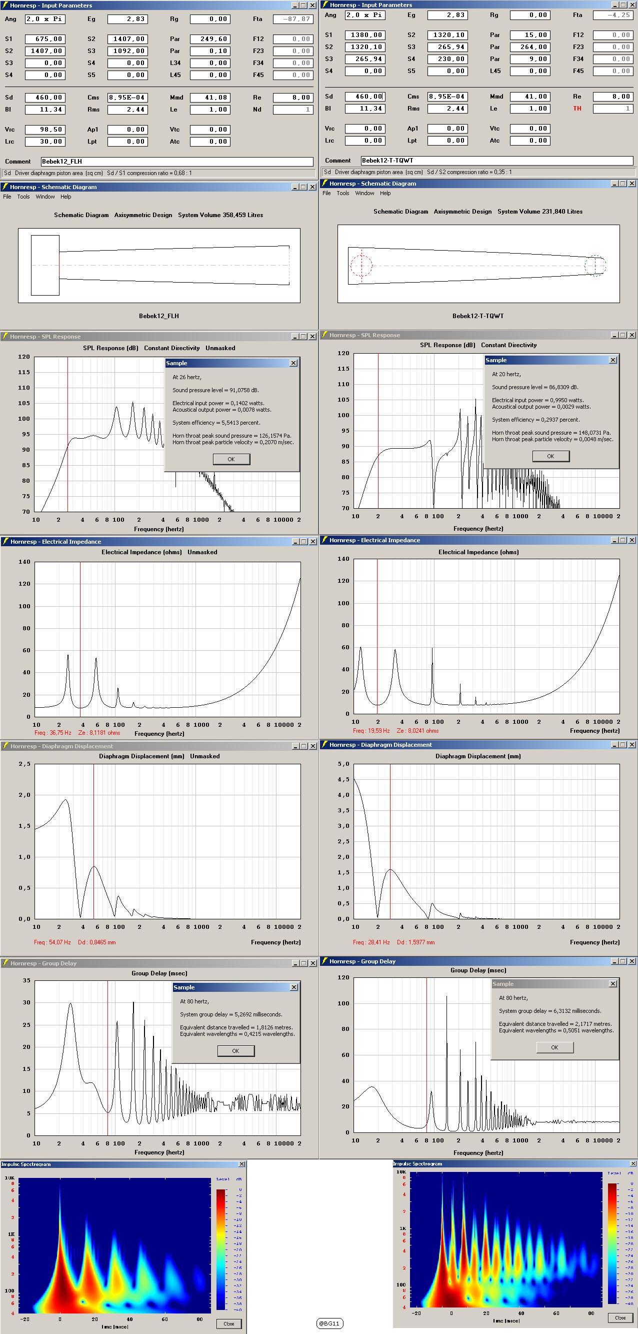

If you change your mind you could try a T-TQWT....In agreement with GM wrote in post# 3722:
b:)
PS:You mentioned earlier the IR for your FLH. Agree it looks bad. You can compare the wavelets in the submitted picture. In reality the T-TQWT uses damping materials in the path of the tapering resulting in a measured IR that would be superior to your HR FLH simulation too.

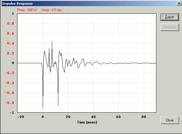

If you look at this in-room measurement of my TH driven by a 2.1 amp based on LM something used in crapola devices.
http://img263.imageshack.us/img263/9861/ircompare.png
Where is the oh so bad IR from a TH?
Compared to an ideal Q0.577 simulated with a rolloff at 30Hz
Hornresps imported IR is not far of when lowpassed the same way.
The point is that you have to low-pass the IR to get anything meaningful out of it, else you are chasing ghosts.
