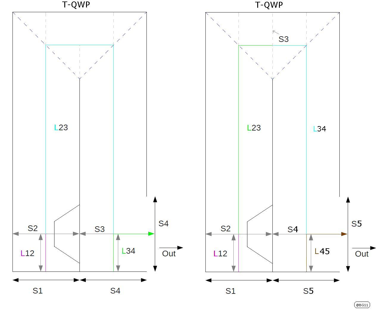

Crude drawing marked up as I understand a 3 section TH in HornResp. Going from the schematic to a "real" enclosure is my goal here. I have question regarding how to best define the distance at the horn fold.
Taking things a bit further:
What would a 4 section TH look like? Almost seems like if I had the port facing down onto the floor , the floor could take on the role as part of the horn, yes/no? S3 would be just above the driver, S4 just below the driver, S5 being the floor. L34 would be the distance between S3 and S4, while L45 would be from S4 to the floor. No sides to the flare on L45, though, that could be a problem.?

Hi There: Use S5 as the mouth, S4 where you now have S3 and then S3 can be the missing dimension. If you post the input data, there are members who will run HR and assist you. I ran your otrher posted input data, without Vrc & Lrc, with out problems, result was a strange looking horn with a corresponding strange SPL curve. Don't give up, HR take a lot of work and usually many trials to get decient curves, then you can sweat out folding and how to find room for your drivers! ...regards, Michael

Hi, I recycled your Horn.pdf and drew a new picture:
b:)

Bjorno,
post3669 has some of the label in the wrong place.
S4 (left) is not repeated on the blank end.
S5 (right) is not repeated on the blank end.
L34 (left) is not the vertical length to the bottom panel.
L45 (right) is not the vertical length to the bottom panel.
These four labels could only be correct for a TH that has the mouth in the end, not in the side.
Post #3663 and #3665

As to the a chamber between the driver and the horn throat, see P.19 of the Hornresp help file: "...Vtc and Atc can be used to specify a chamber...Ap1 and Lpt can be used to specify a port..." For a chamber in the other direction, or any other special treatments you need to move on to AkAbak.
As to the distance in your drawing Post #3663, it is just a point in the horn path. You can find any point by exporting the horn data when in the schematic diagram window.
