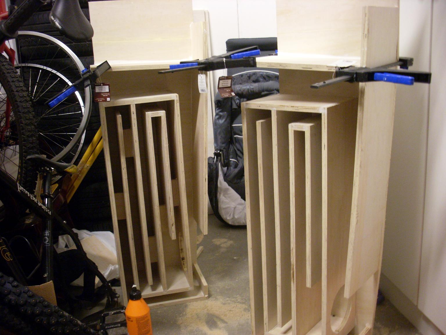

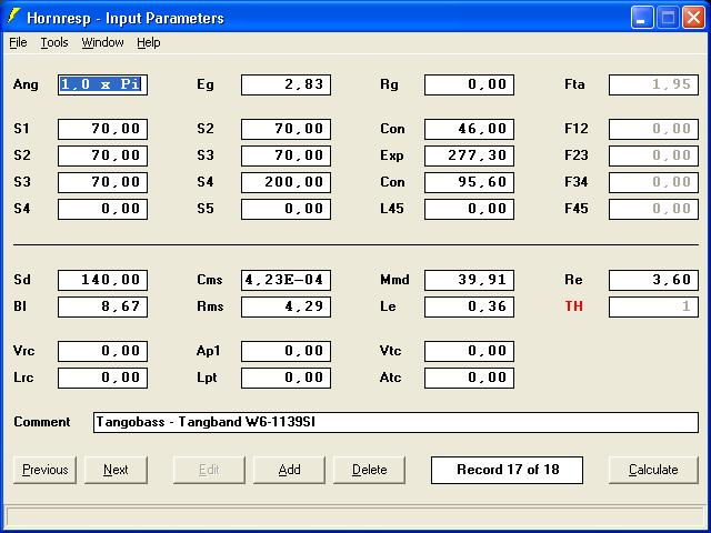

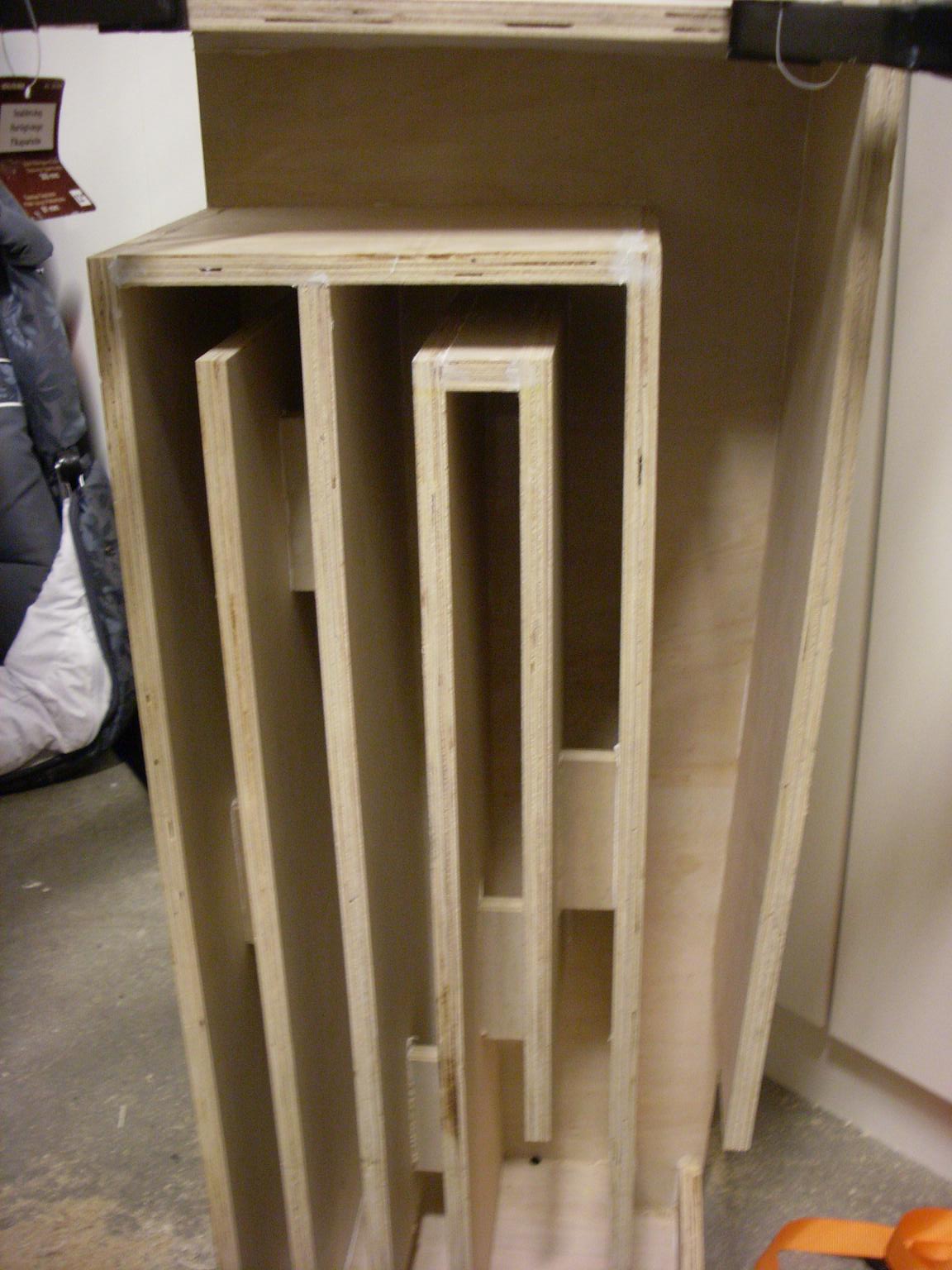

While i could only wish for Tom's expertise in this area, I still feel kinda thrilled about my slowly ongoing project here.
My first kid popped into this world the 2nd of December, so things have been going slowly since then, well, not that things went that fast to begin with, but, you know how it is.

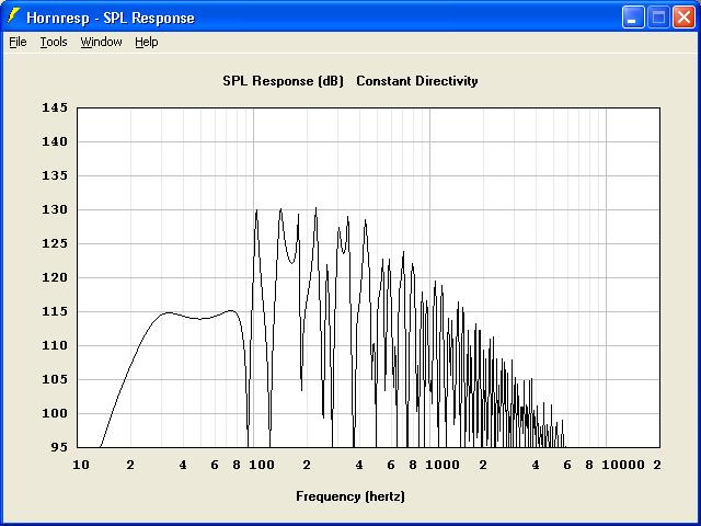

Here are some photos of the calculations and a shot of the project, how it looks so far. Now, progress is really slow, but it will be finished, someday, hopefully sometime during the next couple of weeks.
The TangoBand speakers, as I like to call them, consist of the well known Tang Band W6-1139SI, and the very promising Tang Band W5-1880. I like the fullrange sound, and I thought a small set of floorstanders with the W5-1880 would be the dogs b....... in terms of WAF and child friendliness. Overall sensitivity will probably be just under 90 db, for a two way system, xo at ~80Hz, -3db at around 20 to a bit over 20k, I hope....
Pictures so far:
Edit:
Oh, and i call them the TangoBand speaker's, 'cause it takes two to tango, and, at least on paper, these two units should tango pretty well together.

Progress is still slow, i got permission from my two bosses here to glue on another piece today, so the front for the 5" fullranger is waiting to dry now. The TangoBand's have only 4 more pieces left each until completion. Then I am going to make some brave attempt at making a decent finish.
Thing is, I twisted my skull to come up with the design for this TH, during this journey, I discovered that if you design your TH with no expansion until s3, you can, depending on the length and rate of expansion between s3 to s4, make a TH with a physically smaller size than traditional designs, but lose close to nothing in terms of efficiency, less than 1 db if you are lucky enough to get it right. If you choose to sacrifice a bit more efficiency (3-6 db total) in favor of low frequency response, you do not have to make the TH insanely large as opposed to "traditional" designs.
Sometimes size and matching of system is more important than spl and making insane things for the fun of it. This project is teaching me a little bit of moderation, it is all about compromising, either in size, low end frequency response, or spl (like Jbell says). So I am going for a family-friendly solution with the ability to play down low.
I think i did try and calculate the same type of enclosure for some different drivers, and i seem to recall that the size of s1 sq, should be close to 1/2 up to maybe 3/4 of driver area. s4 does not have to be larger than 2x driver area, usually not more than 1.5 times driver area, more than this will not really give enough benefit to justify the size increase of the system.
If I remember correctly, the ideal driver was between 0.38 and 0.42 qts, and about 180% higher fs than what you want the lowest possible frequency response to be.
I do not remember the other criteria I used for this design right now, but I am sure there are exceptions for the basic rules, as there always are.

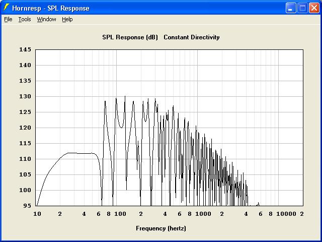

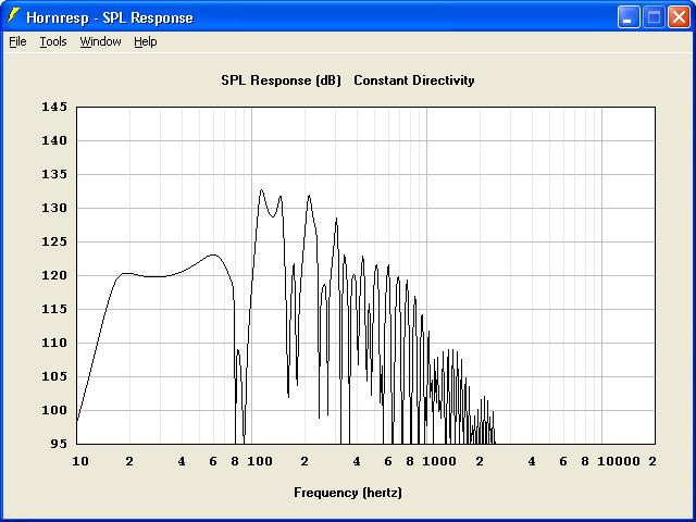

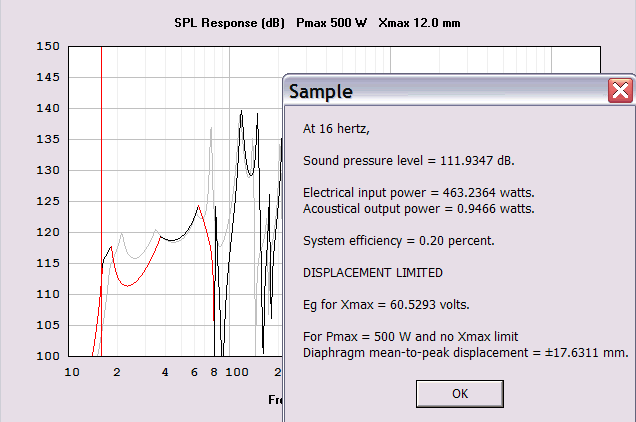

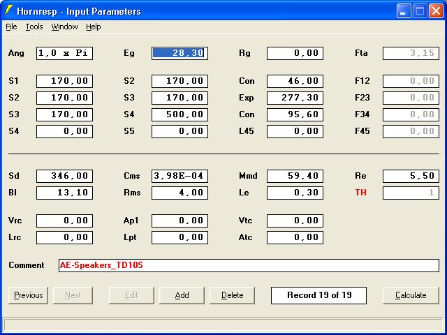

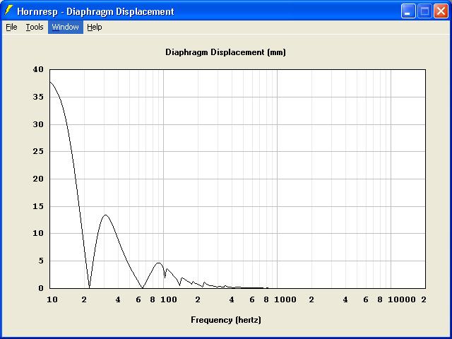

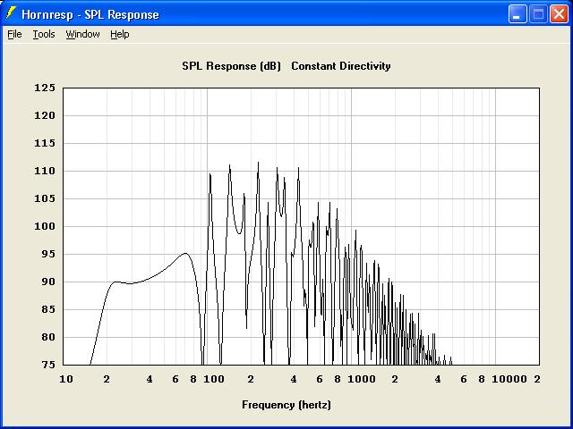

Here are some pictures of the same type of box, basically the same inputs, only slightly modified for the AE-Speakers TD10S, if you try to play around with the numbers, you can see that the lower qts causes the design to "hammock" if you try to adjust the low end response. You will have to adjust the length of s1-s2 and s3-s4 to compensate for this, an increase of s4 will give more output spl, but at the cost of "flatness" of the response curve in the lower region.
QTS value will also come into play here, if you modify the design to "push" the driver to a flatter and more low-end response, you will meet xmax faster than with a driver with more optimal data.
Nevertheless, i think the results i present are interesting for comparison, and may be of use to others.
Edit:
In theory i think this type of TH will allow for designs with even lower qts and fs drivers than previously used, if you are good with the numbers, but there is no guarantee it will measure as well as it simulates in sw.

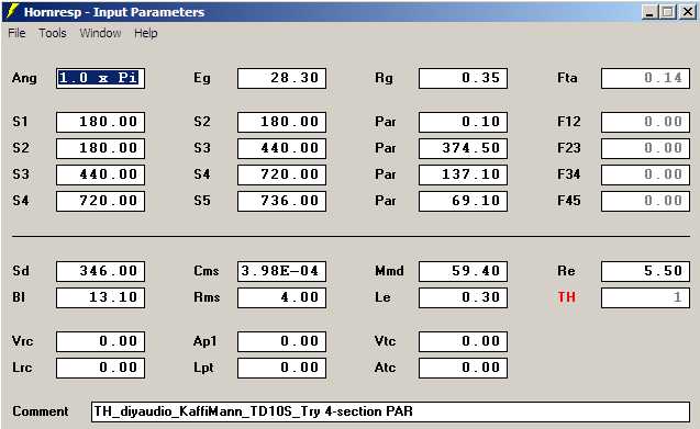

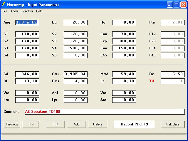

Hi KaffiMann,
Nice work, you may take a look at the example I'm attaching, it uses PAR for the taper, and all 4 sections. I like to keep L12 as short as possible, if you set it to 0.10cm you are placing the driver at the end (throat) of the horn (S1=S2).

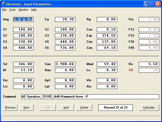

That was interesting, I had fun experimenting with this.
Looky here:
I basically took your nice figures, and just decorated the thing a bit, I'm not a big hammock fan, but if you're going to use eq's anyway why not?
Displacement is roughly the same, the numbers are exactly the same, I just pushed them around a bit.
Results are: Nearly the same performance, but in 161,709 liters! You had around 240 liters I think it was.

Did some minor adjustments to the design to better match the size and performance. see pic.

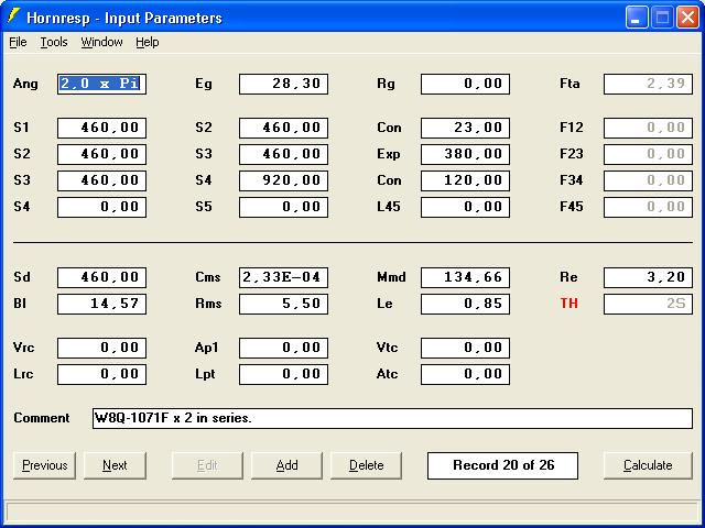

My next compromise will probably be something like this though:
2 x W8Q-1071F in series... Got low end? check! Got flat response? check! Around 108 dB at 18 Hz with 100 watts of power (ahem; 2,0 x pi)? check! And: Under 270 Liters volume.
I haven't seen anything like this about, have you? :p
Gotta polish the number a bit, but oh-do-they-look.... decent?

Check your Re values, Driver Arrangement,and excursion. This may look "Kinda" decent, or be just another example of Hoffman's Iron Law.
108 dB with 100 watts is only 88 dB one watt one meter.
28.3 V with a 3.2 ohm resistance is 250 watts, take the 88 dB down to about 85 dB.
108 dB at 18 Hz will sound about as loud as 40 dB at 1000 Hz.

1.6 Re ?
Check your Re values and Driver Arrangement, this may look "Kinda" decent, or just another example of Hoffman's Iron Law.
Ok, but i gave my data in 2,0 x pi, in 0,5 x pi i get 120 dB!
And when one driver is 3,2 ohms that means that two drivers in SERIES is 6,2! I never did my calculations in parallel! That would make me nearly exceed the power ratings for this woofer when using 28,3V!
Edit:
I meant 6,4 ohms, not 6,2, jeez i'm tired.
Edit2:
Please look at the data a bit though, i am within xmax.
