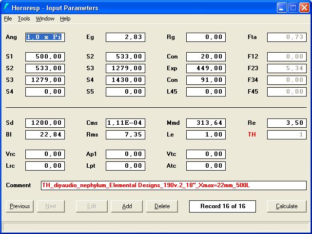

Ok, i know it can be a bit confusing to look at all those numbers, but it is really simple.
Here, I've adapted those numbers into something slightly easier. It's basically close to the very same numbers, but I've cut off one step. Now, the first number (S1) is the area of the beginning of the horn, I changed it to 500 cm2, because that means the area would have to be 50 x 10 cm, 50 cm wide, and 10cm deep. The S2 and Con fields tell you where the center of the woofer cone should be, I put in 20 cm here, as 10 cm's seems very little for a 18", it's close enough to not matter that much if it's a cm or two off, but put the cone as close as possible to the beginning of the horn.
The S2 and S3 combined with Exp, thell you where the front of the woofer meets the horn from the back of the woofer, or vice versa. Exp is the length of the horn in cm, S2 and S3 is still the area of the horn at those specific places. S3/internal width = depth. so: 1279cm2/50cm=25,58cm deep at S3.
S4 is the very end of the horn, so S3 to S4 combined with the last Con tell us how the horn should be from the woofer cone nearest the end of the horn, to the end of the horn. so it should be 91cm long, and expand from 50x25,58cm at the cone, to 50x28,6cm at the mouth of the horn.
The easiest way to know how your horn should be buildt, is to draw on a piece of paper, a figure with straight lines, the beginning would be 10mm wide, the end would be about 28,5mm wide, the length should be 560mm . You should be able to fit the complete design in a finished box measuring 52,4 x 91,4 x 144,4 cm, on a drawing this would be about 52,5 mm x 91,5 mm x 144,4 mm.
This is using 22mm thickness material of your choice, most people in the know, prefer ply on their horns, not MDF.
I tried changing the last value of con among a variety of numbers, if you get the end result within 10 cm of what you design, it should not alter the frequency response significantly.
I am a complete n00b at Tapped horns, so if anyone want to correct me, feel free to do so.

Hi KaffiMann,
Nephylum seems to just be fishing for a complete enclosure design for the "best" available driver, the 19Ov.2 being just one of many :). As you seem to be interested in the gap between theory and practice, and as I'm the one who posted the 4-section tapped horn model for nephylum in his "tuba vs taphorn?" thread as an example for a 4-section v. a 3-section model, I think I'll comment:
- Without having the actual T/S parameters we are just rolling the dice (e.g.: this driver in the model is quite sensitive to Le, and that value is not provided by the manufacturer). If the initial simulation leads to the purchase of a driver, or if one is on hand, this driver should be measured, and the model readjusted accordingly.
- When comparing models Ang/Eg should be identical.
- The 4-section model simply gives more freedom of design than the 3-section model, particularly when looking at a tapped horn that (most likely, because of the horn length) cannot be build as a simple single fold.
- L12 has a strong impact on the impulse response, and should be kept as short as possible (without negatively impacting the first dip in the passband); e.g.: (looking at the patent drawing) the DTS-20 has no L12, the driver feeds the horn directly through a coupling chamber, i.e.: S1 is S2. Another practical example is described in detail by screamerusa in his "LIVE SOUND Specific Tapped Horn thread...".
- The model should include the effects of speaker mounting and coupling, if possible, thus Ap1/Lpt/Vtc/Atc should be used (even if they don't make much of a difference). Obvioulsy, for a quick-and-dirty leave 'em out, and use the 3-section, but don't cut up a couple of sheets of baltic birch from those numbers.
- To me the model is only a starting point for an initial evaluation, which leads to a drawing, which leads to a new model, and so on until a desired degree of agreement between model and drawing has been reached. Additionally, Hornresp has the ability to export an Akabak script. This makes it easier to get started in Akabak and to refine the model beyond what is possible in Hornresp. These iterations can really cut down the failure rate.
- Then I would build a test box. For a box this size (and weight) I recommend 18mm (3/4") plywood for the box and dividers, and 12mm (1/2") for bracing between dividers. With an internal box width of 50cm (20") I would use bracing between all dividers. The pictures in the AVS forum thread on the Danley DTS-10 show an appropriate construction, looks like 3/4" baltic birch throughout. For a test box I recommend OSB.
Prior to all of the above the desired end results and usage expectations as well as the available enclosure dimensions, quantities and locations should be defined in detail.
Hello tb46 :)
Thank you for responding to my post, this certainly clarifies a few things.
I did ask if he had the opportunity to measure the thiele small parameters first, as I could not find any info on that myself. If the only issue is the Le of the driver, this can easily be increased to match the horn better, lowering it may be a different issue.
On the plans i have seen laying about, of other designs, the S2 value has been marked just before the cap of the cone, this is why I suggested 20 centimeters instead of 10. At any rate, i told him to put the woofer as close to the beginning as possible, I also tried changing these values to see if they make too much of a difference, as I always do.
I do not see any reason to use 4 sections in modelling a tapped horn like this, i see very little or no difference in the number of sections modelled, if the expansion is constant. If you change the expansion however, there is a difference. As I see it, you can make any number of folds you want, as long as you stay true to where the air from the beginning of the horn, meets the air moved by the other side of the cone, and keep the distance from the woofer to the mouth as planned. You will probably loose some efficiency, but the frequency response should be the same. All double folded tapped horn calculations would be completely useless in hornresp if you where to depend on the number of parts you can have in the program. There will be too many bends to do them justice anyway.
I may have picked up things the wrong way here, but feel free to comment. This is a forum after all :)

S2 is where the center of the driver or tap is located in relation to the horns path.
In order to build a TH properly you need to use all 4 sections, as you must set the flare rate for the sections before, and after the rear tap independently for the best response. See the patent app. If you are just after a simple TP, then you don't have to worry about it.
Ah, I see. But in Volvotreter's and Cowan's designs they did not pay any attention to that, how much does it really affect the end result?
S2 is a lot of places defined as the distance from cone to throat, I have always calculated it as near center of cone to throat, thank you for confirming this. It seems my 20 cm calculation on the 18" was a good assumption.
Best regards.

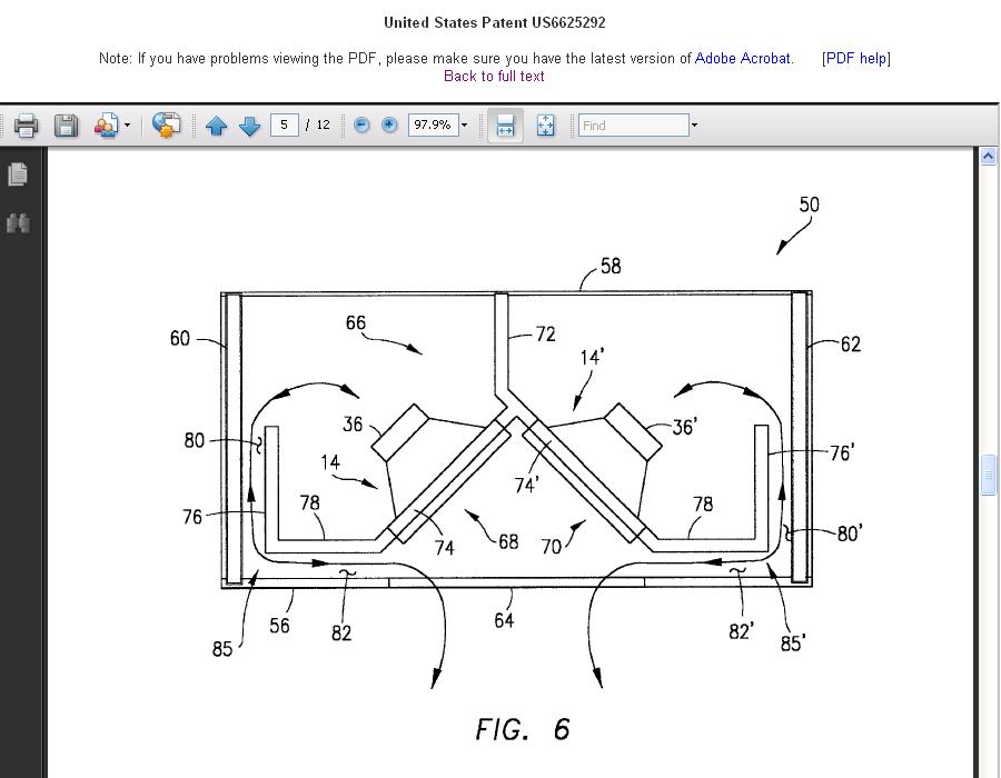

It looks like JL Audio discovered the tapped horn, and patented it:
Ported loudspeaker enclosure
Ahhh ha ha ha ha ha....... gotta love that.
I'd say from the look of the double... that the cubo is definitely off limits.... This looks to be more hybrid than tapped, but the concepts are still the same. Wonder how DSL will deal with this?
So... no more cubo's.... or hybrid reflex/short horns -- those are patent infringing..... and have been since 2003....
