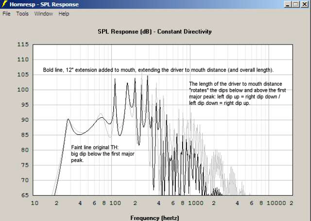

As littlemike pointed out before (Post #3164) extending the driver to mouth distance reduces the dip in front of the first major peak, actually it influences both dips around the first peak. It would be relatively easy to experiment with a mouth (port) extension, e.g.: in the attached SPL graph I added 12" to your existing horn. Obviously, this is only an example, and as you pointed out in Post #3166 sooner or later it will create other problems.
Anyway, it looks like you're quite close. Thanks for the information.

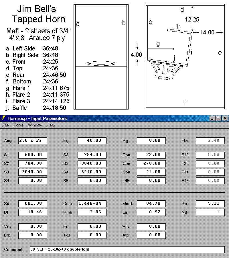

sketch
http://img148.imageshack.us/img148/5483/ithroughsketch.gif
Karlson 15 with Audio Nirvana 10 vs inverted tapped horn wiht 295070
http://img135.imageshack.us/img135/8307/k15nirvanavsith295070.gif

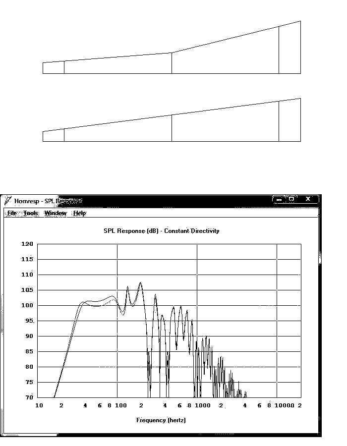

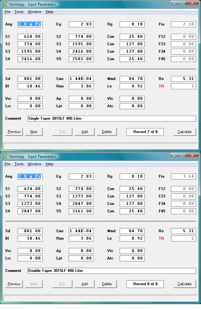

Is there an advantage to having more than one taper in a Tapped Horn? Of course there is!
As iand said earlier, making the middle smaller will allow the mouth to be larger.
Attached is the input screens for two horns that have the same lengths, same S2, and the
same total volume.
