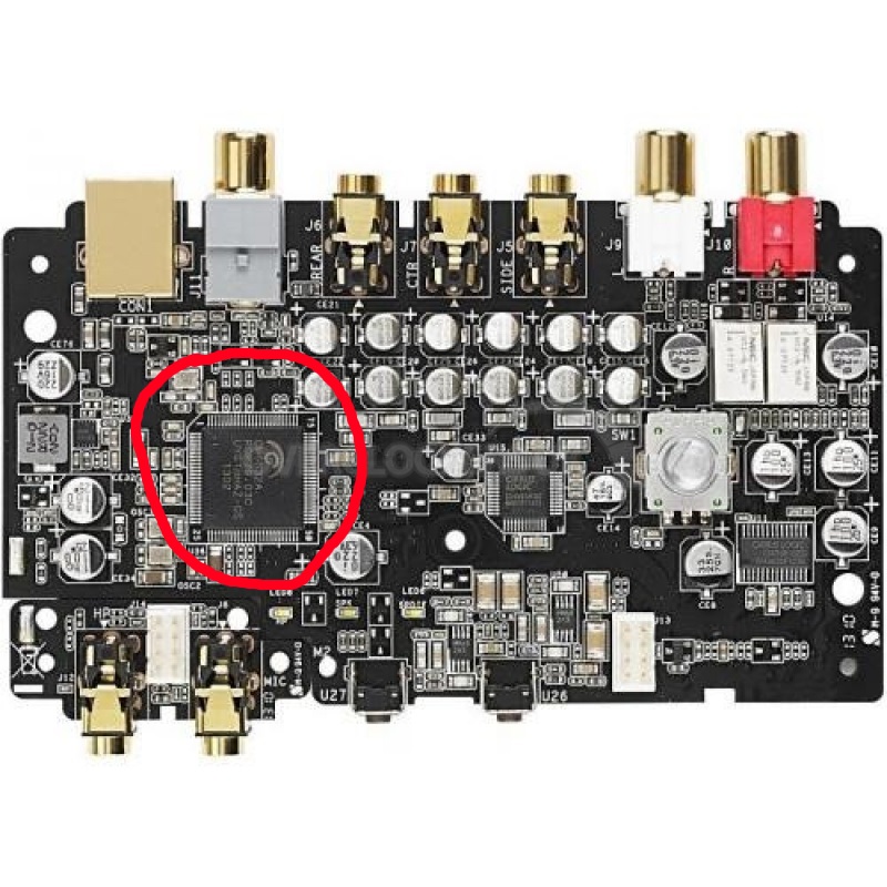

It should not work. Because ASUS U7 has special version driver for it. It has some customize feature like output switch, software volume, input switch ... etc. More important is ASUS U7 has some audio effect on it. If driver identify the chip is not U7 the driver shall not start or can not install.
What do you think, if try to install the driver from the ACS U7, it also has 6632 with memory, like additional chips identifying the U7 is not visible on the board. What do the drivers think?

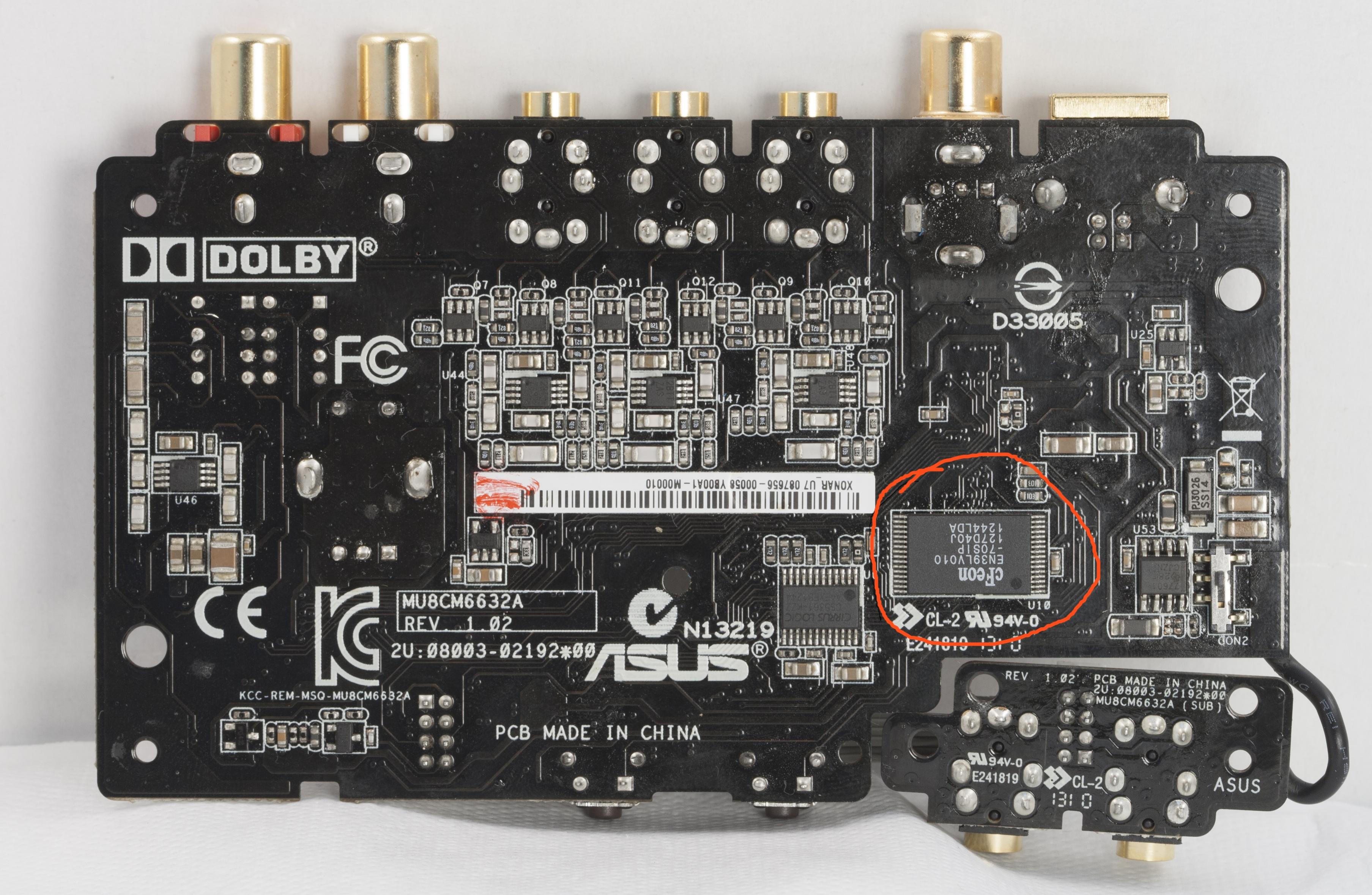

For firmware you do not need I2C EEPROM. It use parallel flash memory to store firmware. In Open source SDK it do not access I2C EEPROM. it is not necessary.
Tdtsai, on some cards, specifically DACs, apart from flash memory I have seen an extra eeprom small i2c chip. Is this eeprom necessary in basic configuration, using shared open source SDK?

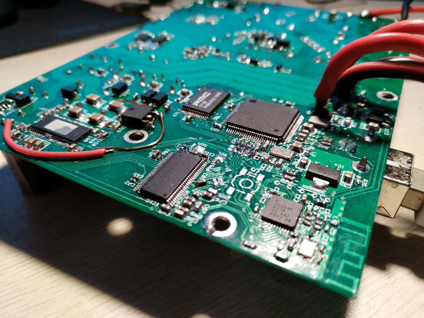

Did you build this? How is it that you have left the microcontroller connected to the I2C out from the design?

neptunes4you, yes I did, see attached pic. There is a slightly different project (tas5558+tas5624+LLC SMPS +BLE IOS/Android app control, PCBA 139x100x27mm) but due to low impedance GND plane, 6631A works stable even being close to hard switching nodes of class D stage.
Super cool! And i assume you have uploaded the firmware with the CMEDIA firmware tool right?
No, all those tools, I've got from the current thread, I don't remember the page yet, pls try to use search.
Yes, i think we are talking about the same apps. One is a firmware generator, and the other one is the firmware uploader.
