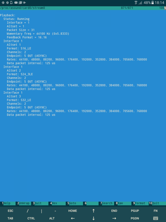

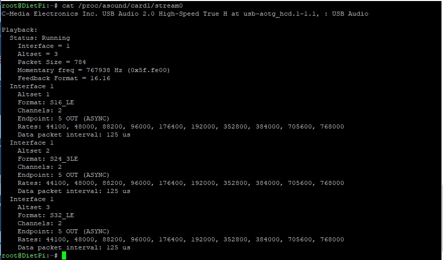

The UAC class is selectable and it can support following sampling rates:
UAC 2.0:
UAC 1.0:
The last one is supported even on Windows XP without any additional drivers.

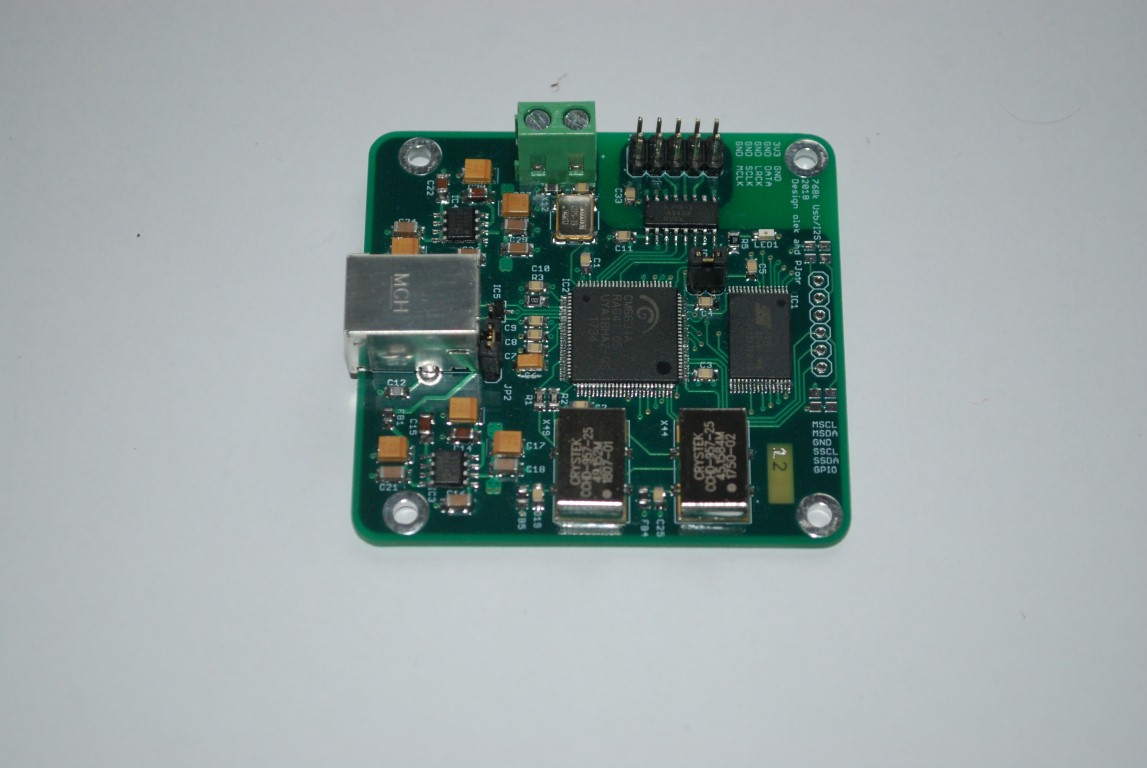

Here is my version CM6631A :)
Design based on small 4 layer pcb.
On the board we have voltage regulator ADM7150 x2,
Crystek Oscillators CCHD-957 45/49MHz and isolator NVE IL715
Firmware compiled from scratch using tdtsai's SDK.
Works like a charm on linux, W7 -W10
It can play PCM up to 768kHz (in downsample/2 mode) and DSD DoP DSD64 and DSD128.
Thank You tdtsai!
I have few pcbs for this project.
UAC 2.0:
UAC 1.0:

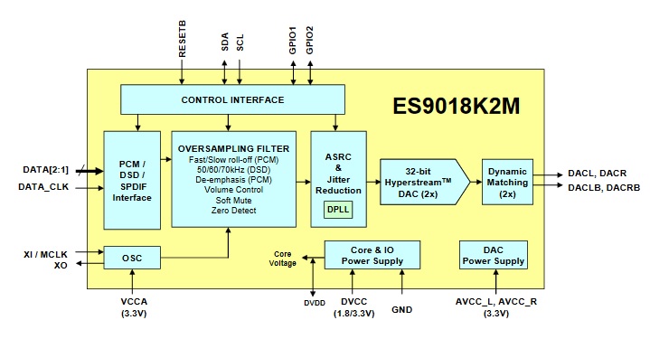

The DAC chip i used on this one is ES9018K2M which is DSD capable.
USB => CM6631-A => ES9018K2M via I2S
It sounds like I am missing something in between from your post? correct?

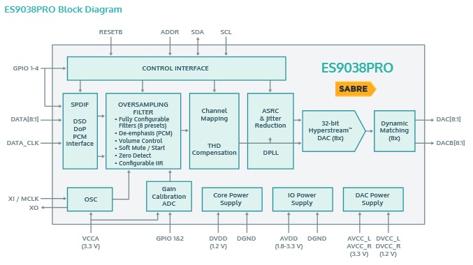

Look at the documentation and check if the DoP is supported by ES9018K2M, in my opinion not...
See the comparision ES9018K2M and ES9038pro.
