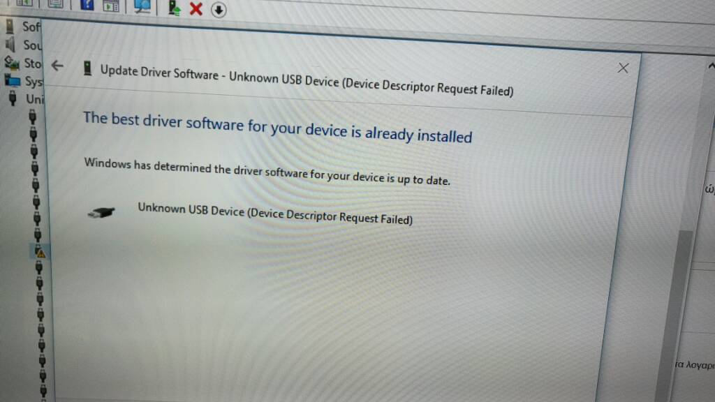

I tried 2 more pc but the same. Just arrived and trying to connect it. I will contact with the support and will see.... ThanksHave you tried this device on another computer? Haven you been using it before?
Try to contact the manufacturer or the people you bought it from.

If you see this it's means you device is damage. System can not recognize this USB device. It is not a driver issue. You should contact you provider.

I have put this driver for the first time. Maybe something wrong with the device or with the usb power or with some ground connection or I don't know what else... View attachment 598788

I think that is the conclusion of this board. I am waiting for a new one in a few days and we will see. Thanks.I tried 2 more pc but the same. Just arrived and trying to connect it. I will contact with the support and will see.... Thanks
