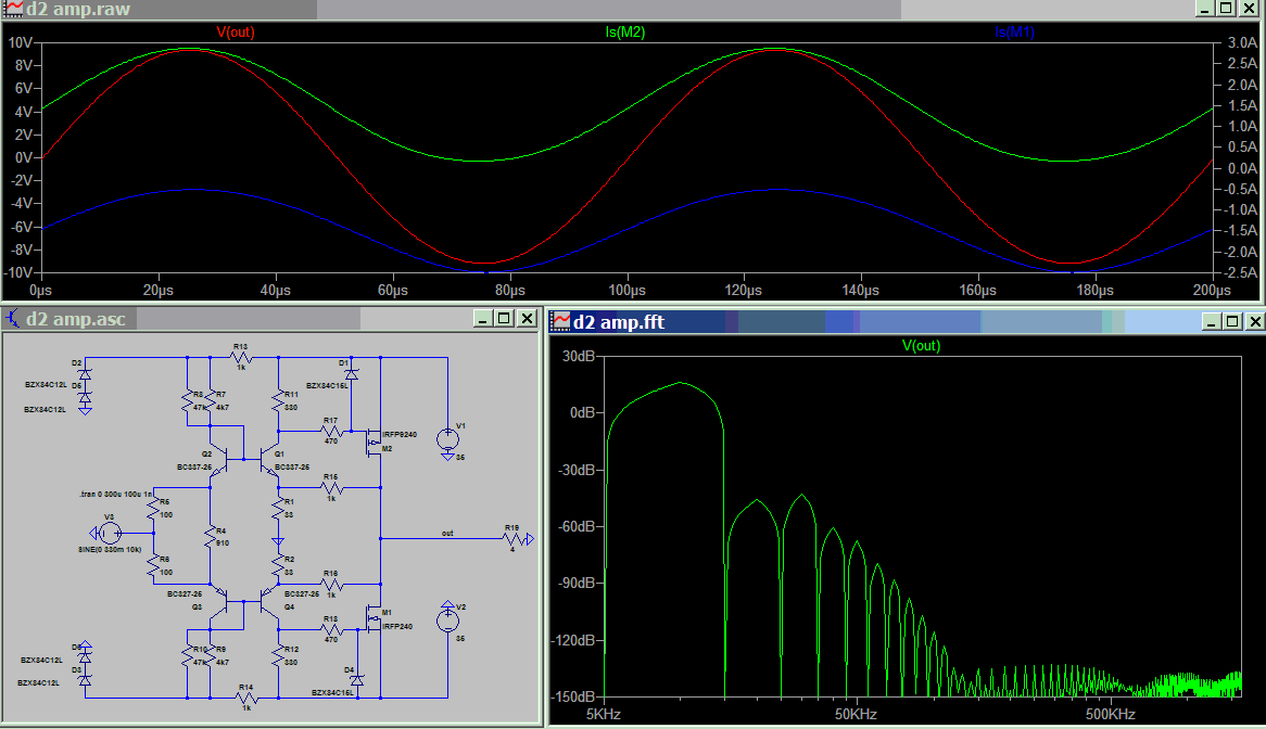

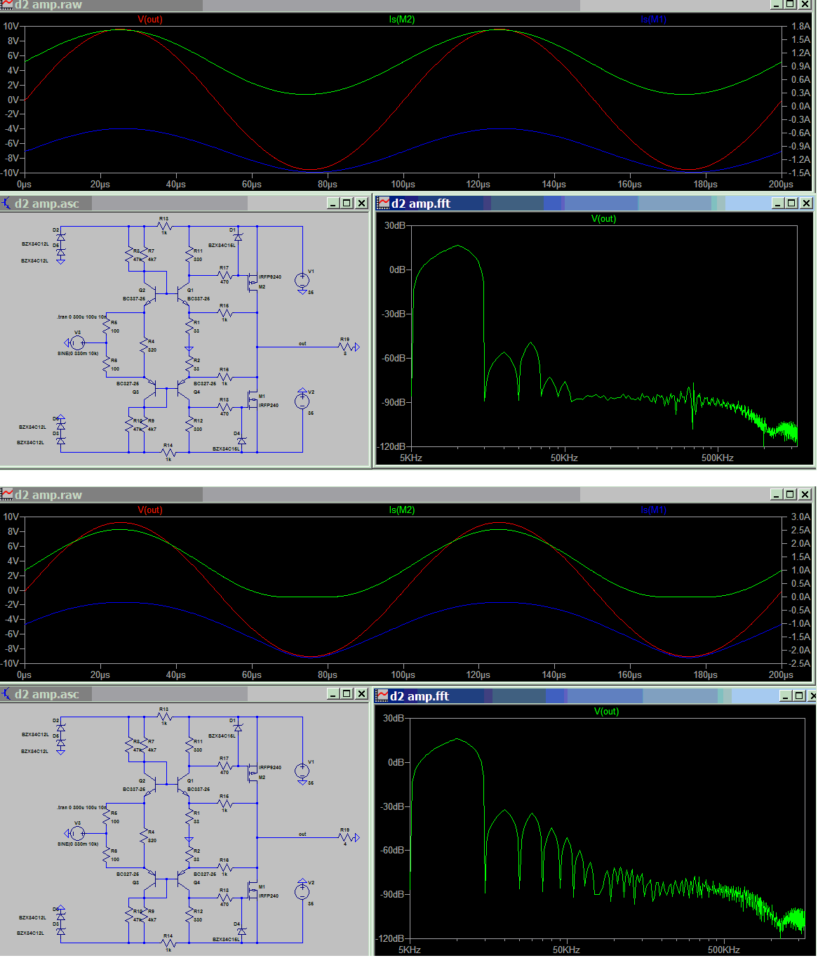

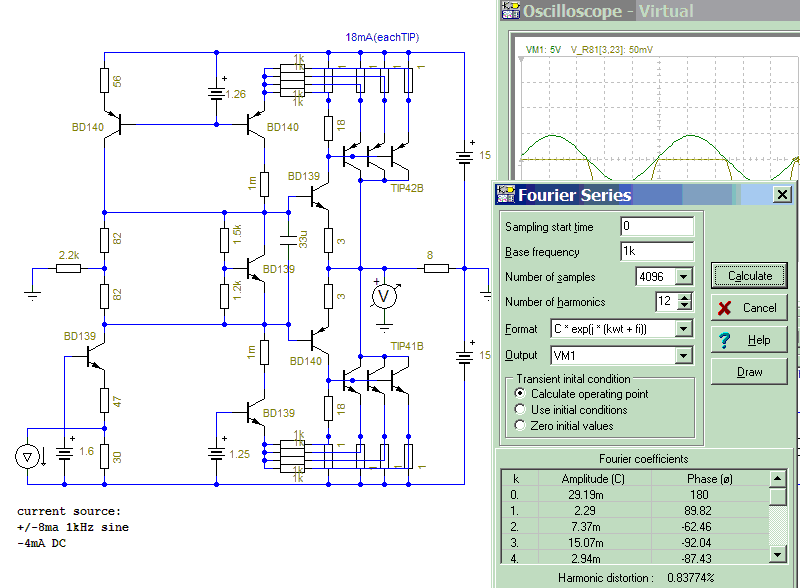

There is still huge crossover distortion from that square law application (hegglun sch) even for 200mA bias. The most effective is Candy's style that added drop voltages to input plus remaining drop voltages to input again.
Is there any explanation why square law not perform so good in linear audio vol1?
About Kenpeter, he using current based negative feedback similar with this: http://www.diyaudio.com/forums/atta...roject-bjt-classb-buffering-bjt-se-classa.png
http://www.diyaudio.com/forums/atta...ass-hybrid-power-dac-project-60w-tripleef.png
but with schottky nonlinearity.

I could make AB2+XM or my original XM to not doing switch at all for all freq up to 2ohm load working at smooth current curves with biasing the storage, the result must be much better efficiency compared to that square law, because dynamic biasing depend on freq and load, but it is not necessary I think. Sound quality is one most important and 0.005% THD is enough to get its clarity.
Is there any listening comparison between square-law and original classA?

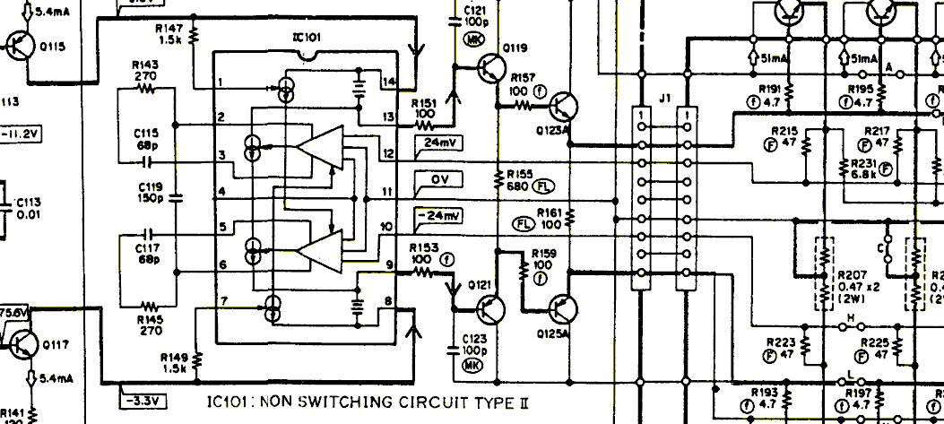

Here is pioneer non switching circuit Type 1, this was used in more than 50 models of their amps between 1975 to 1990, Type 2 was improvement on this scheme but I havent been able to locate its patent as yet.
Looks like type I is all non switching transistors, but this type may degrade some error correcting results (non switching but higher drop voltage).
From that type II IC picture, it is similar with nakayama's circuit. It has current sense and three inputs of differential amplifier.
NCS-II = PA0016
[snip]
Hi, Edmond, can't it modified to something that not need transistor matching? Because pioneer that uses special IC also sometimes one channel perform right, and other channel just worse.
Pioneer has 204mA bias.
Hi ontoaba,
If you want to repair the bad channel, just buy that chip: Pioneer Electronics (USA) Inc. Parts & Accessories Online - Part Number: PA0016 Information ,
because it's almost impossible to copy it by means of discrete trannies.
BTW1,maybe other components are also defective.
BTW2, the PA0016 is pretty expensive.
>204mA bias ?
According to the schematic on page .. it's 51mA per OP tranny.
