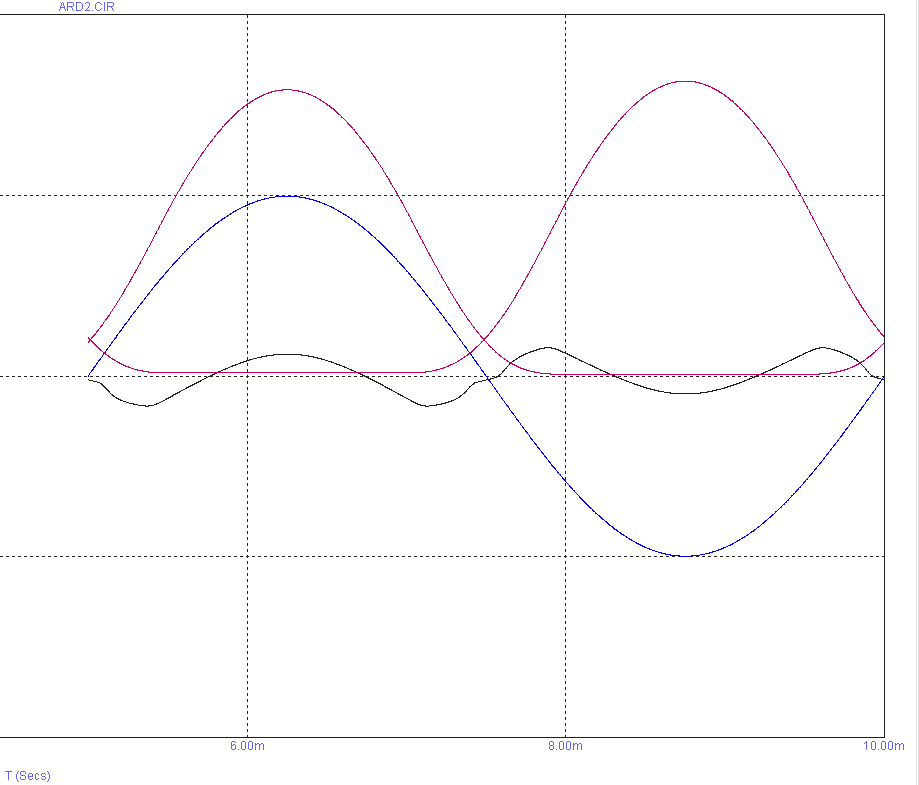

I got almost the same DC currents, though THD figures were not encouraging. With several loads from 4 to 32 Ohms, in all cases the distortion gets worse when the error cancellation circuit is enabled.

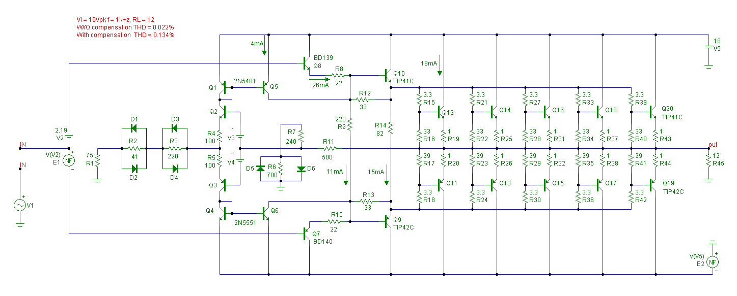

Below some pics:
1. Schematic, Vout = 10V, f = 1kHz, RL = 12 Ohms

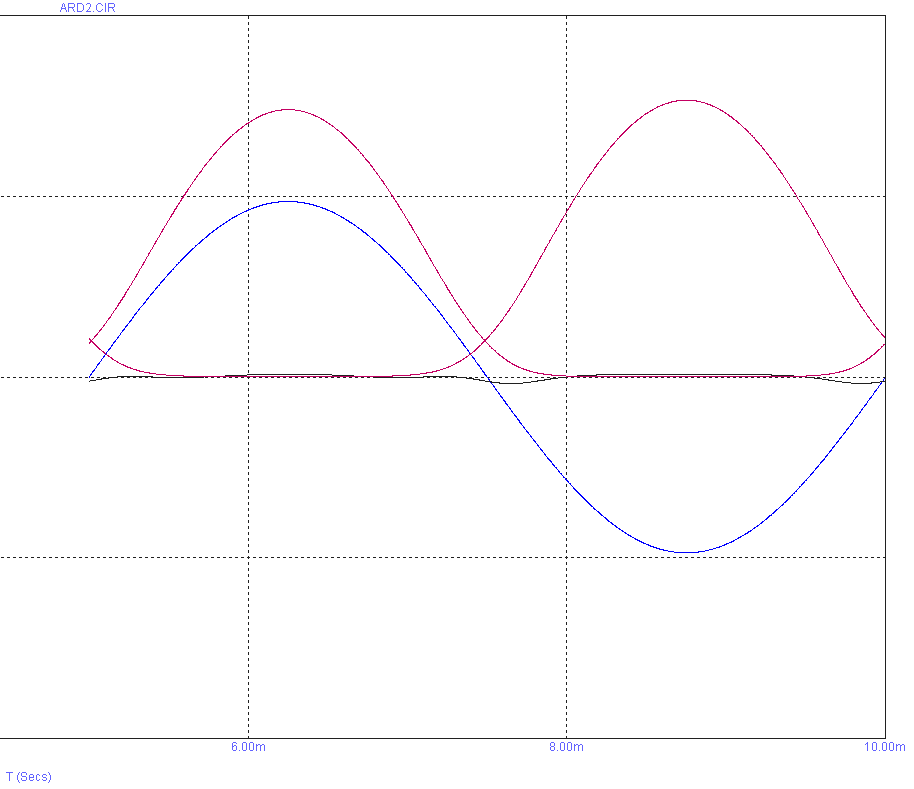

2. Some signals with cancellation circuit disabled. THD = 0.022%
3. Some signals with cancellation circuit enabled. THD = 0.134%
Blue = Vout
Red = emitter current output devices.

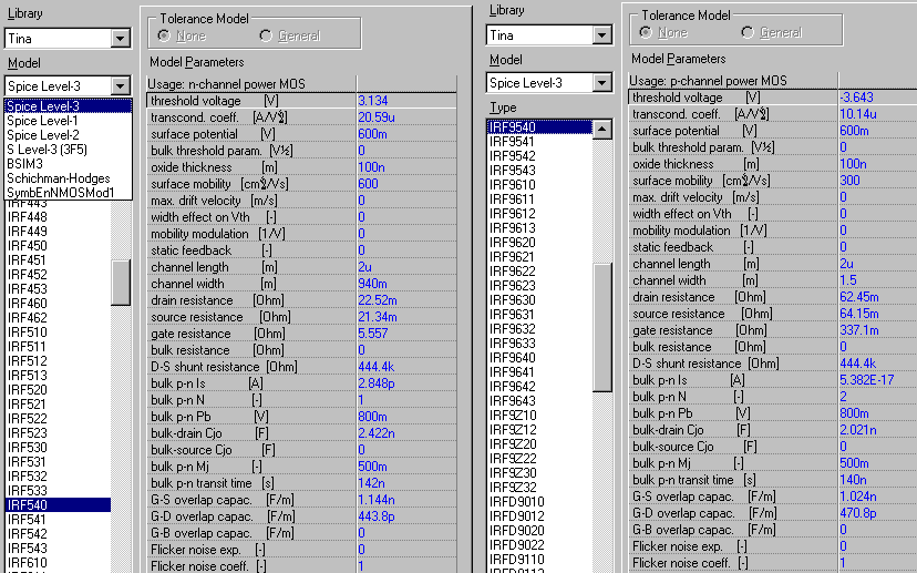

It need to be tweaked until drop voltage closest to sinewave. May be there is some differences in models, like 1N4148.
tina 4148: IS=1n, N=1.7, VJ=750m, MJ=330m, EG=1.11
@padamiecki
It is attached, but using spice level 3. A bit and more different, with level 1 that used in LTspice, but it is more accurate.
