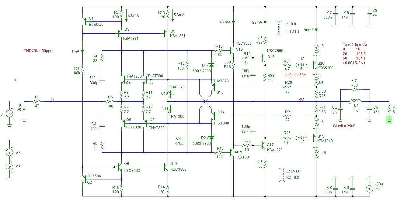

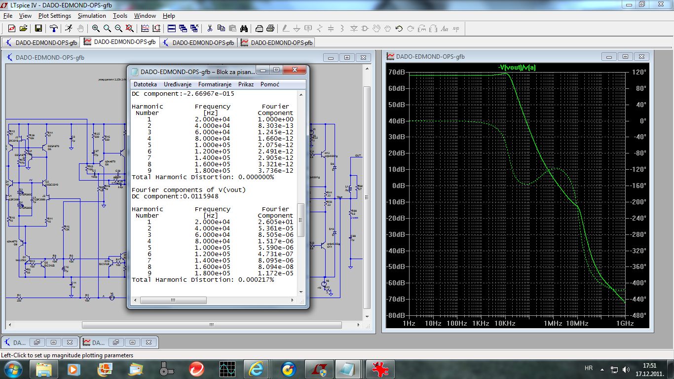

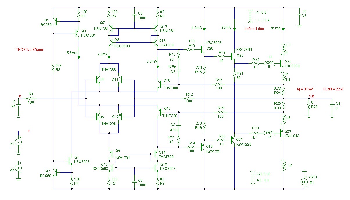

Here is quick simulation of an amp with Edmond non switching auto bias OPS.
I appreciate comments and suggestions, specially VAS improvements.
Thanks to Edmond Stuart who is author of this excellent output stage.
I will try to simulate the same IPS with Class i OPS next.
Damir

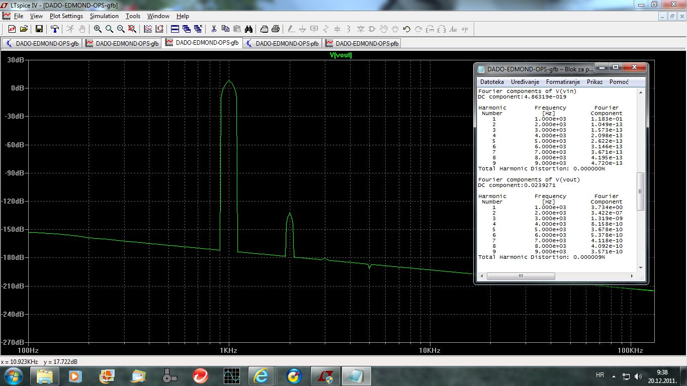

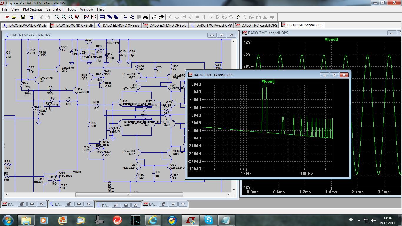

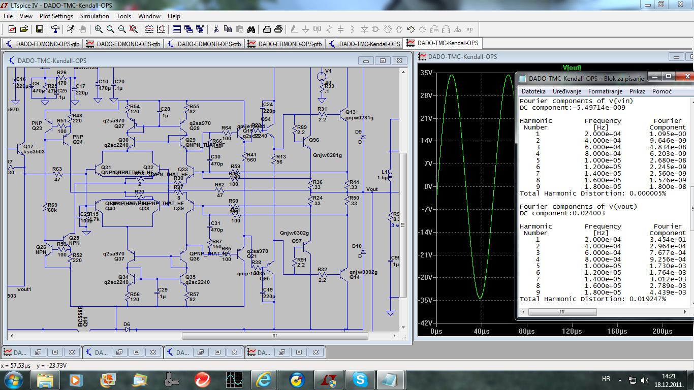

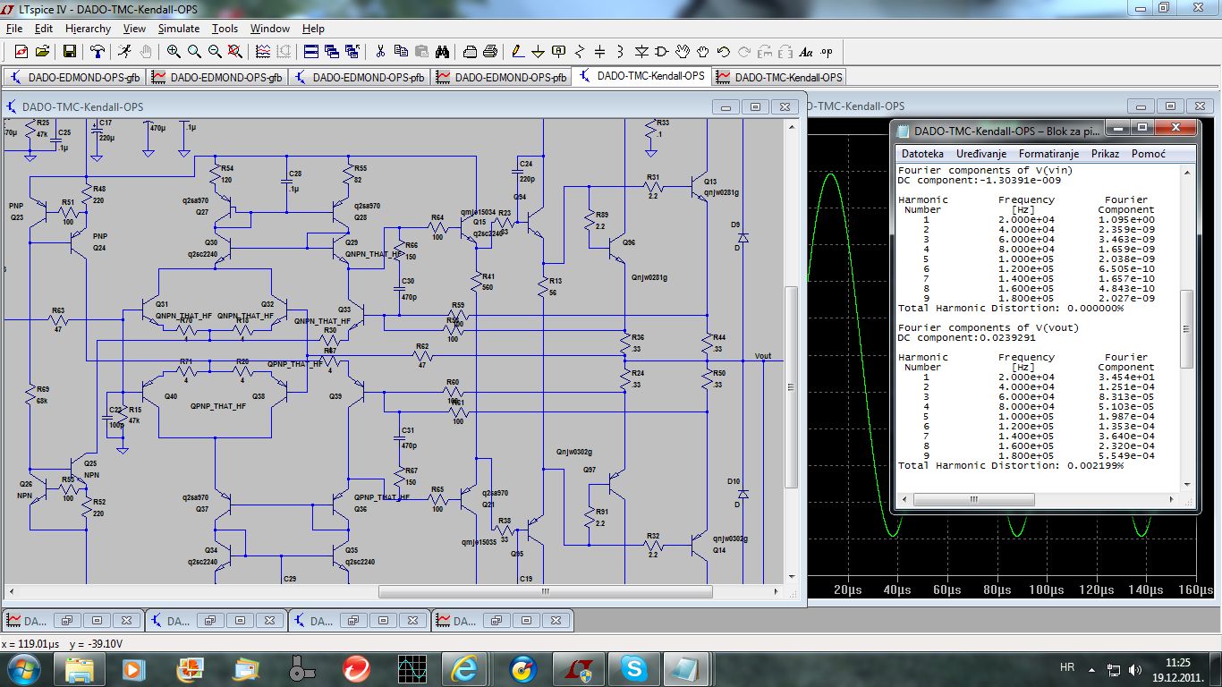

Class-i OPS
And now I simulated almost the same IPS connected to the Class i OPS.
Distortion is higher then with Edmond OPS, but it could be improved with better( I suppose) VAS as input resistance of the Class i OPS is highly non linear.
Damir

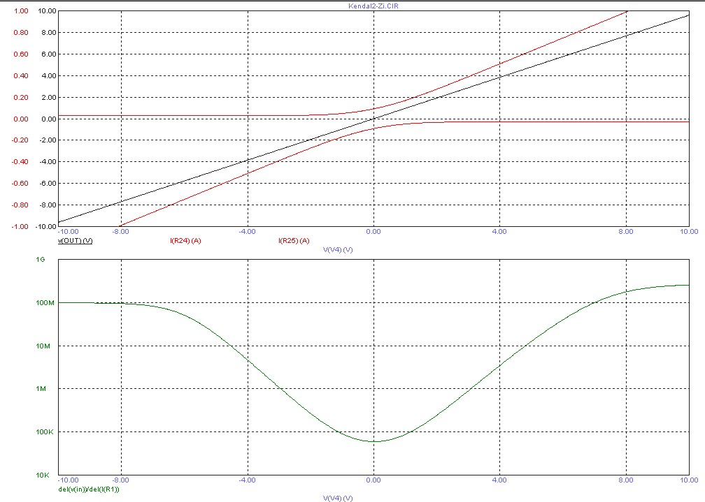

Hi Damir,
Indeed, the input impedance is highly nonlinear. Most likely, that's the cause of much more distortion. See below for the test circuit and its Zi as of function of the output voltage (Actually, it's the output current that alters Zi). Zi varies from 60kOhms to tens of MOhms.
Why improve the VAS (i.e. lower Zo of the VAS) to compensate for deficiencies of the Class-I OPS? Isn't it a waste of time time, as the OPS itself can easily be improved (by means of my AB2 OPS, as shown in your previous post)?
In the next few days, I will show that the nonlinear Zi of class-I is not the only downside of this OPS.
E.

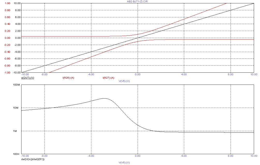

Autobias-II (AB2)
And here for the sake of comparison, the input impedance of the AB2 OPS:
Now, Zi varies between say 1 to 10 MOhms. Needless to say that this variation has far less impact on the distortion, as a typical VAS has far less difficult to handle such a variable load.
edit: Zi simmed at the DC level. Above 10kHz it drops considerably (of course).
See for more info on geometric mean biasing: http://home.tiscali.nl/data.odyssey/AutoBias_II.html
E.

Lower distortion with Class-i OPS.
Separate emitter resistors in Class.i input transistors lowered distortion but it is still ten times worst then with Edmond AB2 OPS. Not sure yet how this change influences thermal stability.
Damir

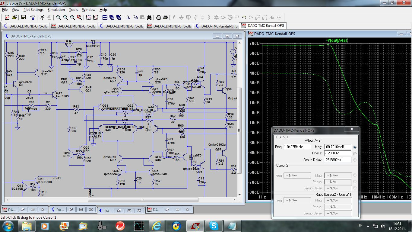

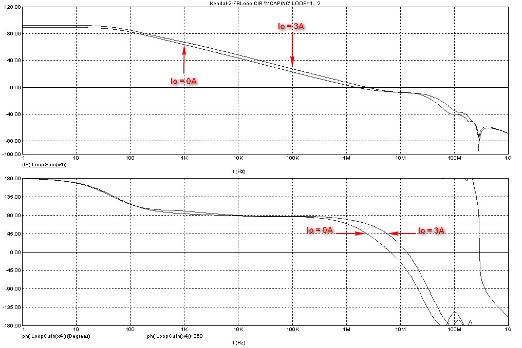

Class-I NFB-loop
Now, let's have a look at the NFB loop inside Kendall's Class-I output stage.
In fact here three FB paths: one directly from the output, which is a bit positive (-6dB) and two from the sense resistors, which provide the main and negative FB. At larger output currents, say above 250mA, only one of them is active (either from the top RE or the bottom RE). As a result, the phase and amplitude response of the FB loop depends on the output current. See the graph below.
At idle or low output power conditions:
PM = 60 deg @ 1.5MHz
GM = 6.8dB @ 6.5MHz
And at high output power conditions:
PM = 69 deg @ 2.4MHz
GM = 8.3dB @ 13MHz
I'm not really happy with this variability, as you can't optimize the FB loop for any condition (for small and large signals). In practice this means that you have to tailor the frequency compensation for worst case conditions, that is, at high output currents, as in that case the ULGF is highest. But then the small signal compensation is suboptimal.
BTW, the AB2-OPS doesn't exhibit these quirks.
E.

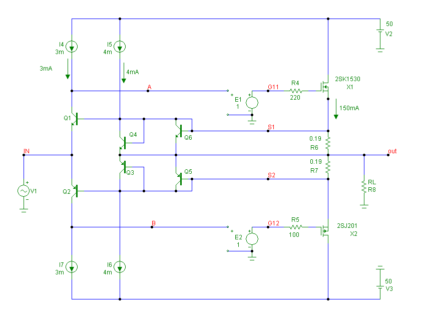

Hi Edmond
Basic Auto Bias circuit (Fig.1 in http://home.tiscali.nl/data.odyssey/AutoBias_II.html) has an in-out offset equal to difference between Vbe of pnp and npn transistors. Let me suggest some changes which cannot affect overall work of the circuit.
1.Disconnect collectors of Q5 and Q6 from Out.
2.Connect collectors of Q5 and Q6 to their bases.
We have four transistors connected as diodes. Now negligible I5 and I6 flow thru R1 and R2.
3.Interchange Q3 with Q4 and Q5 with Q6. Now we have diodes on the same places but no offset.
Cheers
Mir

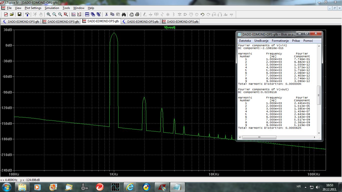

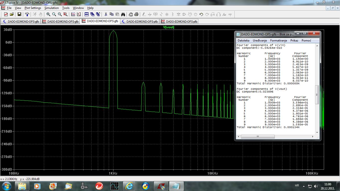

AB2 OPS
The FFT at 1kHz shows perfect harmonics distribution up to almost full power.
First one is 1W//8ohm, second one 35W//8ohm and last one 81W//8ohm.
Even at 80W distortion is 1.34ppm.
Damir

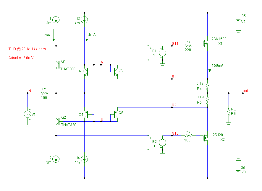

AB-II and siblings
Hi Edmond
No. I mean emitters of Q6 and Q5 connected to S1 and S2, not collectors.
I'm sorry that being a beginner I don't know how to draw and so have to use stiff words instead.
Cheers
Mir

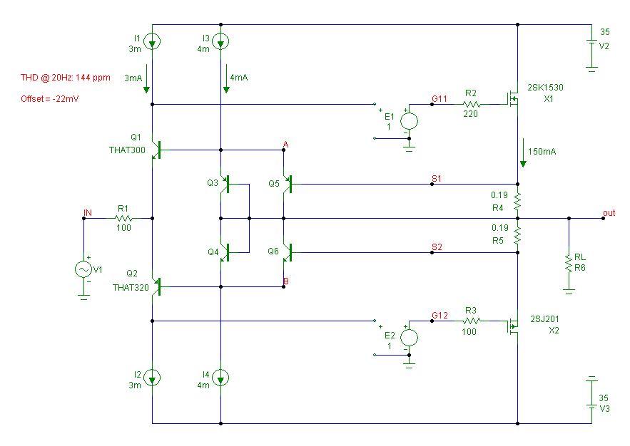

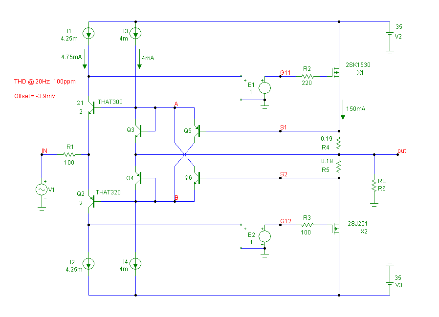

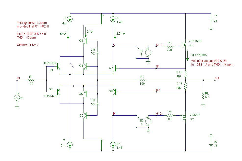

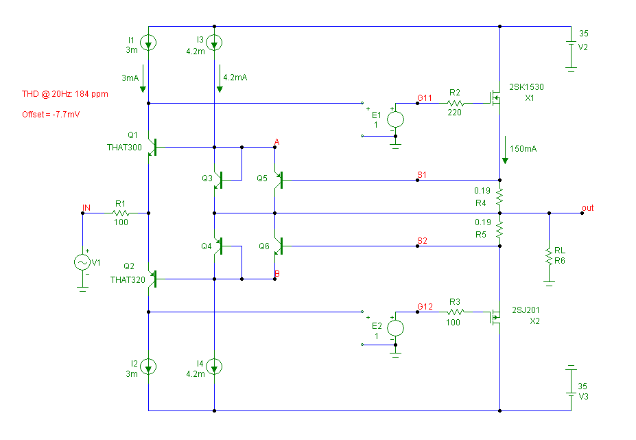

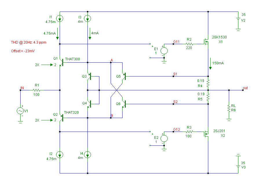

Hi Mir,
Thanks, now I got it. I'm glad you brought this up as I was already waiting for a good opportunity the discuss possible variations on AB-II.
Below you see a number of alternative circuits together with Kendall's Class-I OPS.
The first circuit is the same as in my website. This one is non-optimal and only meant to illustrate the basic principle. The distortion, even at 20Hz, is a bit high: 144 ppm, and the offset is -22mV.
In the second circuit, where the polarity of Q3 and Q4 has been interchanged, the offset dropped to -7.7mV, but the distortion is even higher: 184 ppm.
In the third circuit, that what you meant, right?, also the polarity of Q5 and Q6 has been interchanged. The offset dropped even further: to -2.6mV. (It would be zero in absence of a input current offset.) THD is the same as in Fig.1.

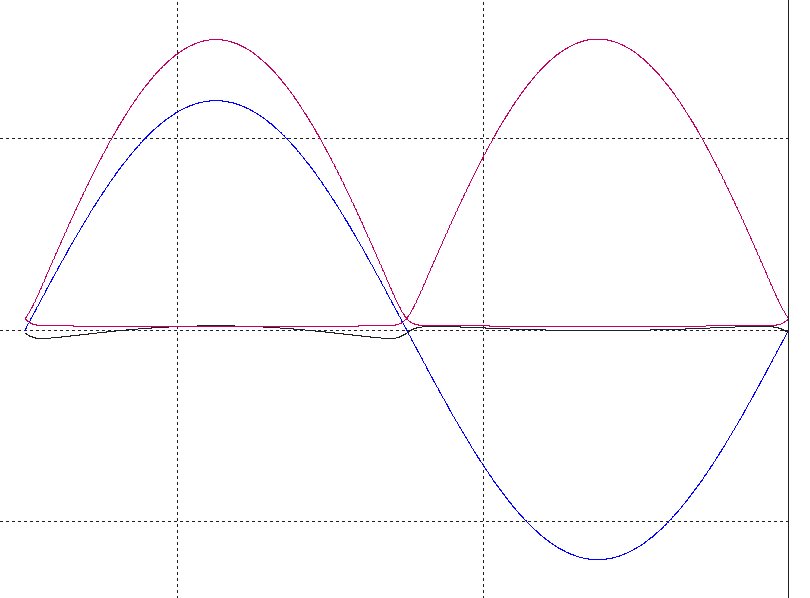

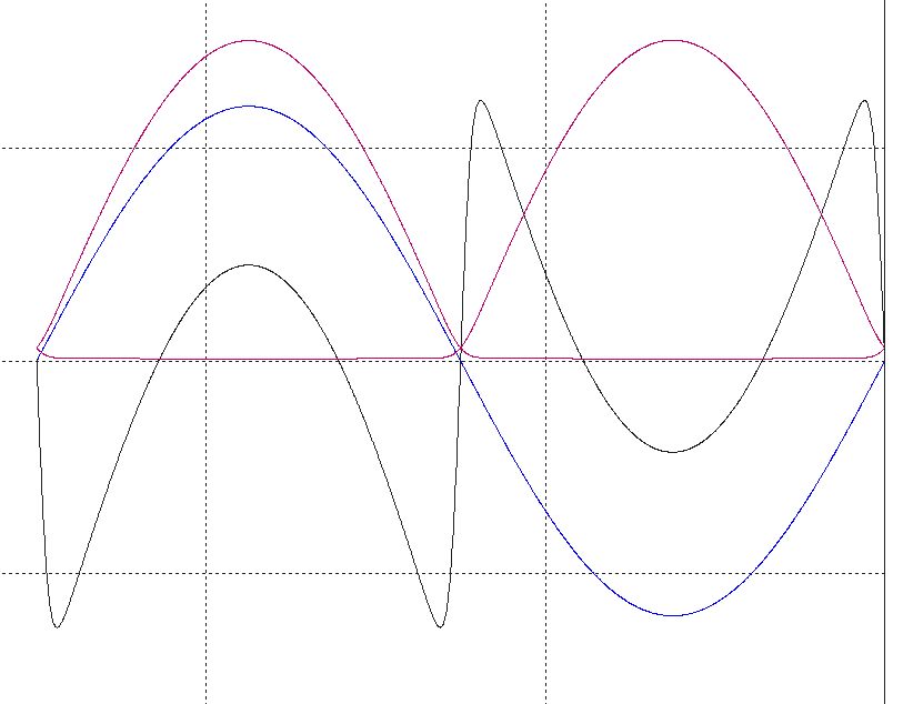

The first three circuits suffer from the same thing: switching currents from Q5 & Q6, which are not canceled out. The effect is clearly illustrated in fig.7: the black curve, which shows the distortion residual.
This effect can be eliminated by crosswise connecting the collectors of Q5 & Q6 to the node A respectively B. Now the THD dropped to 4.3 ppm. That's nice, but the offset voltage is back. BTW, this is a non-issue if the OPS is embedded in an amp with global NFB as well.
Fig.8, black curve, shows the distortion residual (almost gone).
In Fig.5 I've tried to reduce the offset voltage by interchanging the polarity of Q 3 & Q4. Although the offset dropped to -3.9mV, this is not a good idea, as not only the THD rises to 100pm, but also the distribution of drain currents get highly asymmetrical (that is, unequal minimum currents). The reason for above issues is the (inevitable!) mismatch between the PNP and NPN transistors.
And finally Fig.6 shows Kendall's Class-I OPS, that is, with added cascode transistors Q3 & Q6. THD is even lower: 3.3ppm and the offset voltage only 1.5mV. Very impressive, isn't it? Regrettably, also this circuit has some issues: If R1 plus Zo of the preceding stage isn't equal to R2, the THD rises considerably. Also notice that without cascodes, as in the original implementation by Kendall, the performance will be affected. Therefore, (without cascodes) Kendall recommend high Early voltage trannies for Q1, Q2, Q4 & Q5.
E.
PS: I simmed the distortion at very a low frequency on purpose (effectively at the DC level): In order to make the distortion from the bias circuit visible without the contribution from the OP devices.
