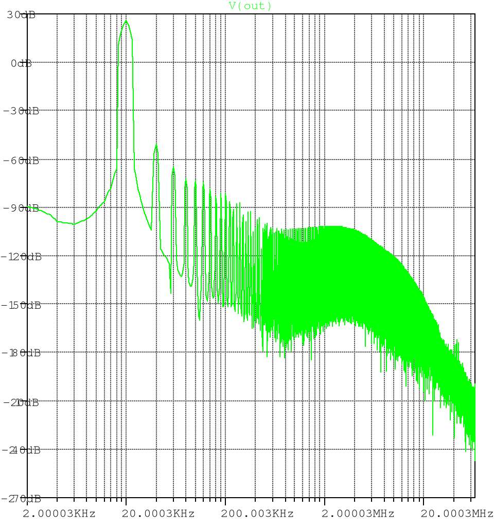

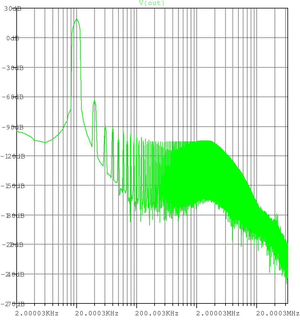

Very interesting is that a simple not optimized current dumping circuit has a harmonics spectrum independent of reactive load and frequency. The harmonics spectrum is poor but
it doesn't depend on the impedance (f) . Since an error feedforward/ feedback combination is difficult to optimize I am going to find out a principal difference of current/voltage feedback and of emitter grounded/ emitter follower power stage.

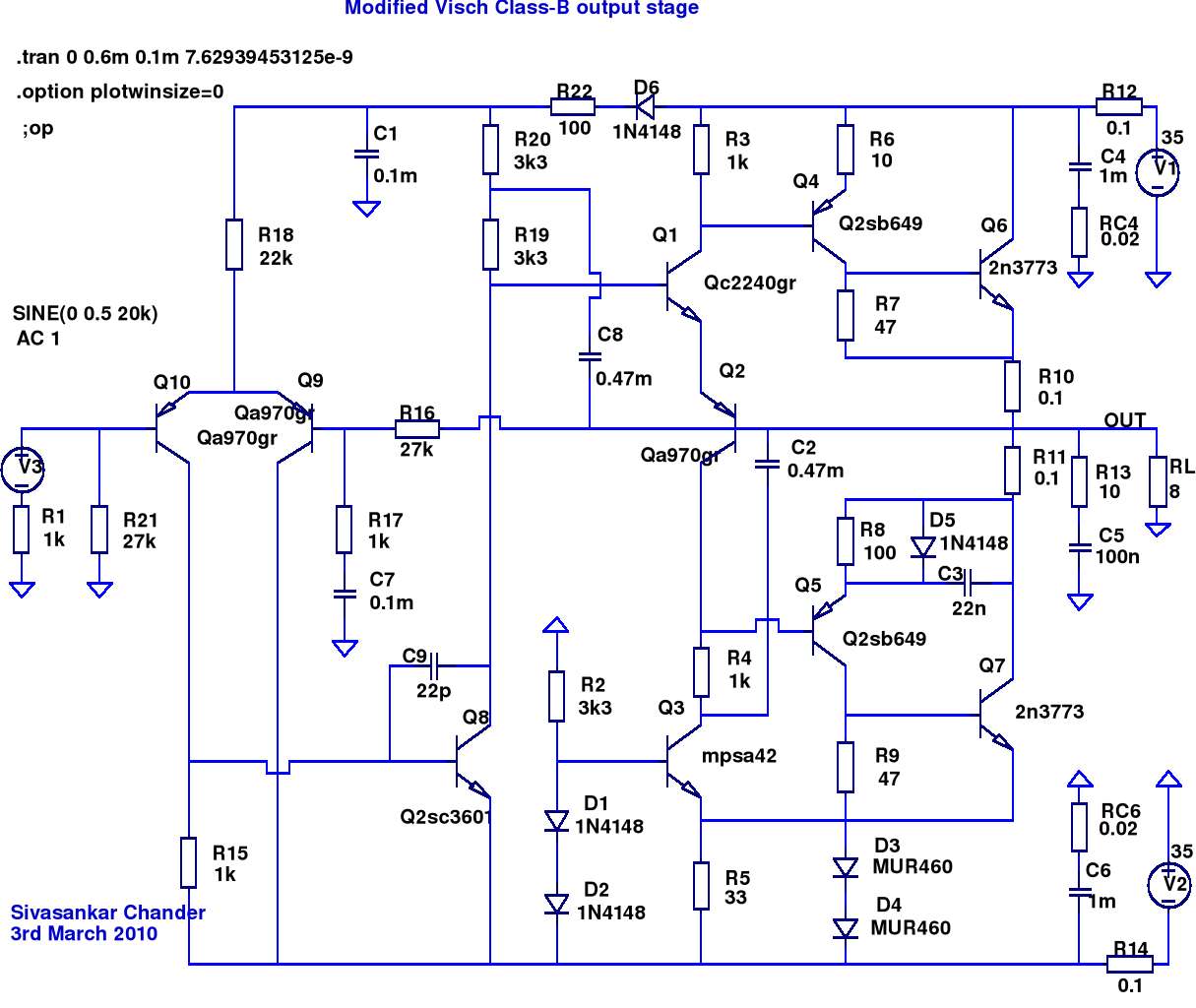

Linear class A crossing Iq would be around 2A. I1 + I2 would total 2A at all times.
More like 4A if we are talking about a 4ohm load. Yours was designed for 4 was it?
So what is Iq 600mA? I don't think of that as true Class A. But also never goes B.
Maybe Hyperbolic A is my class? I'm not sure what effect that has upon stability?

Does non-linearity prevent my sim from misbehaving into reactive loads?
The phase margin is not so good, I wasn't expecting a favorable result.
So I am a little surprised to find it was tolerant of such abuse. Such
margins are computed only for small signals in the quiescent state???

Some results : amongst tested in sim the common emitter QUAD triple cascade clearly outperforms the simpler emitter follower cascade in terms of damping however SPICE cannot perform a reliable frequency analysis of damping.
Very amazingly I found that a error forward topology when optimized for thd is extremely poor in damping BUT depending on error takeoff it can be optimized for damping.

Concluding remark on Vish:
the Vish topology provides a wonderfully descending , even fine-tuneable, spectrum of harmonics- as long as it doesn't drive complex loads and as long one doesn't demand too much power. Given this conditions it sounds better than any class A I have listened to.
Its Achilles heel is the "lower" transistor of the Rush, in combination with voltage feedback.
The sensitivity to complex loads can be avoided to some degree by adding emitter resistors and taking feedback from these.
But his does not help very much. Once the Vcb of the lower Rush drops to zero the transistor gets saturated and all distortion is produced from this effect as its gain drops to 1. With much faster power transistors than the single-diffused 2N3055 the amp then gets stuck to a rail and does not recover i.e.keeps latched up. This happens always at drive input above 25 Volts p in order to get 39 Watts into 8 Ohms even if the amp is redesigned to drive mainly inductive loads.
It is a pity because in most cases one has power in terms of milliwatts to a few watts and then this amp is unbeatable in sonic quality.
But in real programs one has to consider dynamic headroom of up to 70 dB and unfortunately this amp cannot handle this dynamic.
It can also not handle crest factors of about 2 present on direct cut LPs.
So alas.... not suitable as an amp for active speakers.
I chose a slightly modified version of the QUAD 303 triple cascade which features also a
Rush cascode but with current feedback to the emitters.
This has bey far not he wonderful spectrum of harmonics but is very standfast against overdrive and is very tolerant versus reactive loads.

Which is the exact circuit that you built (I saw many simulated by Elvee)?
Do you think that it can be biased entirely in class A?
PS: if you like it so much, you could think to build more efficient speakers
I made a couple of modifications so I will post the last version later. However what could one do with an amp that latches up before it clips? You got to have a bipolar dc detector
that cuts off the speaker and the power supply in case of latch-up.
No it is class B but the power devices are never cut off the minimum iq of about 10 mA is perfectly maintained in the device which were not conducting in class B. I think the perfect harmonics spectrum cannot be easily achieved with a complimentary class A.

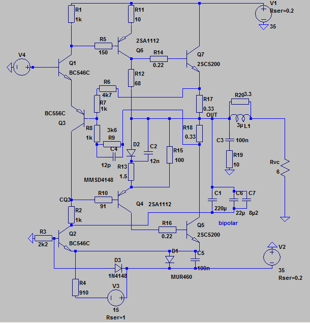

The last word on Vish topology
Attached final schematic. Resistors R5 thru R10, R13,R15 C2 are for fine tuning the harmonics spectrum. A truly wonderful descending spectrum was achieved.
Resistors R 6 throu R9, C4, R17, R18 reduce the sensitivity to reactive load.
Power is limited by Vce of Q3 to about 25 Watts into 6 ohms. More power can only be achieved with lower load impedances.
With the rather fast transistors the amp tends to latch up before it clips. The latching appears when Vcb of Q3 drops to zero. It can most possibly be avoided with slower
transistors for ex. instead of 2SC5200 the epibase BD249C. This however won't help
if Q4 and Q6 are about ft=20 mHz ( the 2SA1112 is specified ft=200 mHz) but such types are rare in combination with high hfe ( 200 up).
This amp calls for engineering because its sonic quality is superb this is due to the harmonics spectrum and absence of crossover distortion. I am convinced it outdoes
Hiraga class A - and it is class B! the quiescent current is very stable at 15 mA.
It is also dynamically constant this may be a key as the same thermal conditions apply to the junctions of BJTs of class A amps.
Some hints: Q1 Q2 Q3 must NOT be in thermal contact with heatsink.
Diode D1 is crucial for fine tuning best choice is a very fast diode with very low
variation of Vd/if . A foil capacitor parallel reduces odd harmonics further.
A Shottky sharply rises odd harmonics.
Capacitors C1 C6 C7 are bipolars paralleled with a foil capacitor - these three devices account for 50% of the devices' total price.
Q5 Q7 R17 R18 L1 R20 are not on PCB R17 R18 are induction free types they come in SOT 220 package and must be mounted on heatsink.
Thus there are no fat currents anywhere flowing on the PCB.
The amp must be driven by a preamp that can deliver up to 25 volts p however the input current is around 200 microamps ac.
I tried some modifications to the Visch Class-B stage in LTSpice.
1) Changed the topology of the upper O/P transistor to emitter-ballasted (a la Naim NAP-140).
2) Changed the topology of the lower O/P transistor to collector-ballasted (a la Naim).
3) Removed the additional negative voltage rail - I kludged it by adding one additional diode drop with a resistor in parallel - it seems to work, but may need further modification.
4) Added Baxendall diode and capacitor to emitter of lower driver, connected to collector of lower O/P transistor.
These changes make it better behaved at high swings (close to clipping), without losing much of its excellent sonics at low swings and crossover. I don't fully understand how either the original circuit or the modified circuit actually works, but it nevertheless does seem to work rather well...
The rest of the circuit is just a minimal LTP and VAS - lots of elaborations can be tried here, but it's pretty good as it is. The THD20 FFT in the middle is at ~14V output amplitude into 8 ohms, while the one on the right is for ~28V amplitude into 8 ohms. In both cases, H2 dominates - exceptionally so at lower amplitudes.
