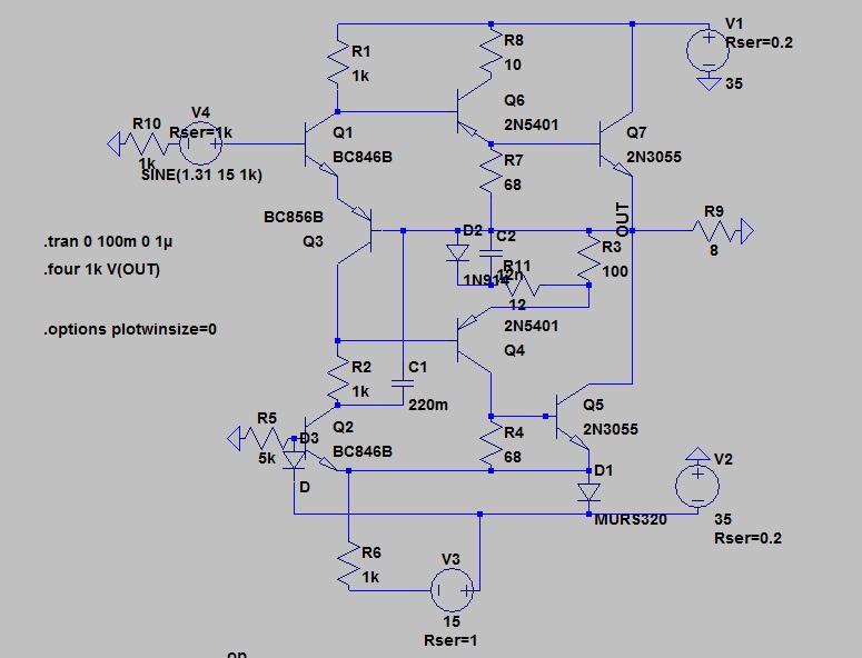

With this clamp already proposed by Hugh the thd is down to 0.3% at 15 v in 1 kHz
It can be reduced further but depends on property of power BJT.
The odd harmonics are one order of magnitude lower than the even. I guess that sounds good.

Yes, generally my experience too. The best profile, according to Jean Hiraga twenty years ago, is the monotonic decreasing profile, where successive harmonic peaks form a straight line down to about -140dB.
BTW, is Q6 in your schemat NPN (it may be an error?)
Hugh
Hahfran,
For Q6 to pass a current into Q7's base, its base must be 0.6V lower than its emitter, not higher, and since the 68R resistor is connected to the emitter of the output device Q7, no base current can flow. If LTSpice is working with this connection, there is a bug.....
I really think Q6 should be a 2N5551 (and in fact I'd change it to a beefier device like a 2SC4793, MJE340 or MJE15030).
To properly simulate the outsized BE junction on Q7, diode D2 might be something capable of 1A. I was never sure about the cap; 12nF seems about right.

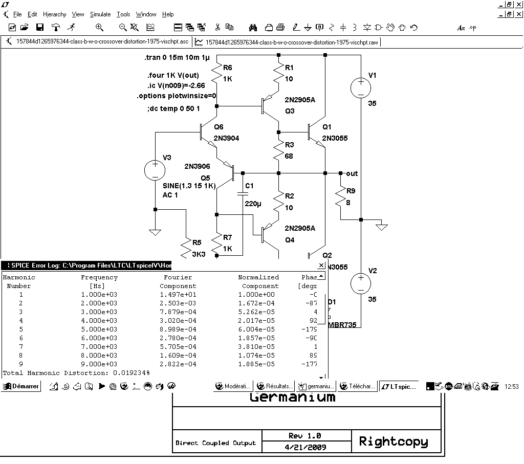

I arrive at a much lower distortion figure under steady state conditions.
But you have to take care that the circuit has effectively reached its steady state before you make the measurement.
What I do is to run the circuit for a very long time (1s) with the intended signal level, and then, I look at final voltage across the cap and include .ic statements forcing that voltage at the next run.
If you rely on a .op, it wont work, because the bias level is dependent on the dynamic operating conditions.
With 15Vpk, the distortion is under 0.02%, almost pure 2nd harmonic.
But the circuit has a sweet spot regarding the source resistance: with 15K at the input, the figure is down to 0.003%.
Note that on your schematic, the cap value is 0.22 farad.
BTW, simulations are no evil, you have to understand what is going on and make sure it follows exactly the path you intend.
They are simply a tool, useful but dumb, and relying too much on default settings may give incoherent results. You have to make yourself the critical decisions.

Q6 cannot be a NPN: this would make the positive half-side inverting, and it would conflict with the non-inverting negative side.
The topology is in fact a circlotron with PNP composites at the output, and the Rush cascode as the phase shifter.

You are right; however, the device is incorrectly drawn because it is inverted; emitter should be to the upper, 10R resistor, while collector should be to the base of the npn output and the 68R.

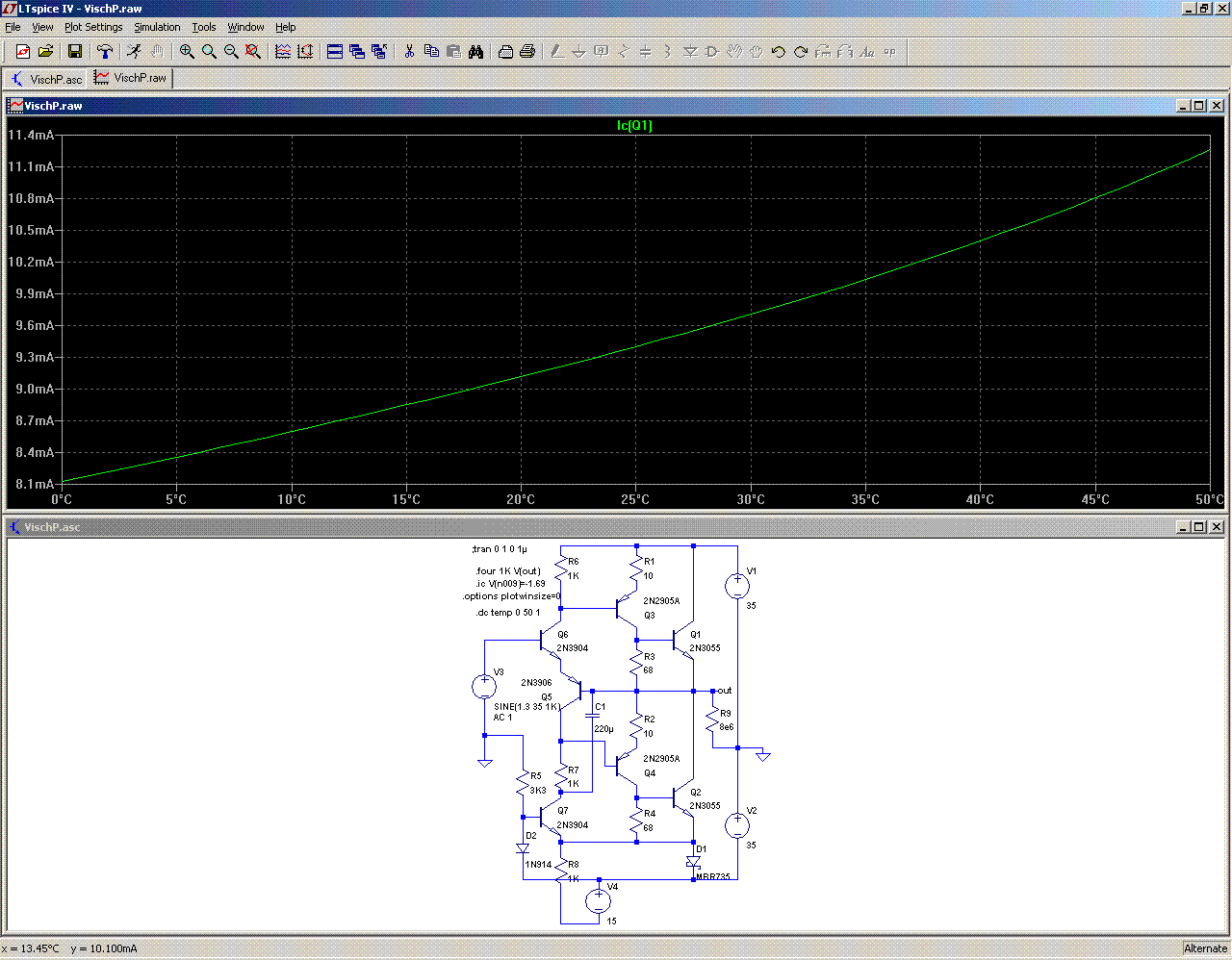

You have to use "temp" as a source for DC sweep simulation: see example

I could not confirm this distortion level. To which schematic does it refer?
Nevertheless it appears the max output for about 1% thd is limited to about 17 volts. The QUAD 303 triple cascade goes as far 25 V and appears to show no switching, too.

You can use this one without any modification: the .ic is OK for 15V.

Ok. Thanx for your help. I see now why we disagree...I do pencil and paper and assume hence the amp is powered on ...LTSpice doesn't. To simulate one has to start the sine about 1 sec delayed and perform transient analysis "triggered". This doesn't seem to work except with your method of line commands. Apparently the Tdelay parameter applies to DC offset, too. Using your simulation of triggering .tran I find indeed at 20 V a wonderful harmonics spectrum. max out for thd 1% is now a matter of the values of the Baxandall clamp and to a lesser extend the value of the cap. For large signal performance analysis LTSpice doesn't care about transistor models.
Ok. Up to 23 V input the harmonics spectrum remains simply nice... at 25 V thd is 0.154239% but 3rd h is higher than h2.

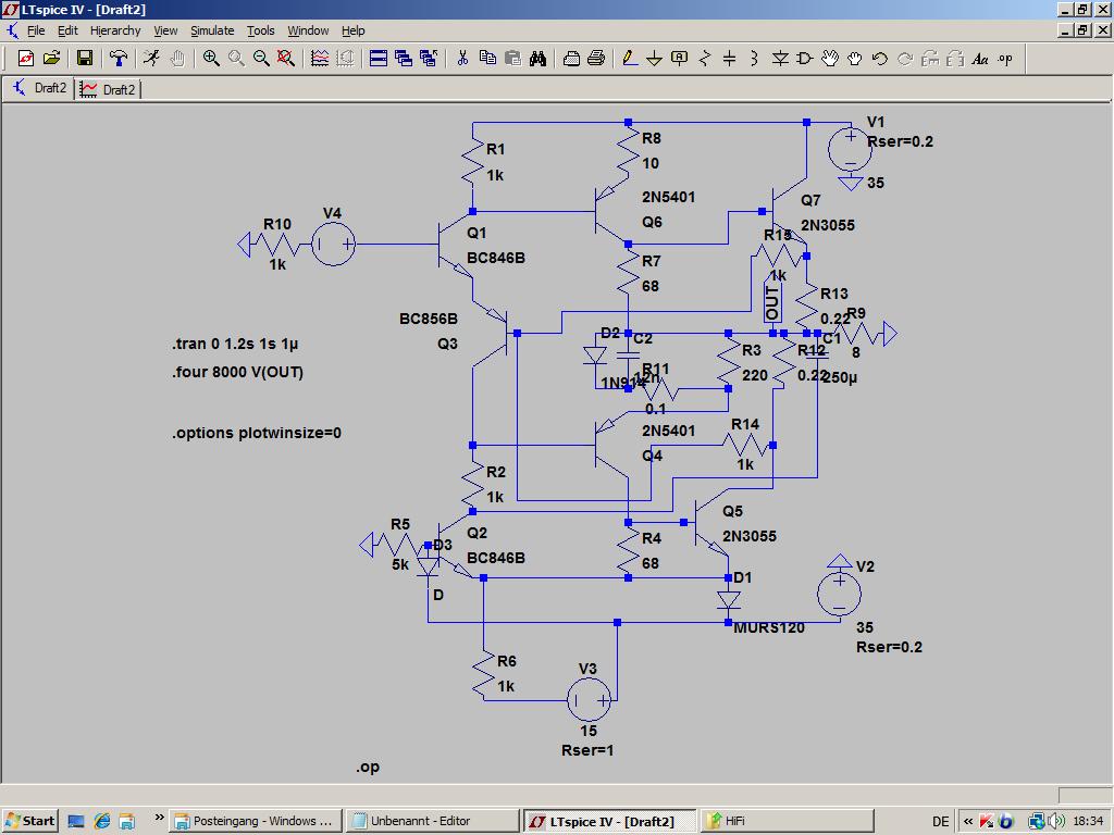

Ok attached the redesigned Vish R12 throu R15 being added, providing some Iq thermal
stability . It can be demonstrated in the sim by adding current sources to simulate increased Iq. Also extending R14 R15 with a parallel RC compensation is possible if necessary. Using 2SC2922 for Q5,Q7 gives a sufficient SOAR margin.

Thermal stability is not an issue: under no signal conditions, Iq is about 10mA (see #113 above), and doesn't vary much with temperature.
The current increases to over 2A under large signal conditions, but this is a "feature" of the circuit, and has nothing to do with temperature.
It is a sort of "sliding class" amplifier, but the reaction delay makes it awkward.
