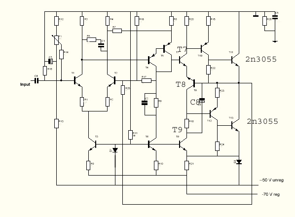

I have recovered the schematics from the only document that made it through all those years, the PCB layout, however that has no component values except that the power BJTs are 2N3055. The circuit that prevents reverse-biasing is the current source T9 and the circuit T7,T8. Thus the NFB
hasn't to handle large voltage steps. I tested the crossover distortion with a dual channel scope in Channel I - Channel II mode ( output - inverted input, different sensitivity) which isn't accurate. However below 30 watts in 4 ohms, no crossover distortion is seen. That is not bad.
It could be interesting to combine this class B in a current dumping topology.
Here is the schematic

Ah..getting closer to the source. Or not...frankly I don't get it how it works, how it is class B, and what is the large 250 capacitor for? It is apparent why and how this topology provides an almost junction-temp independent setting.
This explains why it still works after more than 30 years. But not how it prevents crossover distortion...

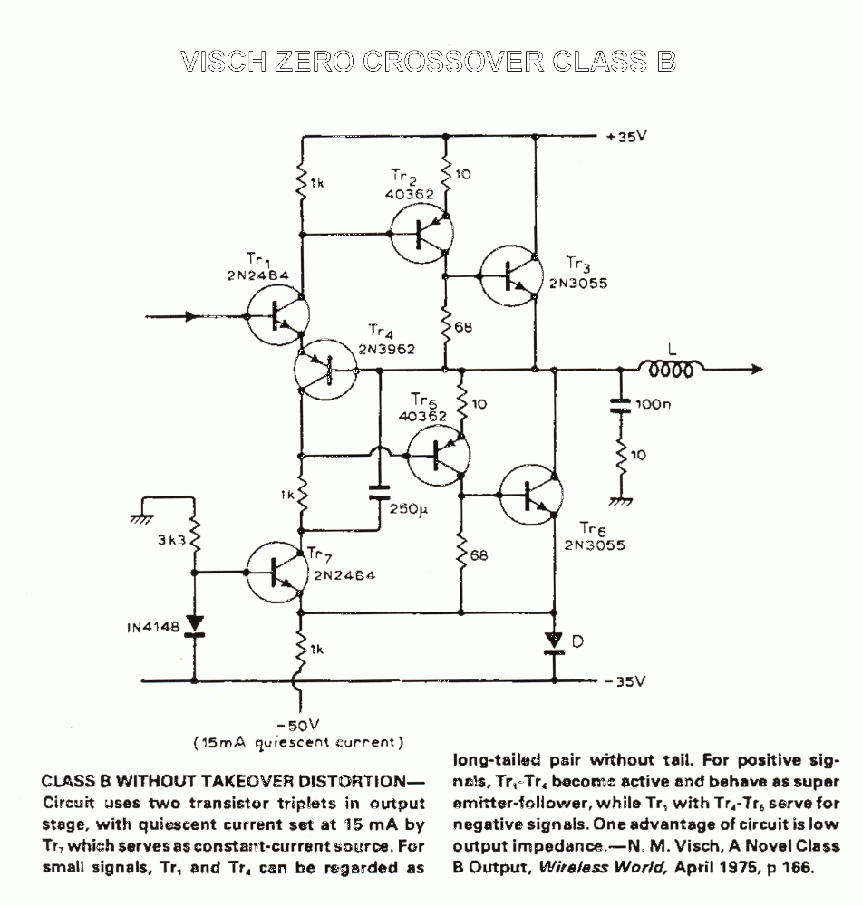

Hahfran,
If you do the simulation you see that neither of the input transistors (with emitters joined) ever turns off. Thus, remaining biased on, there is a relatively simple step function (1.3V) between input and output at all points on the waveform.
Their collectors, one on the top triplet, the other on the bottom triplet, will then behave in a way which always maintains dc 1.3V between input and output, and this implies that their collector voltage will always control the triplets to ensure that the transfer function of the output triplets is neatly pasted over at the crossover point.
I'm not sure Anatoliy is correct; the 250uF is a bootstrap, not a miller cap (no gain).
Clever circuit, huh?
Hugh
Ah yes indeed that explains how no crossover distortion appears even with class B setting of the power BJTs. It appears the same design idea is realized in the old QUAD 303? But why the bootstrap? And indeed the emitter of the current source is forced to -34.4 volts same as the base. If I hadn't built in 1976 I were sure it cannot work but since I have I see it works...

The purpose of the bootstrap around the 250uF cap is to maintain a near constant current through T1, T4 and T7. Upon the constancy of this current depends the consistent 1.3 volts drop between input and output, and hence the linearity. The bootstrap cap strongly defines the voltage at the collectors of T4 and T7, which would prevent collector of T7 going too low as it draws current from T5 on negative swings, otherwise cutting out the transistor.
The disadvantage of this circuit is the additional negative supply for the emitter of T7, which sets the quiescent. Manufacturers hate additional supplies; they really louse up the costs.

The Visch circuit can be improved with a Baxandall diode, cap and resistor all in parallel between emitter of the pnp driver and output rail; distortion is reduced from 0.0077% to about 0.005% according to the sim at 1KHz +20dBU output (14.5Vp). But you'd have to build it to find out how it sounds, of course.

I had solved that problem with a voltage doubling extra rectifier 2 diodes 2 caps. Voltage regulation improved the sound quality.
