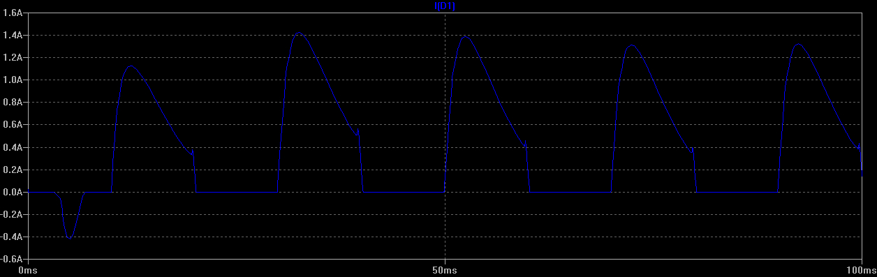

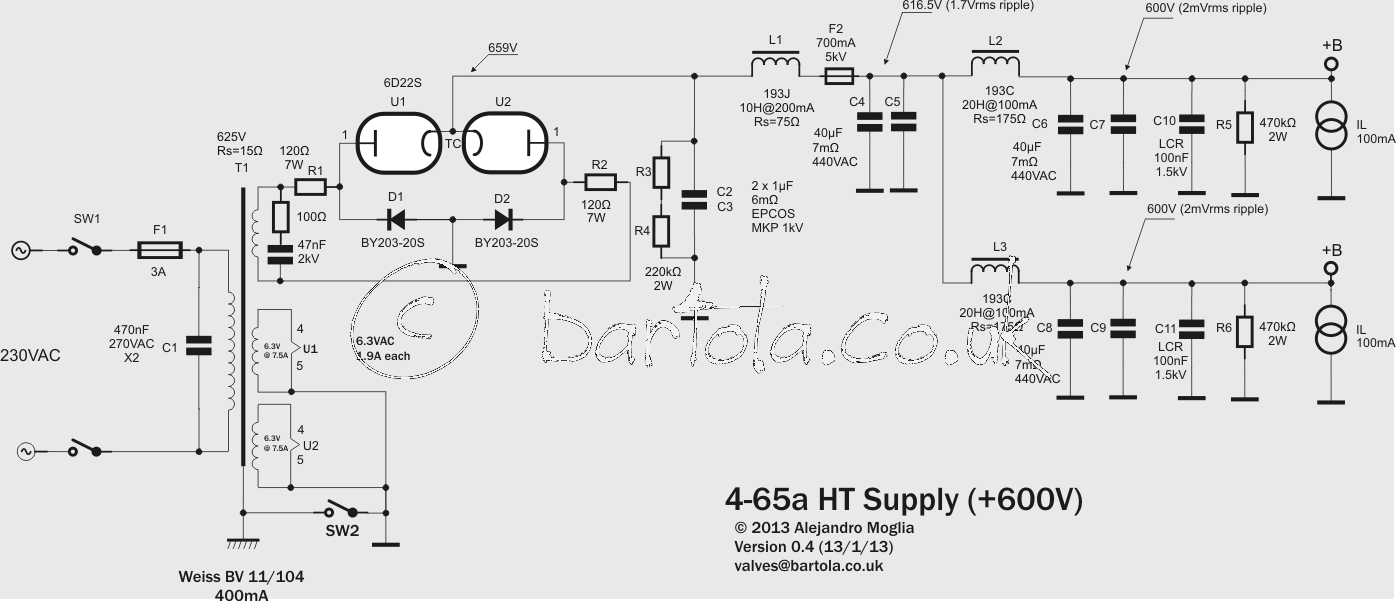

Tested today my 600V raw supply as per diagram below:
With a VARIAC everything works fine. Now, when applying Mains directly to the supply, I blew up one of the damping resistors R1 as well as shorted D1. Before doing any further tests, do you think I need adding an NTC in the primary to limit the in-rush current?
Also, I know that C1 and C2 in parallel are a bit marginal in terms of the peak voltage that the two caps need to withstand, so far so good but may look at buying a pair extra. They are expensive, though!
Thanks for the steer
Ale

I don't believe that the 6d22s should be causing any trouble for you. I've used them in a full wave 1250v supply for stereo 845 outputs. The only thing you need to watch out for with them, is internal arcing. They're cheap, so I bought a batch of them, and had to swap out a couple until they did not arc on startup. It seems that once they are run in for a few hours, they should be fine for the long-haul. Also note that you might want to try tying the 6d22s heaters to B+ (their own cathode), but then I believe you must have separate heater windings. As long as you're using the 6d22s, I'd expect that their slow startup means that you don't require the NTC. It looks like a good supply to me. Perhaps try installing a higher power R1?
-MW

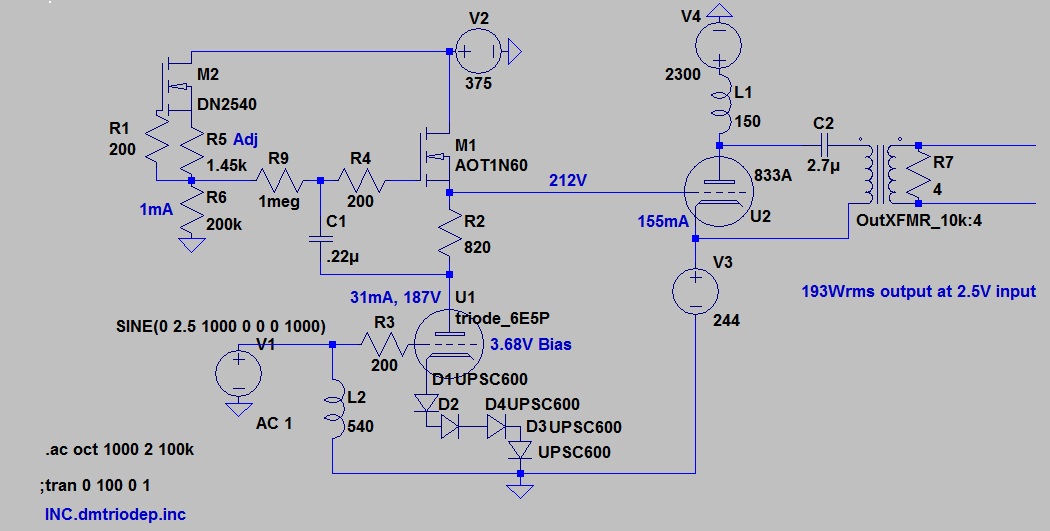

Well, I've decided to take the plunge with an A2 amp, and since I was plunging, I might as well go big.
Here's what I plan to build - a near 200W single-ended triode amp using the 833C tube. The attached schematic sims very well in Spice, with FR from 4.5Hz to ~80KHz, -3dB.

Hi Magz,
Cool! You can also feed M2 from V3, a much more stable source and also will dissipate less power across M2.
I love the 6e5p. If I get the time I will try to measure the distortion at full swing in that configuration. What is the maximum peak signal you need to drive the output valve?
Ale
I'm exploring several options for the power supplies, so that is open for optimization. I'm thinking SSHV2 for V3 and V2, and perhaps I can take the CCS reference power from V3. Lots of options.

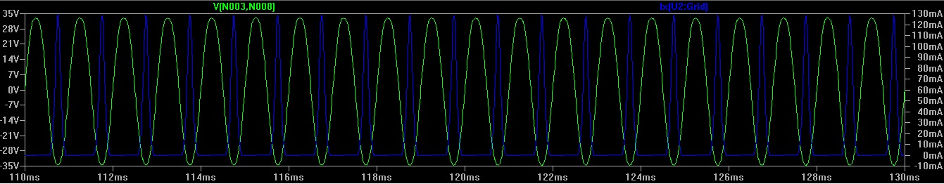

The 833 has a high mu (35!) for a power tube, so its drive requirements aren't bad at all. The 6E5P drives it with no problem; at full power the driver is nowhere near clipping.
The grid choke really made an improvement in the sims in terms of preventing the grid current pulses from getting back into the input. You can sim it versus a 100k resistor and measure the current across each - with the resistor there are clearly current pulses present (and current across a resistor = voltage you don't want there).
Also, the SiC schottky diodes I'm using for 6E5P bias have very low dynamic resistance - I measured it at 1.3 ohms per diode between 15 and 30mA, so that's only 5.2ohms for the string of four, or about half of one red LED.
Hi Magz,
Have a look at the original design from Michael and my design here:
Your V3 (v4 in mine) needs to be as stable as possible. SSHV2 is good, that is what I'm using. V2 (V5 in mine) on the other hand only needs to provide A2 grid current so can be unregulated if the return is the cathode of the output valve.
I wil do the simulations, good tips. However, be aware that the SPICE models are far from being accurate in modelling A2 grid current, so distortion will be probably bigger. You don't want to run the driver with grid current as probably your source will not be prepared for that..
Haven't tried SiC diodes, keen to see how these sound as well, they look perfect candidates!

Mogliaa,
It looks to me like your V5 is also providing part of the anode current for the driver tube, in conjunction with the PS stacked below it. In any case, the MOSFETs have high PSRR so the supply may be able to be a little rougher than usual. I'll probably regulate both supplies anyway.
